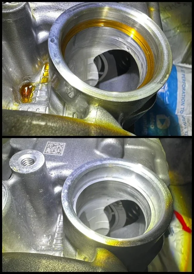

I DIYed the oil pump job few weeks ago.
Sharing the part numbers, since Toyota said they were backordered for months.
BMW had them readily available.
I made a pretty in depth DIY tutorial on my YouTube channel showing how I did the job.
Appreciated the vid! I followed through it, with no issues.
Part#ToyotaBMW
ZTK Oil pump (full metal upgrade)115100-WAA0311419895359
oil strainer115104-WAA0111417643047
oil pump bolts490069-3109011418612615
dowl pins290069-3500311121726238
oil pump gear bolt190069-3204911417823426
oil pan sealant183190-40451-783190404517 (Loctite 5970)
Sealant gun1(in video)
subframe bolts290118-wa21531106850312
290118-WA41707146883436
290118-WA21631106872063
290118-WA21431106797640
suspension arm bolts490118-wa20133326768884
490118-wa20231306798572
290118-wa19831106767496
290118-wa41637146882859
290118-WA19933306787062
290118-WA243
lower stiffening plate bolts1290118-WA81833306772888
