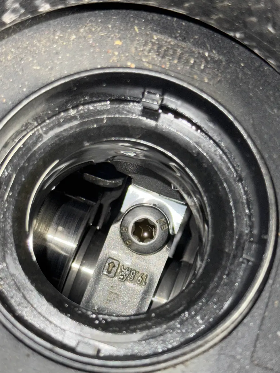

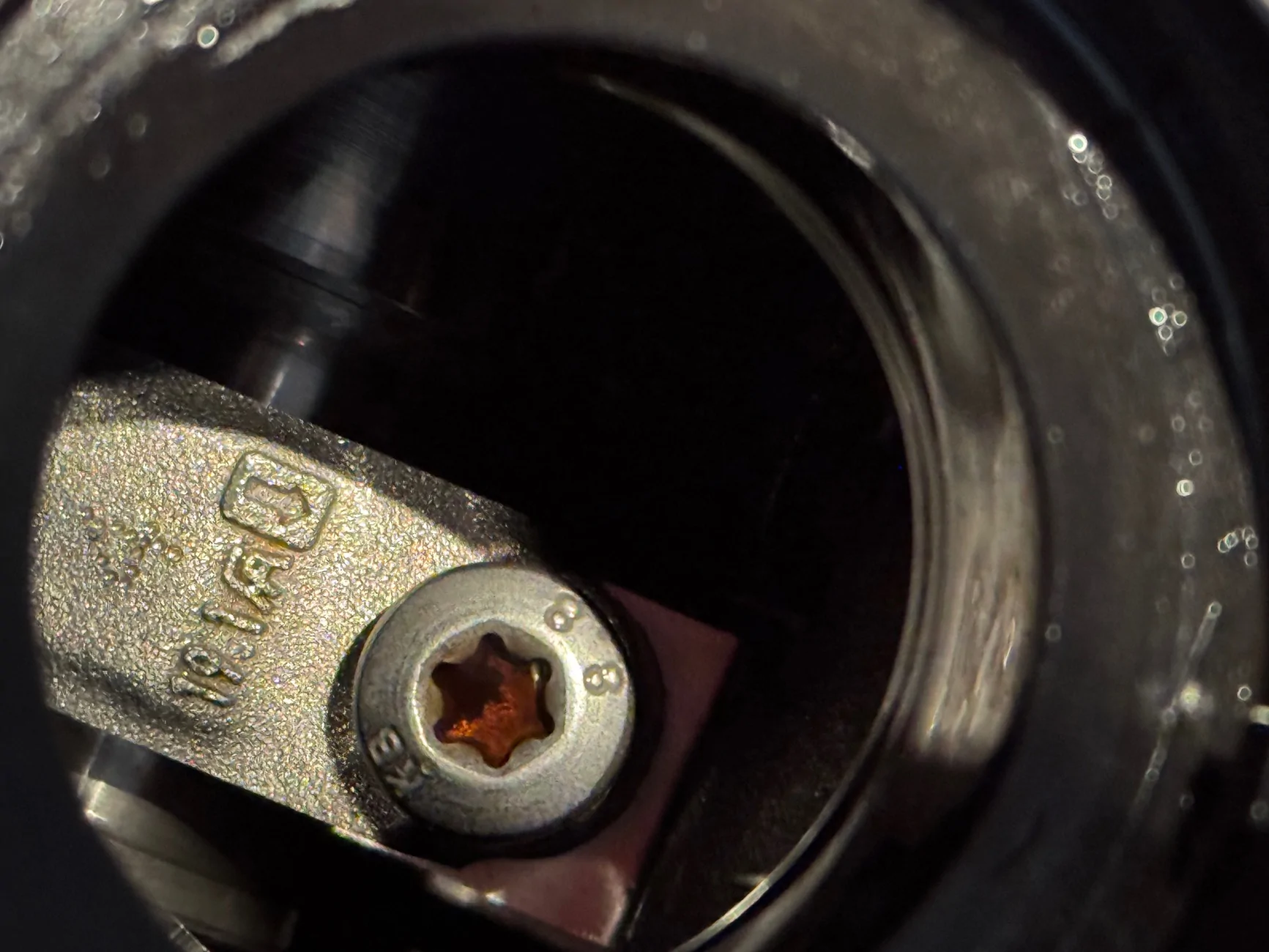

So from what I've seen, there's a quick way to check what oil pump you have. This is based off owners in SoCal that have had failed pumps replaced with newer revised ones at the dealership. The pump seems to fail regardless of what oil weight your'e using, even olive oil.
Remove the oil fill cap, look directly inside the oil filler. If the silver bolt has 8.8 stamped on it, then you have the fuel pump that is known to fail and require replacement.
If it says 10.9, you have the updated, revised oil pump that have not been causing issues for 2020 and 2021 models.

Eastwood is old. Give him a break. He meant oil pump for sure.
also, I’m still not sure about the whole bolt thing. I personally feel that it’s more of a 2 port vs 6 port thing. I need to see evidence of an early 6 port with those bolts, which I haven’t seen yet.
From what I’ve seen, every failing oil pump I’ve seen on our discord and Reddit always have the 8.8 bolt. Seems like enough of a tell sign. Although I don’t recall seeing anyone with a 2021/6 port with that issue. Maybe some early 21s but I don’t recall.
Edit: everyone that gets it replaced with the revised pump has the 10.9 bolt.
that’s exactly what I mean. Someone with a super early 21 6 port that has the oil pump problem needs to post up and verify if they have the bolts or not. Mine is a 01-21 build, I have the new bolts and no issues. Do any 6 ports really have the old bolts?

I did not check, but I assume that bolt wouldn't change correct? I do want to say though I have seen somewhere in Reddit that the bolt is also not generally a 100% sure way to tell.
Mine is a 7/20 build date, not super early but I will be changing my oil soon so I can check.
please do check. I’m very curious to see. It will help explain things if you do indeed have the old bolts.
