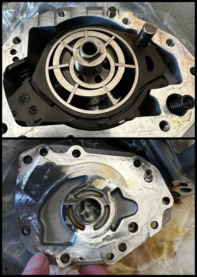

2021, 06/2020, 6port, 10.9 bolts.
My pump starting failing at ~35k miles.
Started with 0w-20, started using 0w-40.
Upgraded to metal pump.
I'd say..... if your build date is 11/2020 or older, just plan to do the pump.

2020 MY z4 m40i. US spec for us only came with 6 port. 10.9 bolts, still had plastic oil pump.
Pump never “failed” but it wouldn’t maintain oil pressure target once it hit certain temps on track. Used 30, 40 and 50 weight oils.

There isn't any specific circumstances that cause the failures with the plastic-insides oil pumps of the earlier B58's. If you can read your oil level just fine (i.e. the i-drive oil level check completes instead of stopping half way) you're safe for now. There is literally nothing you can do to prevent it from happening except replace your pump early if you know yours is one of the plastic ones.
2021 3.0 manufacture date 10/2020, was never able to read oil level when I got the car used at 20k miles, got the oil pump and oil pressure regulation engine codes and CEL at about 28K miles. Replaced by 3rd party shop, no issues since.
