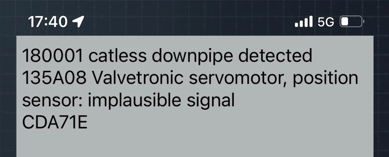

Hey fellas wanted to see if you guys can help me out with a code that popped up. I have the a 2021 with a JB4 + Catless lower Downpipes, been running map 1/2 for about 10 months now no issues. Cars running with no issues, but had this pop up on the JB4 when reading the engine codes.
180001 catless downpipe detected
135A08 Valvetronic servomotor, position
sensor: implausible signal
CDA71E
Anyone else have this come up or know the issue?

Clear the code and see if it comes back. I had the same code appear but it went away after I cleared it. If you have a rough idle when your car is warmed up (car randomly shaking), or you hear a weird tapping noise coming from your car when you first get inside, then you might have a valvetronic problem.

The catless downpipe code is normal since you’re running a catless downpipe. Not sure why it would have taken 10 months to come up.
the other one, albeit it not positive, is there a tone difference between sport mode and normal? The servo that controls your valve could be on its way out or need a cleaning or something
The sports mode burbles and popping noises seem to be more pronounced & my idle is normal. Cars running well all around.
Cleared the codes hopefully it doesn’t come back.

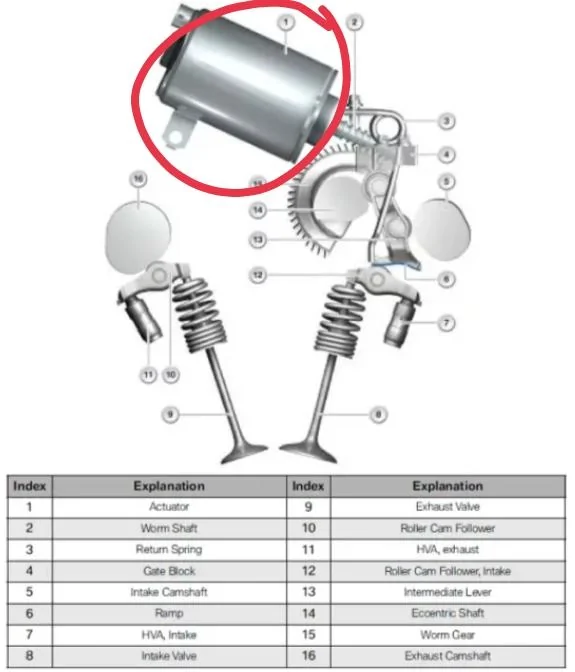

I think this error code is referring to the motor in the cylinder head that controls the intermediate swing cam, not the exhaust flap.
