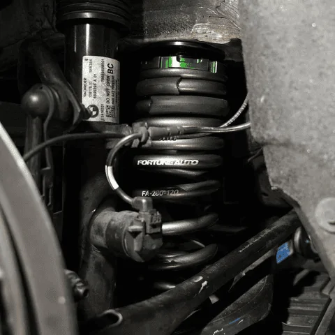

Are these new? I didn't even know they existed. I only knew about HKS and MSS. I bought the MSS since I got a really good deal on them, had great reviews. These are about the same price point as the MSS.

These are new, I just noticed them a few weeks back. They seem like a cross between HKS/MSS in that, they delete the spring perch in the front, but you can adjust the rears without having to drop the control arm like the HKS ones.
Based on Fortune Auto's picture for the rear, it looks like you adjust at the top instead of the bottom

I didn’t even know anything like this existed. Been researching EDC canceller’s as I already have their coilovers but haven’t got to installing them. This seems like a good option.

The MSS are a great option for the same
Price.

Didn't know these existed either, we do mostly MSS and HKS, nice to see another option!

Has anyone tried these? I can’t find much feedback on them but the design seems like a best of both for adjusting the rear and gaining clearance in the front.

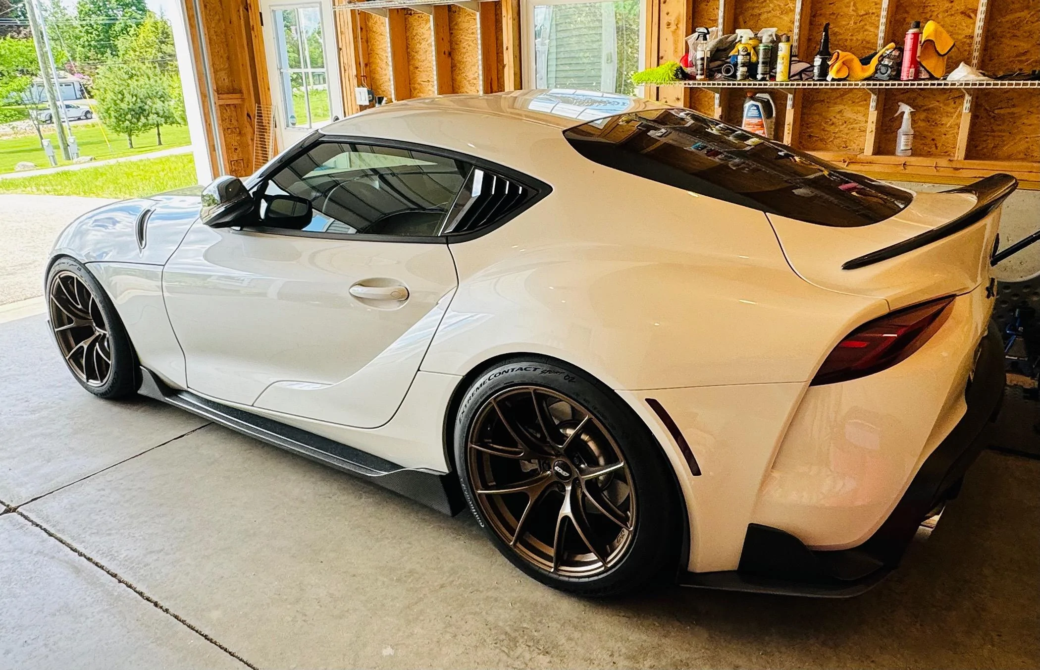

I have them and like them a lot. With these I’m able to keep a minimal drop to clear obstacles with my front splitter. Ride on the street is great and they do surprisingly well on the track combined with swaybars. No noises with them either.

That’s awesome. Do you mind sharing the ride height settings/ other suspension mods and wheel/tires you’re running on track?

Yeah, with me in the car 675mm FL 677 FR 681 RL 679 RR. (fender to ground) 49.9% cross weight with those. In addition to AFE sway bars I have Verus camber plates in the front and poly rear subframe bushings. Track tires are 295/35/18 bridgestone RE71RS square on APEX EC-7RS 18X11.
