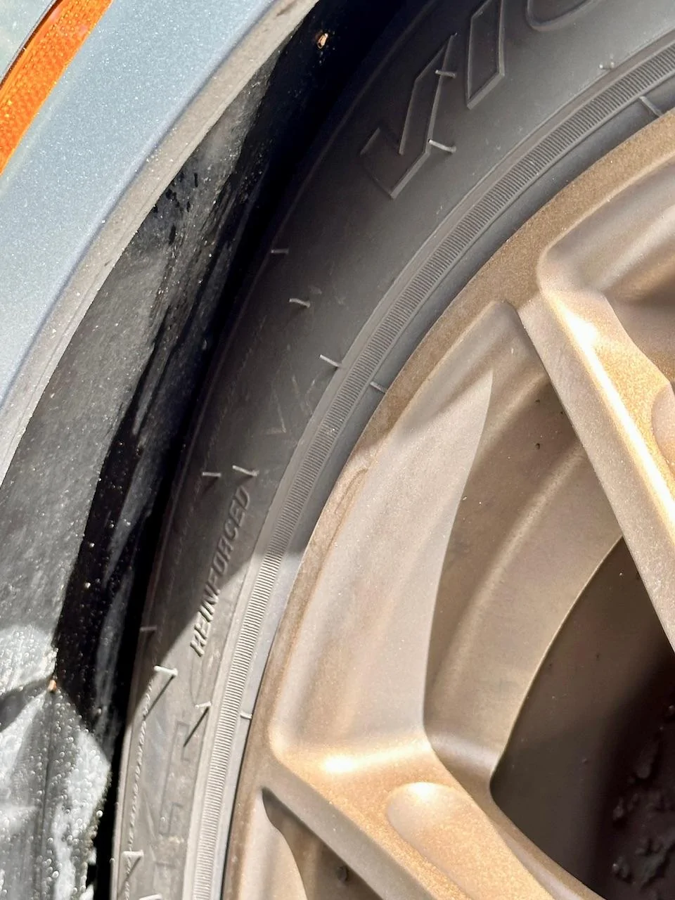

You’ll save money in the long run with 275/35-18s (or 275/40). So many tires choices available = lower pricing for the same tire in other sizes. Also you can rotate them. You are smart enough not to lower the car like I did and won’t have a problem with rub. It’s tight on a full turn, so don’t do that either, ?. It’s funny cuz I was talking to the BMW group yesterday and they couldn’t fathom why I don’t take the wheel well liner out ?
As you can see, they fit. But on a full turn, as pictured, it’s tight. However, up top, I now have room (finger width) for compression during high speed on track. The Ohlins (or stock suspension) will give you that. Ideally I won’t be doing any full turns on track. Thus no excessive rubbing there. It’s all good ??
