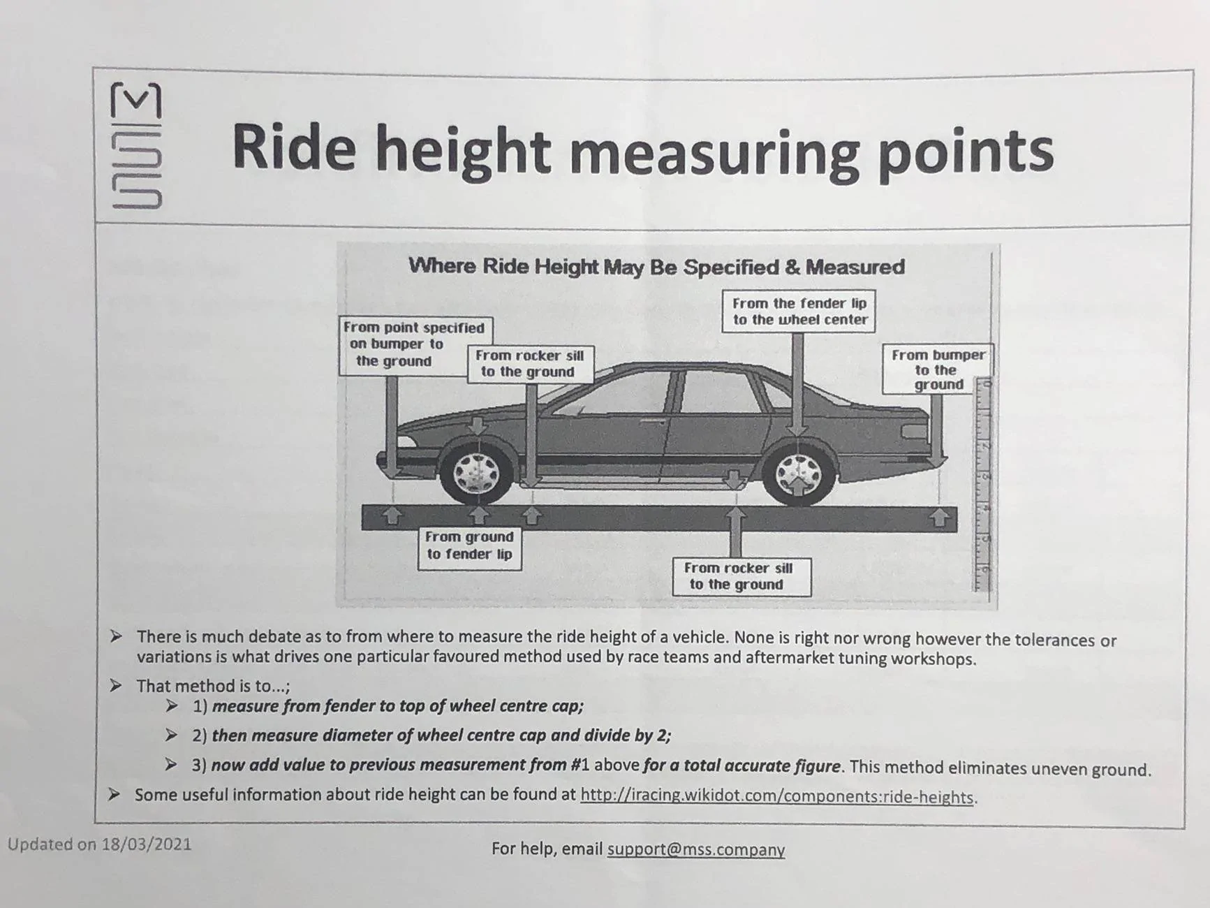

For those that have done the adjustments on the mss - is there a visual on the adjuster that indicates what oem height is? I know a turn is about 3 mm but I want a starting point with oem height - wasn’t sure what the best process was or what do you actually measure to determine the height (if not the wheel well)?
Watched some vids but they only cover install which looks straightforward. I want to have it close and once I run them a bit I’ll take it to get a proper alignment.

no visual on the adjuster.
you'll just have to make multiple adjustments until you're satisfied.
oem height is 14.5"

Place it at highest setting (OEM) and work your way down from there. Is very hard to raise the car.
Buy the optional dust boot covers. The little dust and debris that accumulate on the thread make the adjustment really tough.

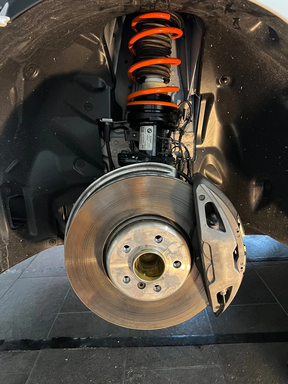

i run MSS springs on the lowest setting. I don’t have any experience with other brands. Ride quality wise- feels stiffer in both modes but still comfy in normal (this is my everyday setting) No rubbing even with 20mm and 17.5mm spacers.
old thread, but I recently got my mss springs installed by a local shop. the springs feel soggier than stock, and I find that they compress so easily when I’m in normal mode… it scrapes when I go over certain parts on the highway and theres a bump in the road for example.
not sure if this is normal.

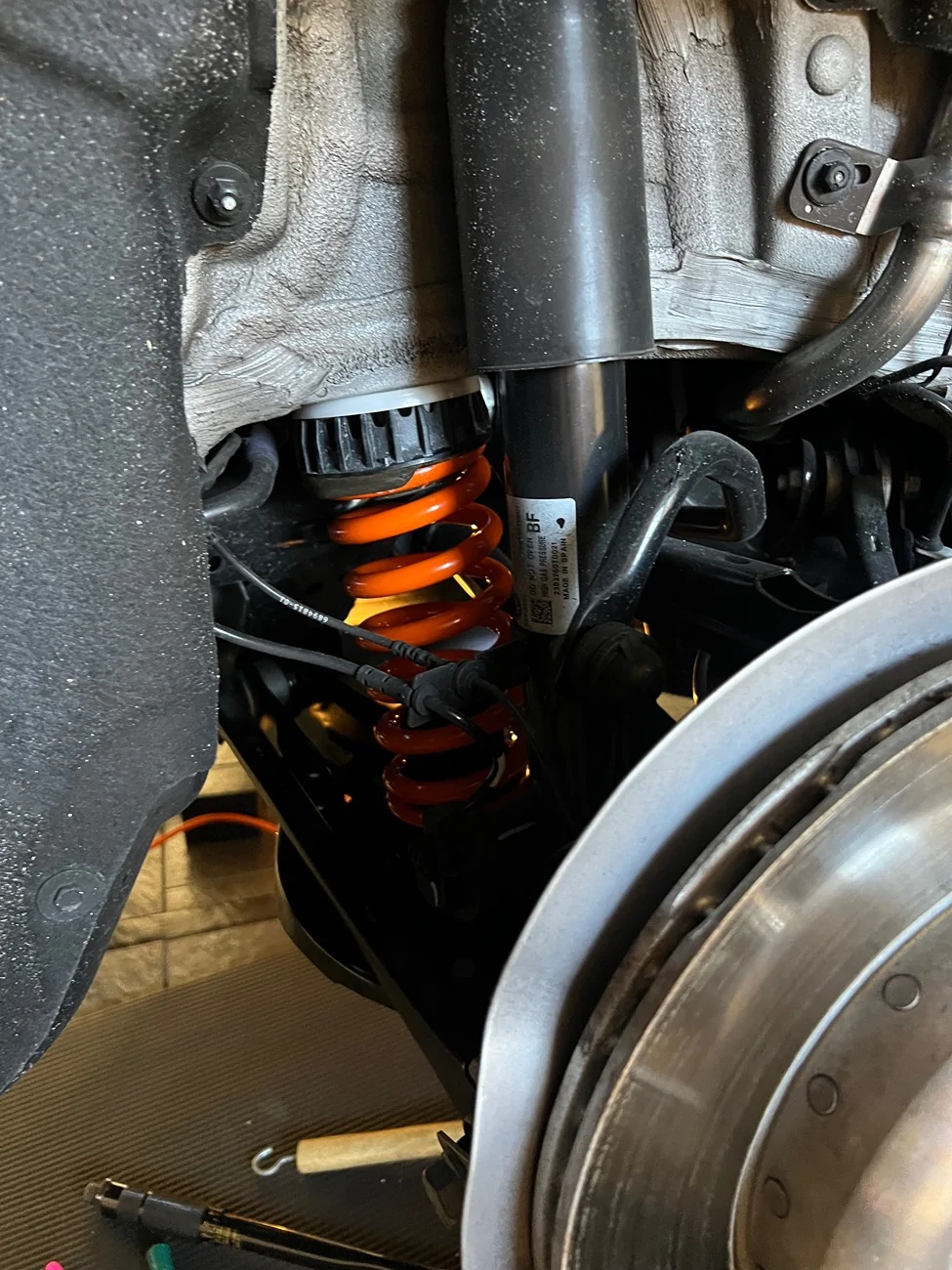

Looking at your picture of the rear spring install. I think I will need to adjust mine, it's not straight like your picture.
Does the whole rear springs assembly need to be removed for this adjustment? Or is there a easier way to rotate it to the correct position?
yes. You have to undo the the whole thing. And it has to be straight. Maybe that’s the problem. Post a pic
