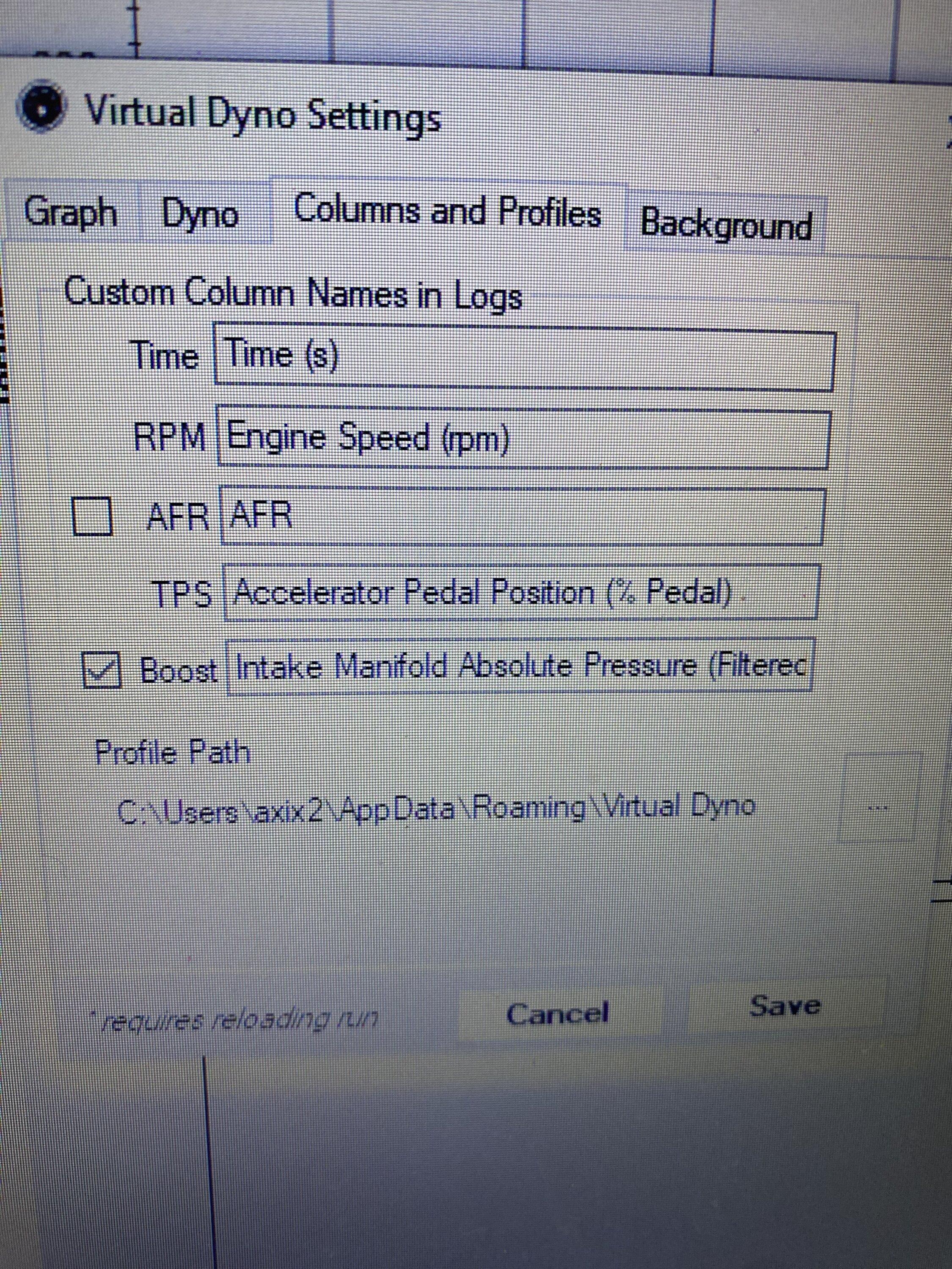

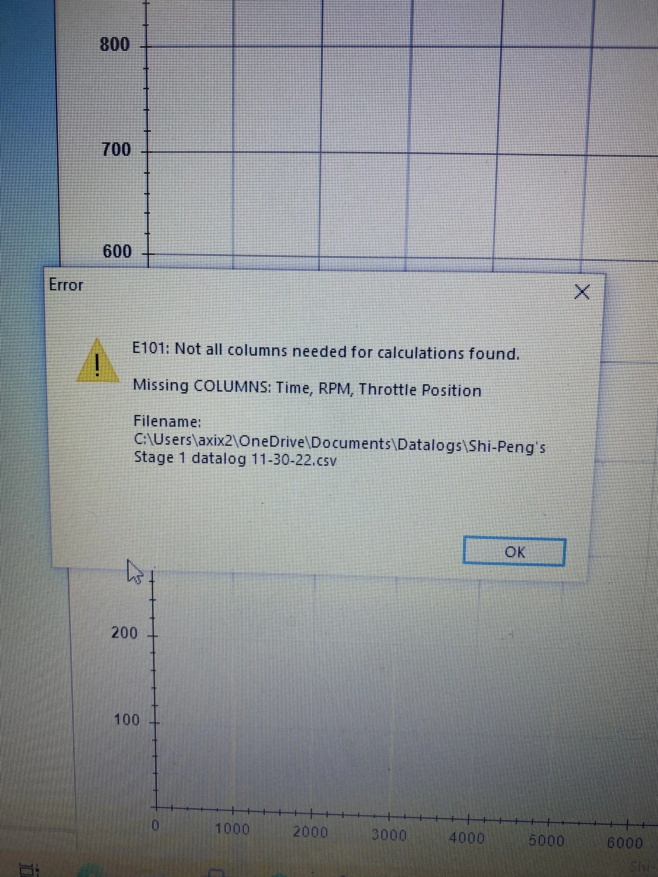

Has anybody ever successfully used the virtual dyno software with Ecutek datalogs to generate some numbers?
I keep gettting this error message every time I try to load datalog into the virtual dyno software. I tried to edit the datalog in the excel but still didn’t work.
Error message:
E101: Not all columns needed for calculations found.
Missing COLUMNS: Time, RPM, Throttle Position
Error message:

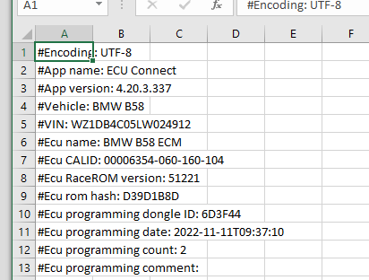

If you have all the info at the top of your log like this
Get rid of that, I get the same thing it will give me the exact same message as you but then once i delete all that info and then save the log, then load it in V-dyno it will then load.

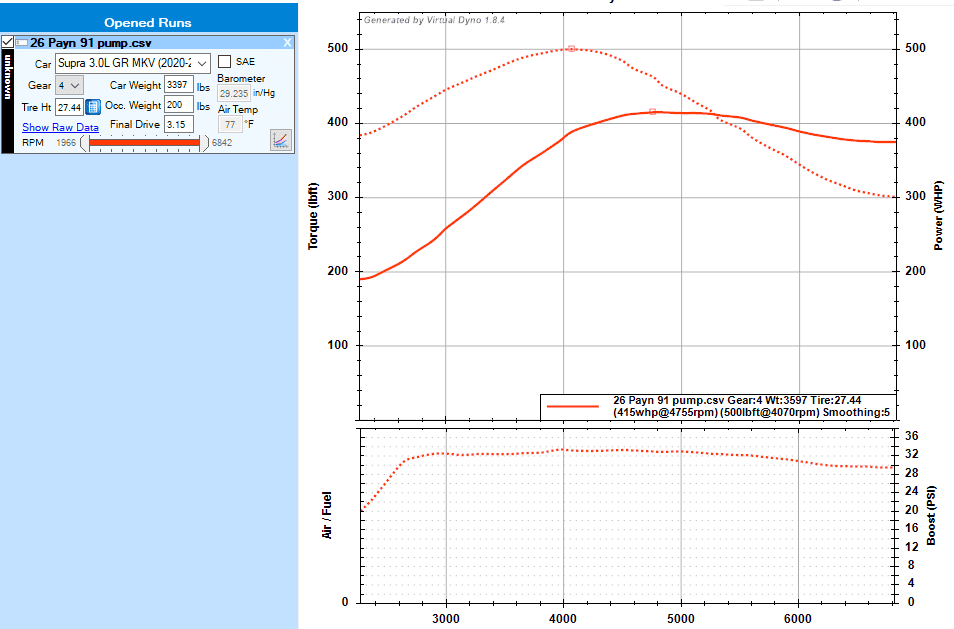

Thanks for evehevodu
I dont log at the same place i did with my Focus St and Mustang GT but both those were extremely close to the actual dynos, i havent had the Supra dyno'd yet and can check if where i log now will give close results.
Thanks for everybody’s help. Deleting the title and veh info did the trick! Thanks!!
