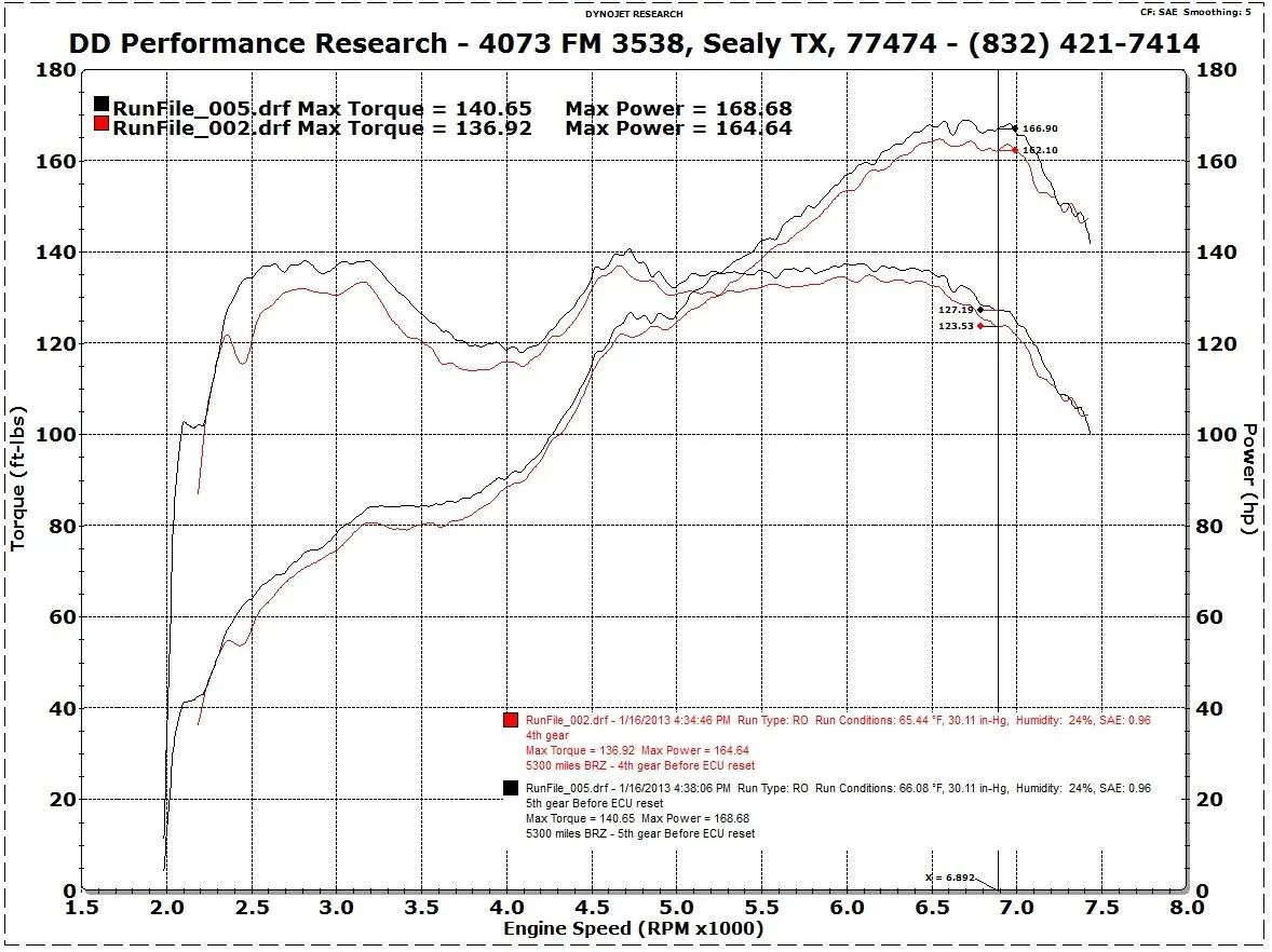

That is exactly my point. 200hp sounds like a healthy motor, like it should be pretty quick. But with only 150lbs/ft claimed at the crank, and 136-140lbs/ft to the wheels, the dyno graph tells the real story...
It only makes 200hp because it manages to make torque at a pretty high RPM. The reality is it accelerates as quickly at 3000rpm as it does at 6000rpm (we won't talk about 4000rpm lol). Again, the HP metric nets false expectations.
That said, I like the 86. If you've ever owned the original car, you wouldn't complain about the performance of the new one. It managed to capture the intent and soul of the original quite well. I just wish it had a Toyota inline 4 (a Beams 3sge swap fixes that).
