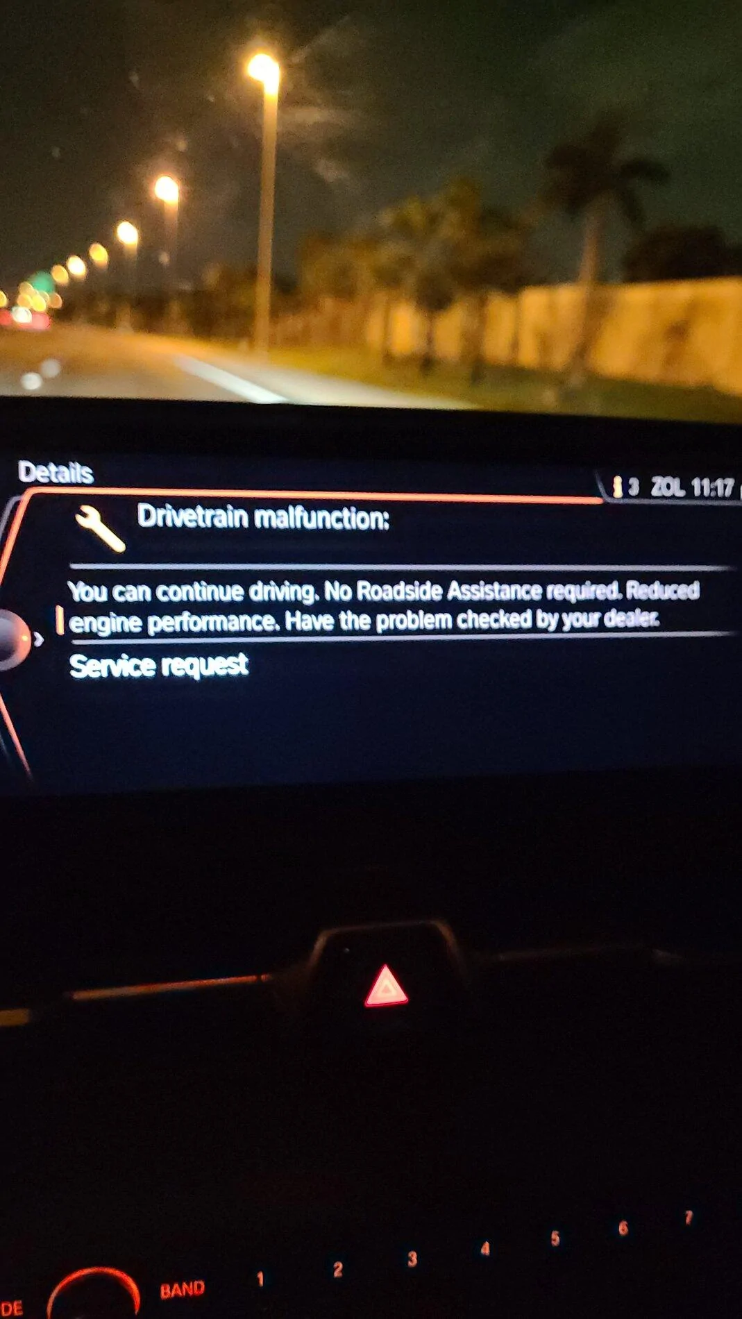

Getting a drivetrain malfunction is very common bmw's. When the shop that installed my springs accidently left a speed sensor unplugged I got one asap, and it wouldn't let me go into sport traction or traction off. It can be a million little things tho, best bet is to get it read by a scanner. Sometimes they just go away after a bit. These cars are very sensitive but a lot of the times it just nothing, or very minor things.

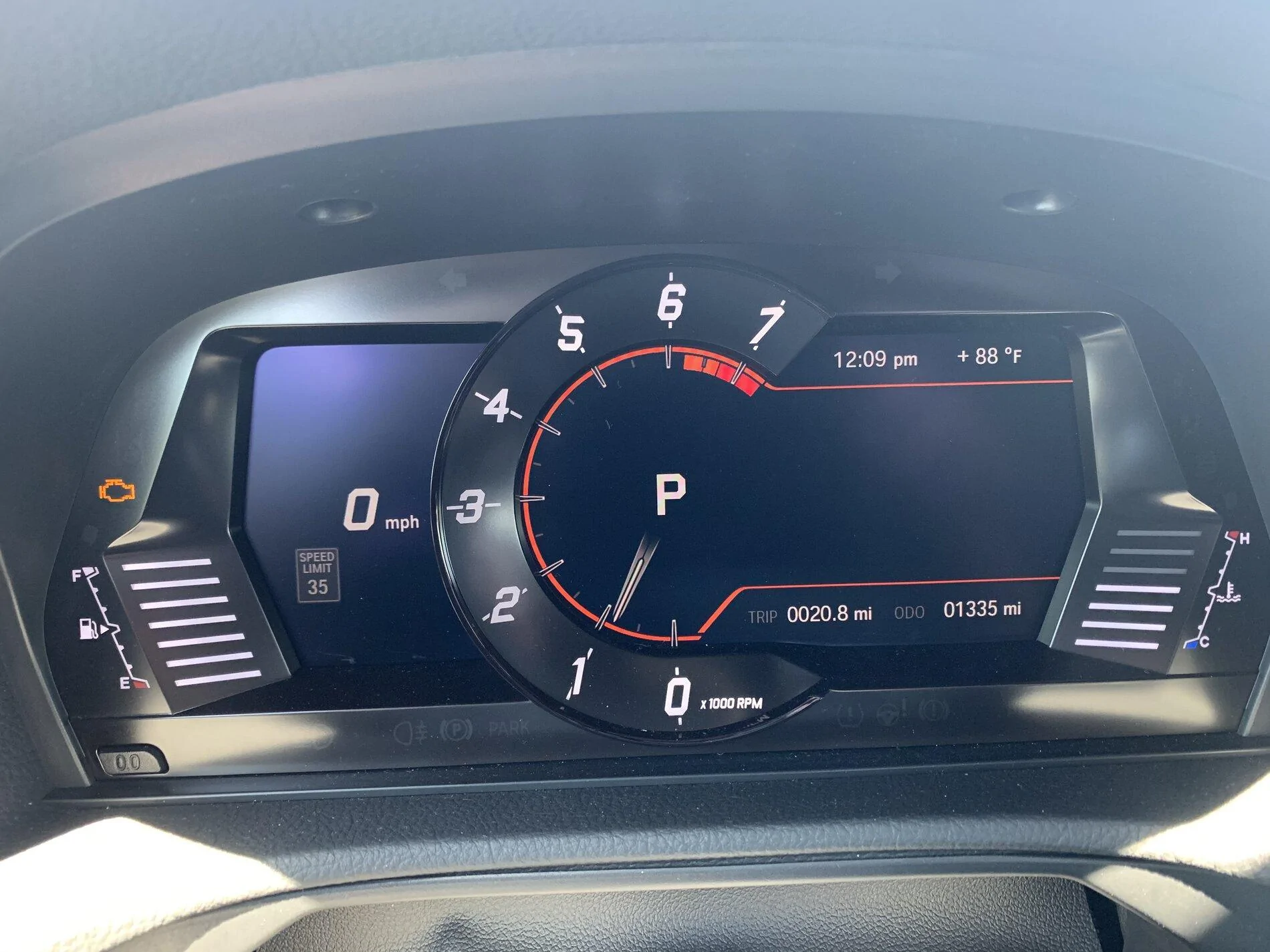

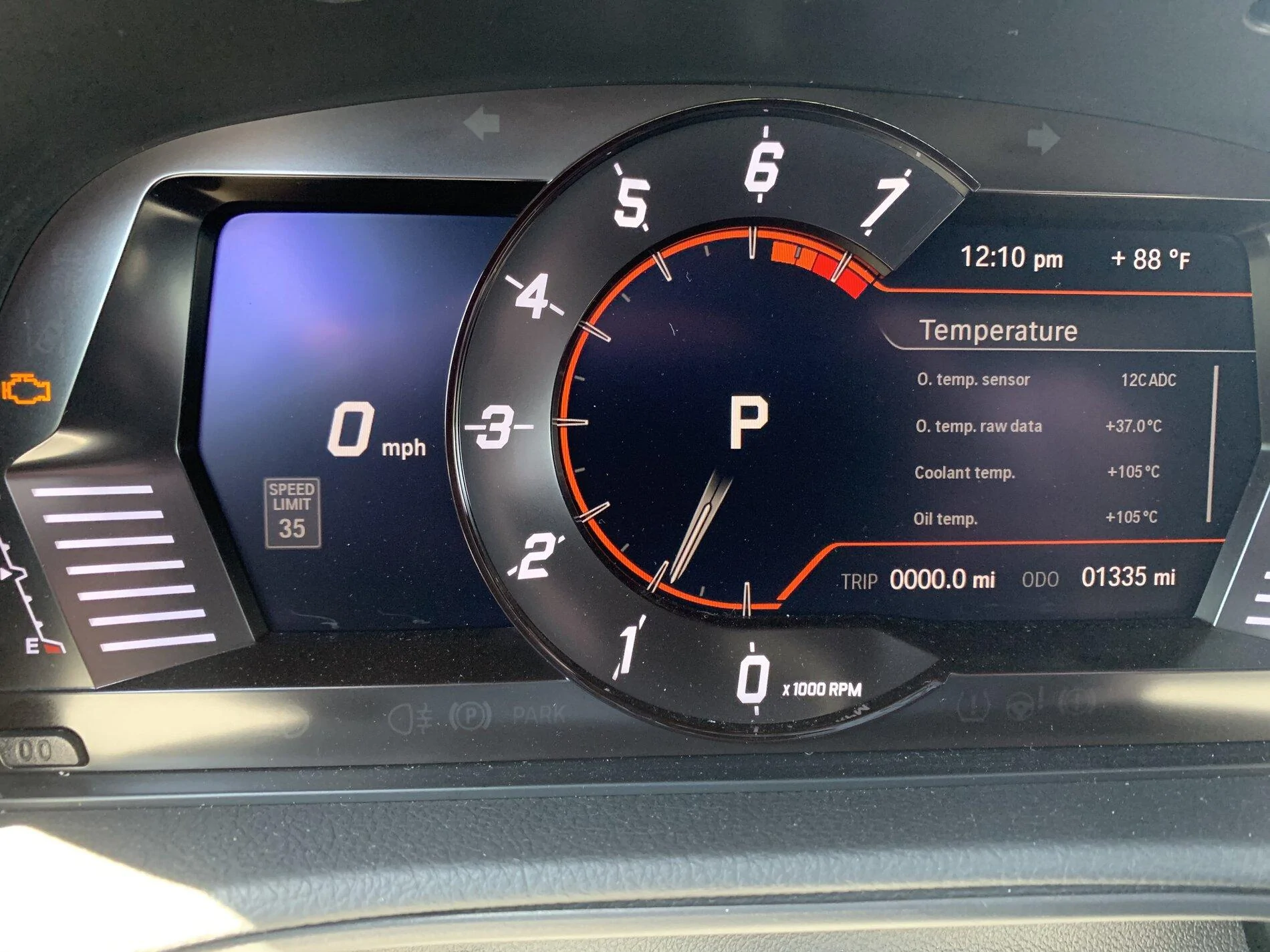

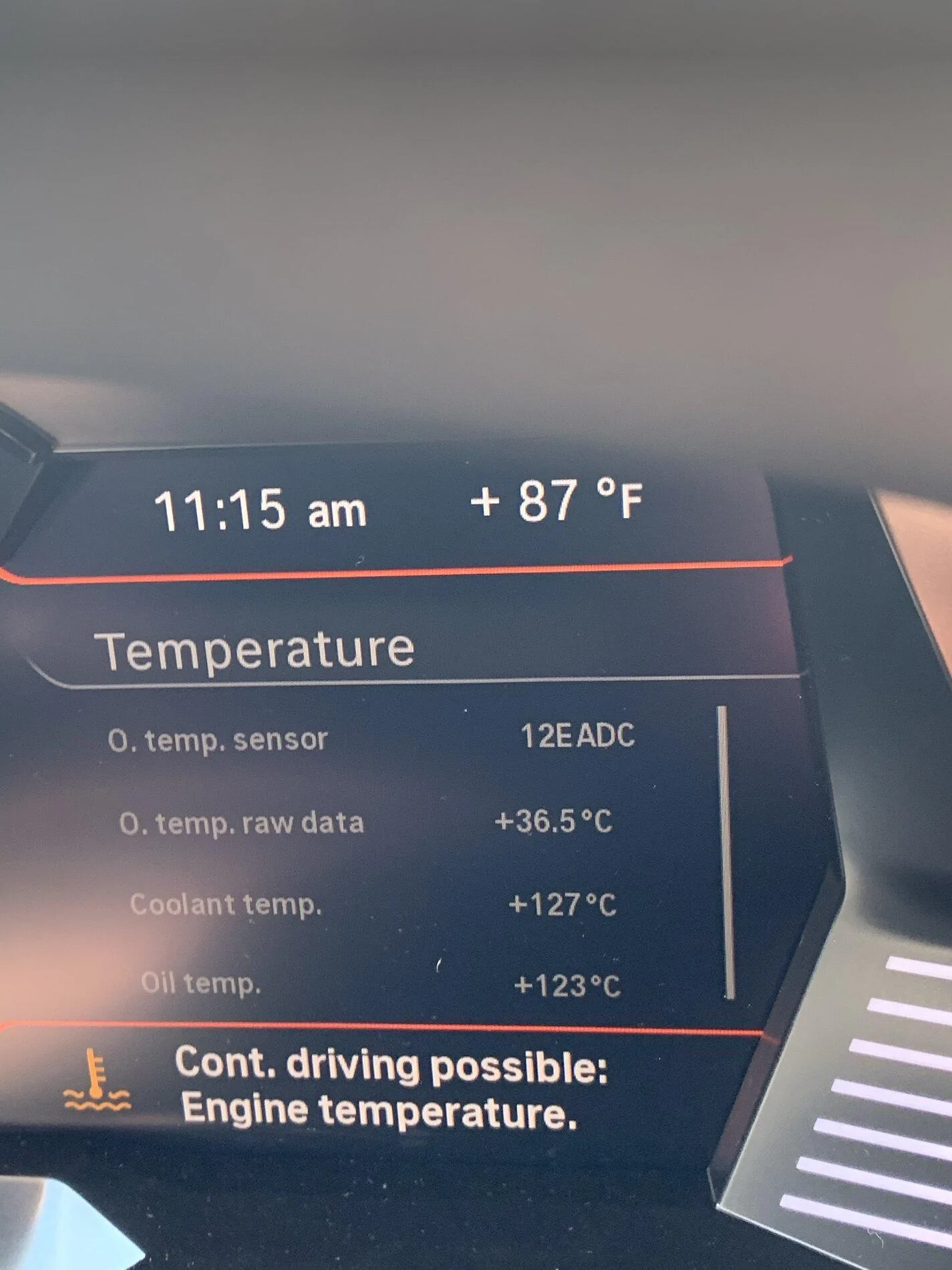

Glad I found this thread. dealer has not found problem after taking car in for a second time over the weekend. Under 1400 miles.
Next warning was engine overheating. Pulled over shut car off. Restarted with above pic warning on and drove moderately to dealer...maybe 3.0 better choice lol

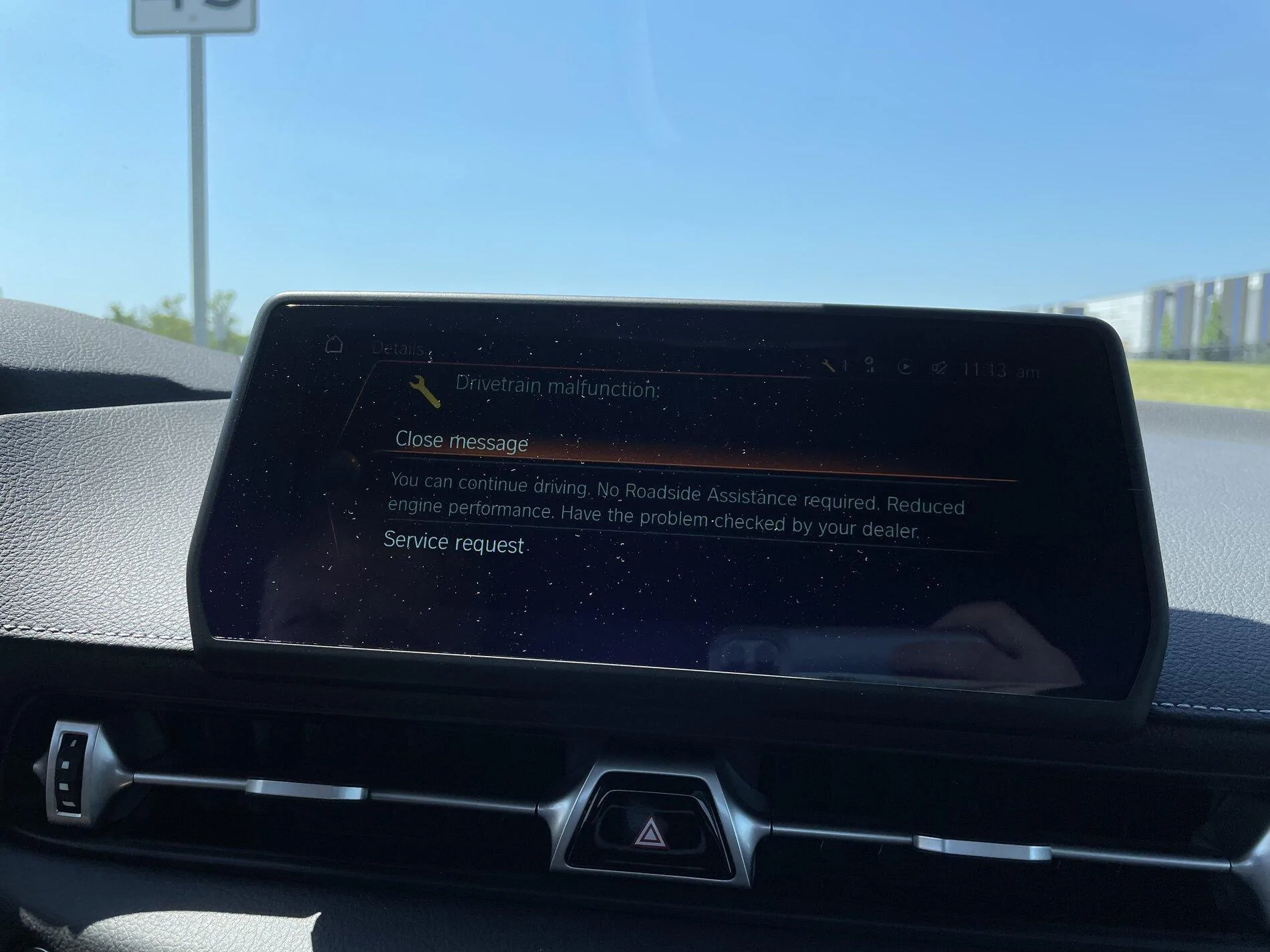

Hi guys. I just got this issue after I started the car from the gym. I drove for about 10 miles and restarted the car. The message went away and my engine performance was no longer reduced.
Does this mean the issue is gone or should I take it to the dealership? I have an MST intake and catless downpipe.
A dumb question, how do you pull up those info as shown on the 2nd pic. That part of screen on mine has always been blank. I only had the tiny one line on the right bottom for odometer/trip/consumption etc. THanks!
