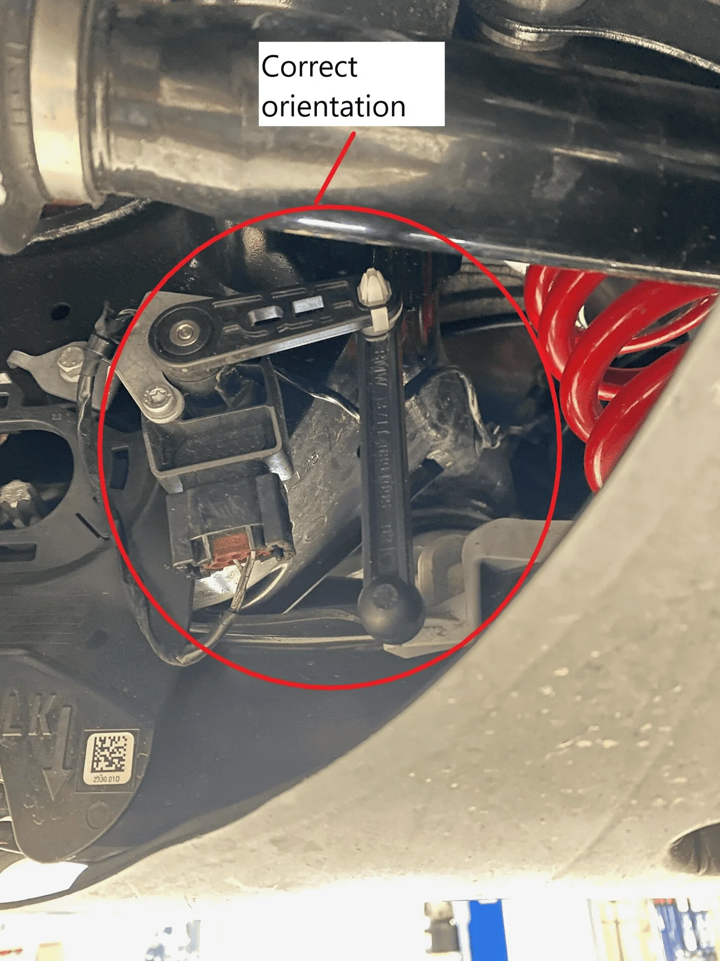

I ended up getting my dealership to install the Visconti part and it worked like a charm. I would say to anyone who already has or is planning to lower your car at all, save yourself the time and just buy this to install when you swap the springs.

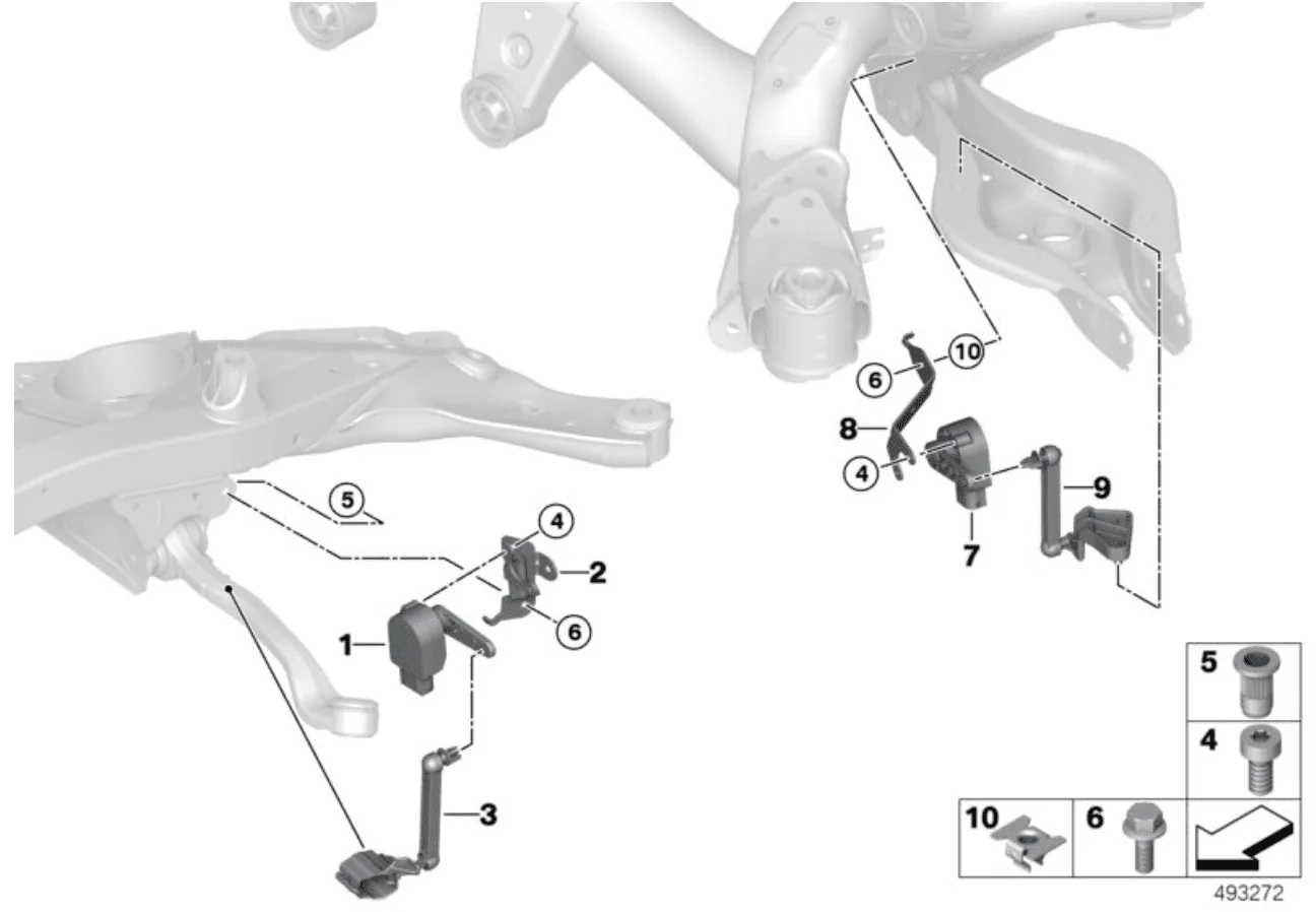

The rear bracket is very different than the front. They are not interchangable. Very easy to see the difference in the diagram below.
If you got the error after turning your Supra into a boat, I would assume you messed up the actual sensor itself.
The sensor itself is the same front and rear. BMW #37146870000

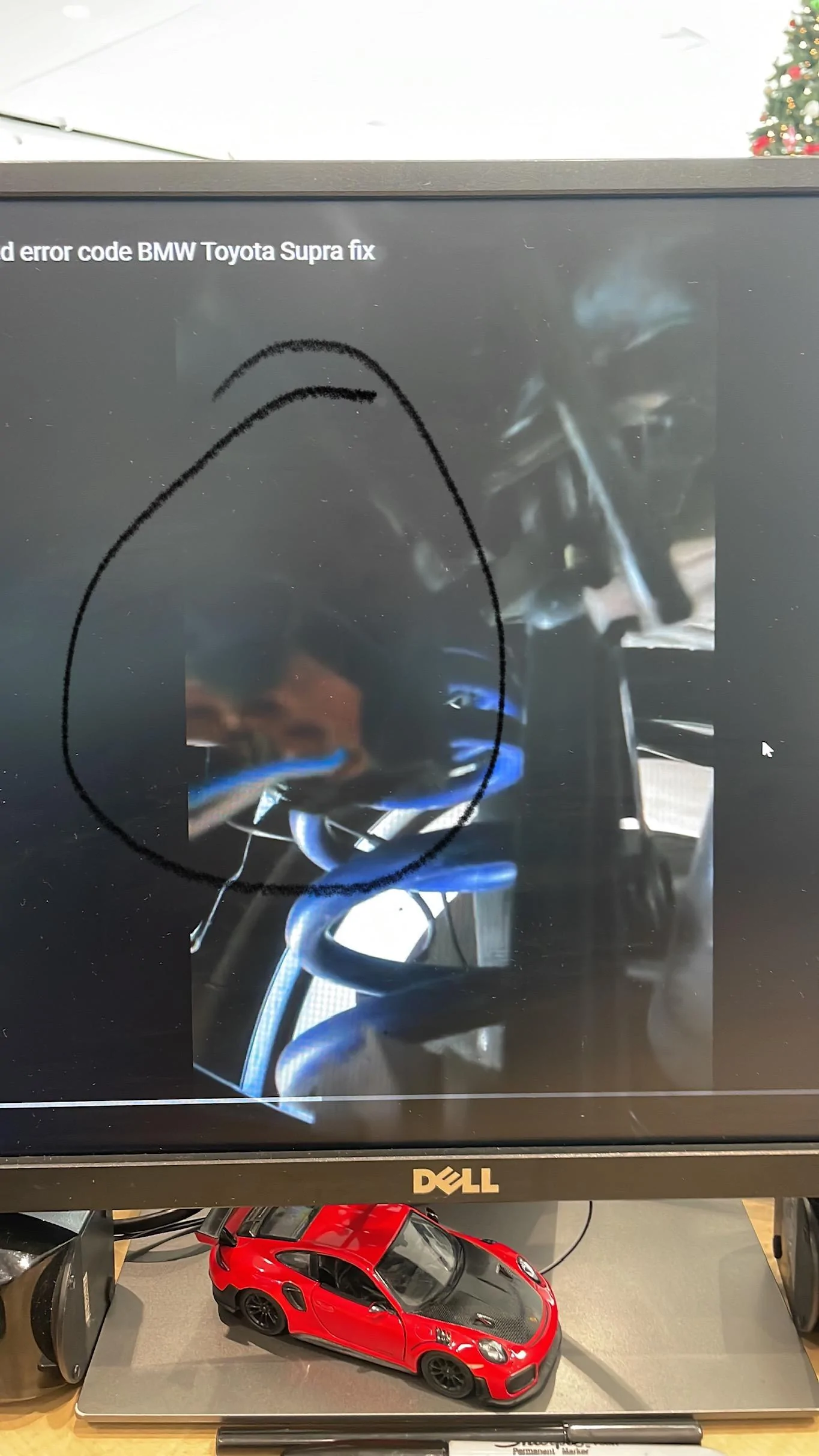

THANKS man, much appreciated, now to figure out where to start, the arm or the sensor :(
could it be possible the actual plug itself is ruined? (where that brown shows)
