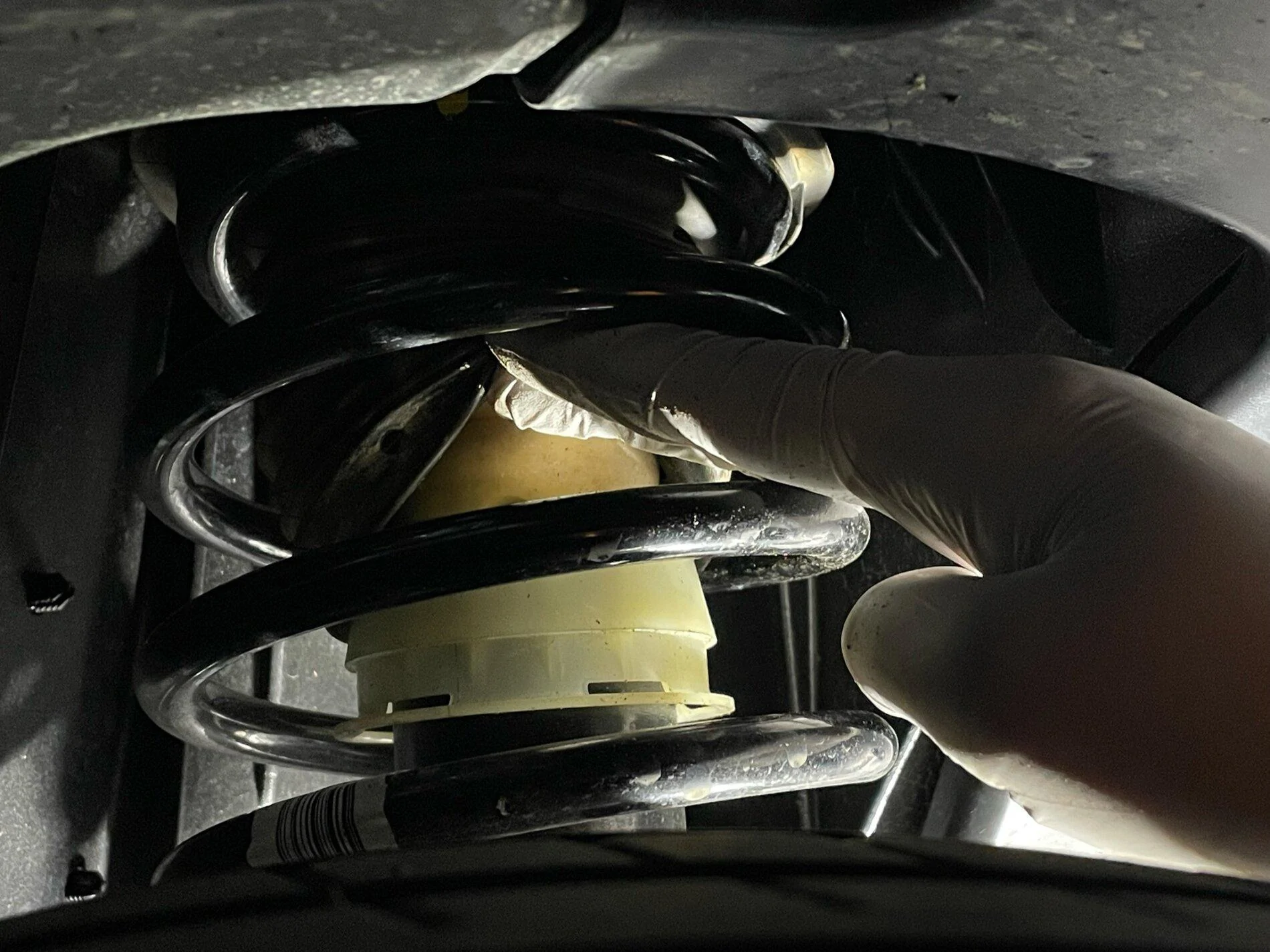

I would NOT recommend using a big box dealer. I took mine for a string alignment (expensive option) and got her sorted out. I now have two places that can do it - the string alignment place and an alignment only shop with a Hunter alignment machine. The latter place only has one guy there do it (per their suggestion, not mine). I thought he was going to charge me a ton but didn’t. He just explained they can be tricky and didn’t want anyone else touching it…. My local Toyota and BMW dealers both failed miserably trying to align this car. And… that was before I got my suspension goodies put on.
So don’t feel bad. I didn’t think it would be that big of a deal to do an alignment. If you can do the alignment yourselves, even better. Also look out for the transport spacers that can still be in there. The damn dealers don’t check to see if they are.

Pulling up these dust covers up and I see a sponge stop bump like this one, so it should be good. That being said, the dealer did spent a whole day working on the PID/PDS yet I still made a second visit so they could fix the navigation setup.
Also swapped the left and right wheels in the front and it seems to get better. Next step would be a full alignment. I do notice some panel gap changed after 1200 mile break-in period, so there is definitely still some stress relief going on, which should be a process done before driving off the factory. Won't be surprised this also contributed to the issue.
