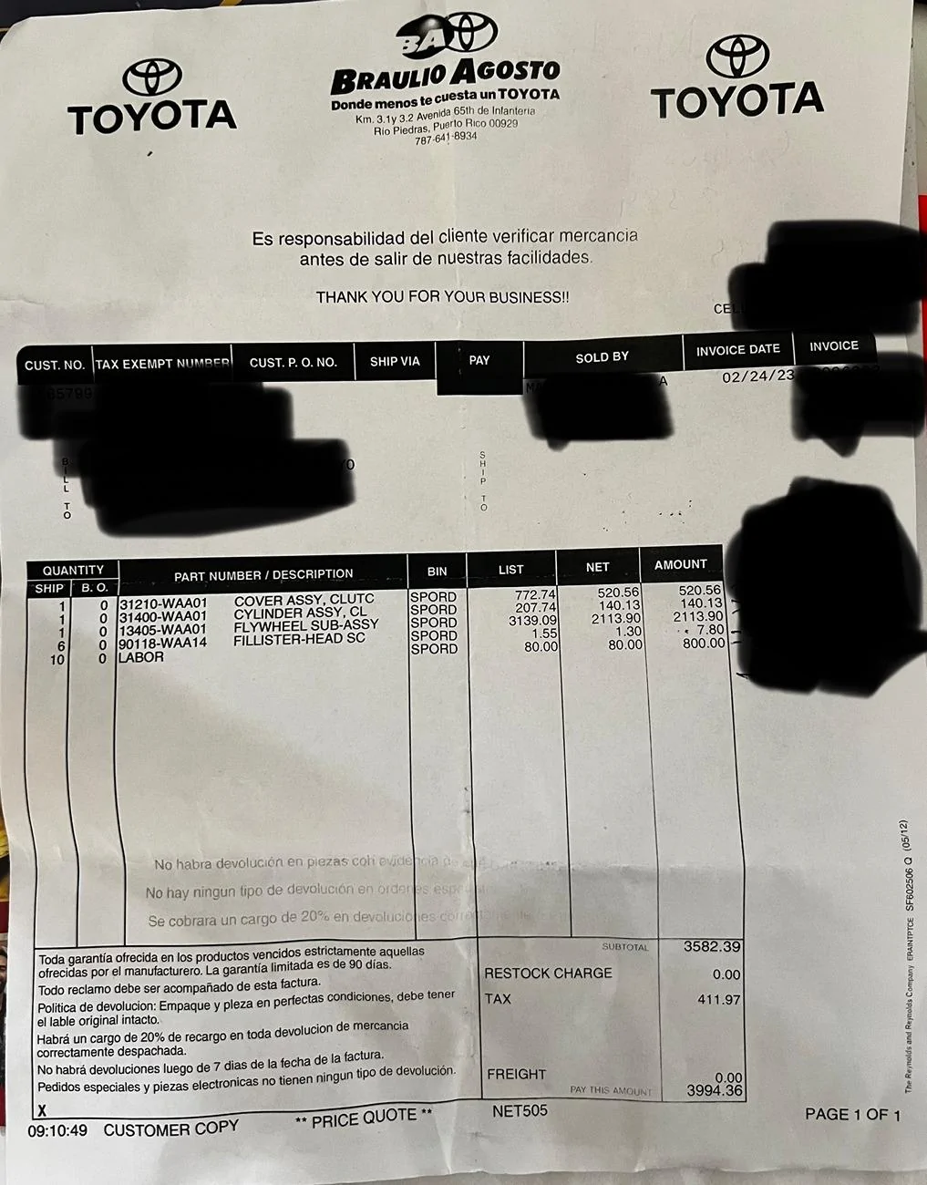

EDIT: for reference here's a quote from another owner in Puerto Rico if i understand the situation. Parts and labor about $4000.
https://www.supramkv.com/threads/clutch-slipping-on-stock-a91-mt.16639/post-261501

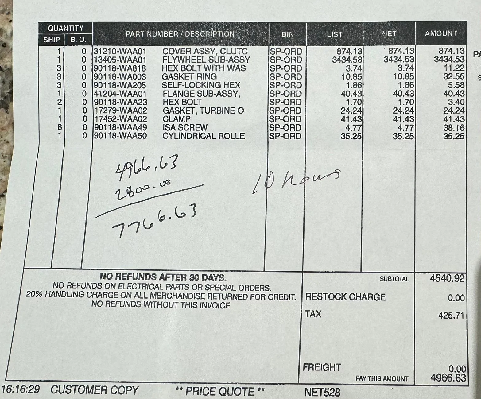

Manufacturers should be very interested in problems like this while a car is under warranty, even though the components are a "wear item". I would hope they opened an investigation or at least try to explain the actual failure mode. They should tell you what exactly broke which makes the clutch dysfunctional. The lack of concern for the customer is terrible for brand image and the general perception of the car too.
About the parts list, flywheel subassy $3,400 is absolutely ridiculous. Are you installing a new single mass flywheel with the new clutch? These guys are trying to rip you off with these parts prices.
Flywheel assy ($2320.63)
https://parts.longotoyota.com/oem-parts/toyota-clutch-flywheel-13405waa01
Clutch cover assy ($590.63)
https://parts.longotoyota.com/oem-parts/toyota-clutch-pressure-plate-and-disc-set-31210waa01
I'm not sure about the rest of the parts on that list, "turbine gasket" presumably related to the turbo. .. WTF does that have to do with clutch replacement?
https://autoparts.toyota.com/products/product/gasket-turbine-outl-17279waa02#popup-1
Misc nut, flange, clamp, did the parts person actually know what they were doing? What a joke. I would file a complaint if you haven't already.
