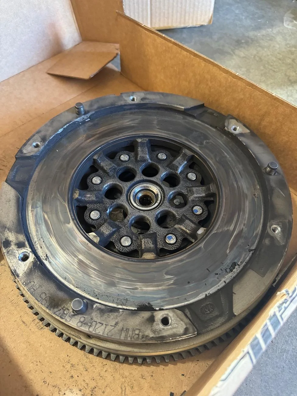

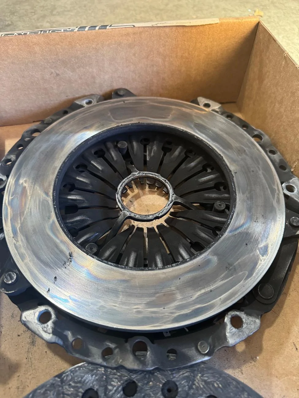

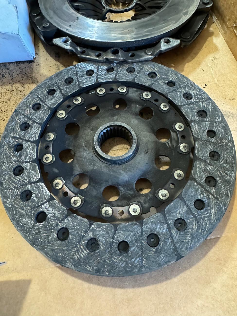

Here are pictures from the OEM parts for those curious.
Looks like the clutch has been overheated for whatever reason which has caused the pressure plate to lose it's flat face and take on a slightly concave profile which has caused the friction plate wear to be greater on the OD.
