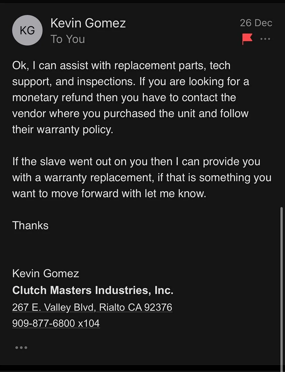

Kevin told me the same thing.
Group email?

It seems that Clutch Masters is denying a redund.
The vendor A90shop that I bought the clutch kit from is trying his best to get me a refund and he is still trying with them.
