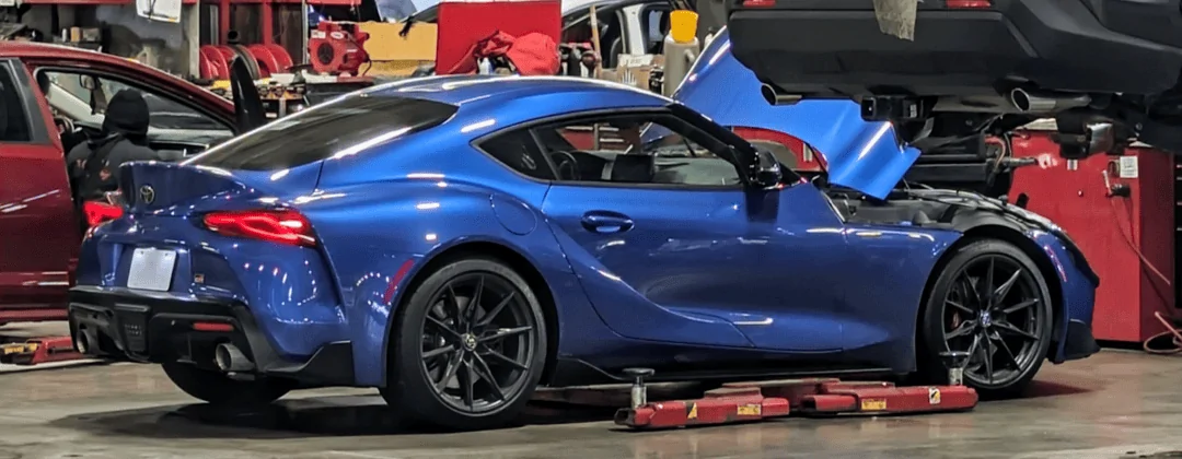

Just an FYI side note, see this car? This one right here?
The original owner appears to have taken it straight to the track after taking delivery (I kinda love people that buy these to wring out like there's no tomorrow). History allegedly shows that it received four new tires at 1,800 miles, then four more tires at 2,200 miles...and then the clutch went kaboom at Road America, necessitating a clutch & flywheel replacement at...2,400 miles. Bravo!
Seems unrelated... Toyota should cover it
