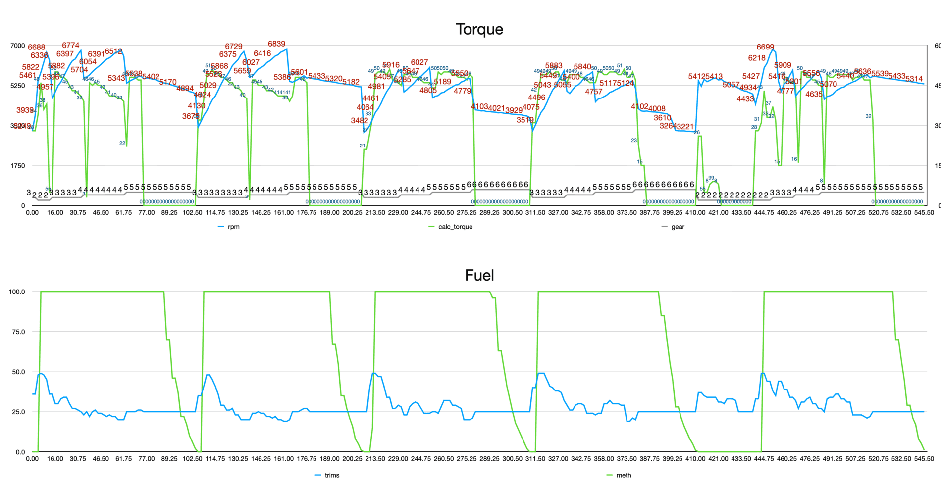

No, not personally. 2x 500cc Nozzles pretty far back in the charepipe atomizes pretty well.
What benefit did you see using two 500s vs one 1000 nozzle
8,472
14,122
Trims lower more consistently. The meth is getting atomized better and further back. What I didn't try was 1x 1000cc nozzle in the location closer to the turbo, might have had similar results. With the 2x500cc nozzles I'm getting very very consistent trim graphs. Under WOT running E40, trims up to 40-43, then as meth sprays drops to 23-27. Very in the safe range.
