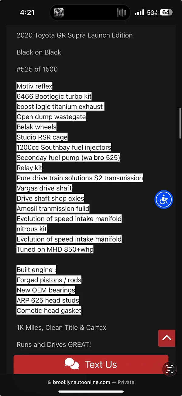

i have a walbro 525 secondary fuel pump. This is my mod list!

I bet either the relay or the Motiv Reflex is wired to constant power

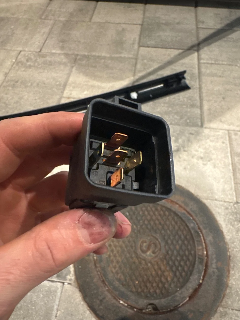

It’s my relay. I unplugged it and the noise went away. The trigger wire from the relay is plugged into the MOTIV. I’m going to put a diode on it and see if that works if not then my question is why didn’t he tap the trigger wire into the fuse box to a IGN-ON power source. Am I missing something? Will it not perform as well?
