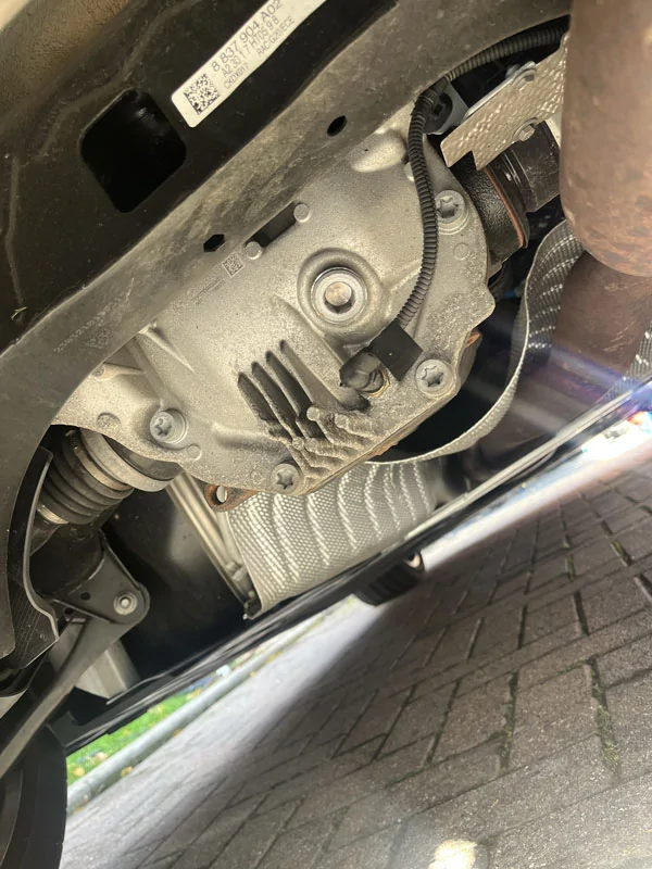

It does have it.
Regarding the type in Europe, at least Toyota's literature, they keep saying it's a mechanical/non active LSD. It's kinda confusing, I never really investigated too much. :)
Last time I was able to check the parts, from memory, same part # as the M2 (but I have no idea of the trims/options there).
Looking at it, it does have cooling fins at the back (and a sensor plugged in) and looks slightly different from those of some 2.0 I've seen pictures of (from the US) and still different from 3.0 (less fins). But it's just something I noticed watching a few videos and photos over time. But it can be just different revisions.

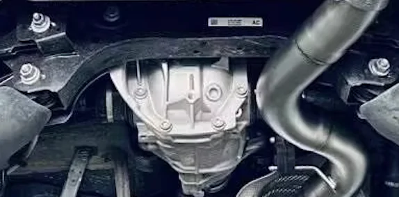

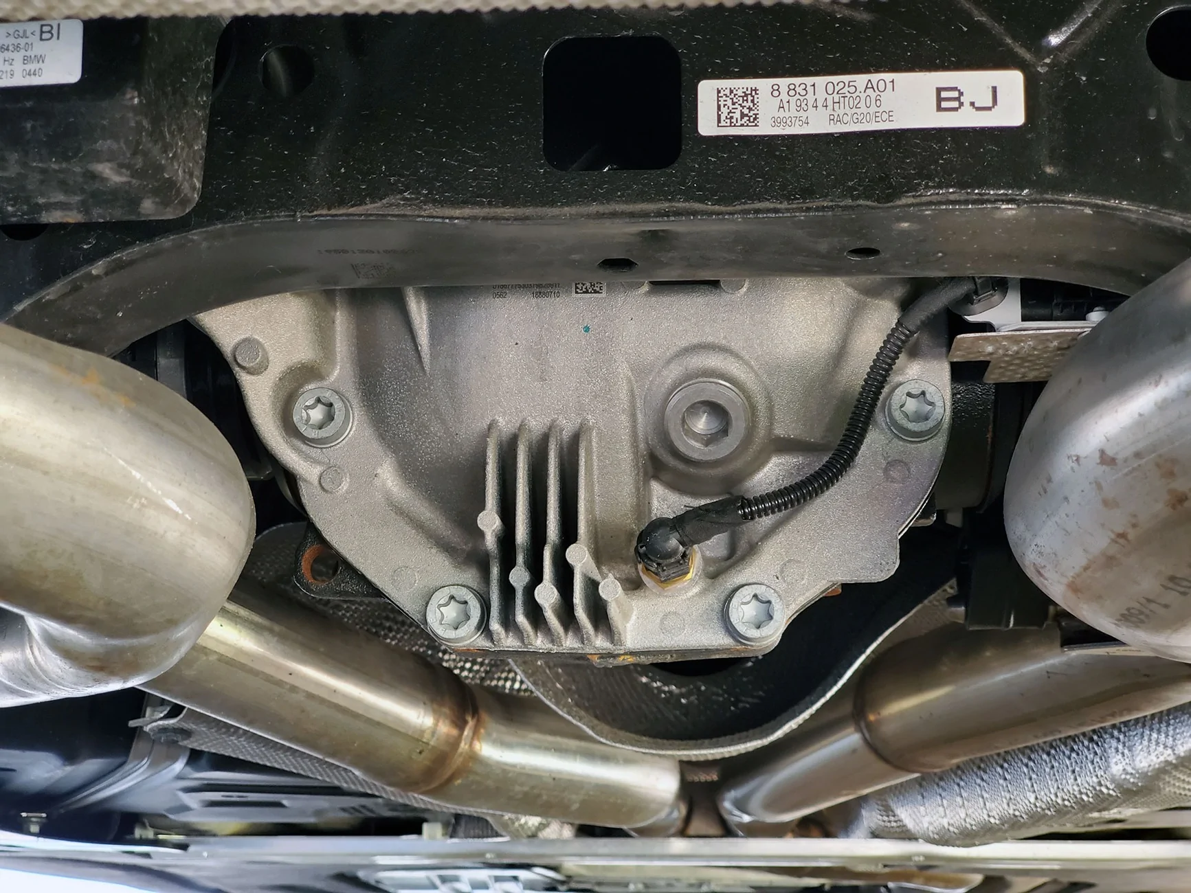

Which of these two does it look like?

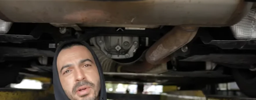

The ones I saw in pics and videos I mentioned above are these, I suspected these were the open ones:
8,806
17,269
Yea that is the active LSD diff. Same as Supra 3.0 but you get the M-lite cover.
The second image I posted is the open diff. Also same as the one in your photo wearing the hoodie.
Full M diffs have the cover on the bottom, not the back like ours.
So now my question is, did the place put OEM fluid in your diff or something else?
