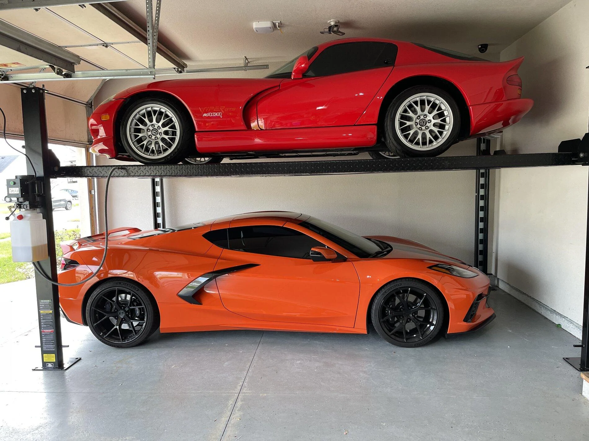

Where... did it go?
Originally me and my dad both wanted c8s. The Chevy dealership only gave us one allocation so we went in on it together for him to have it before upgrading to the zo6. Stuff changed when I seen how every corvette owners is an old man. Went with something more my age (20). My dad is happy about it too actually because he’s throwing twin turbos in the near future! I did enjoy it tho, raced it on the track a few times. Definitely more of a track monster but I’m more into what happens on the streets, making the tuner ability superior
