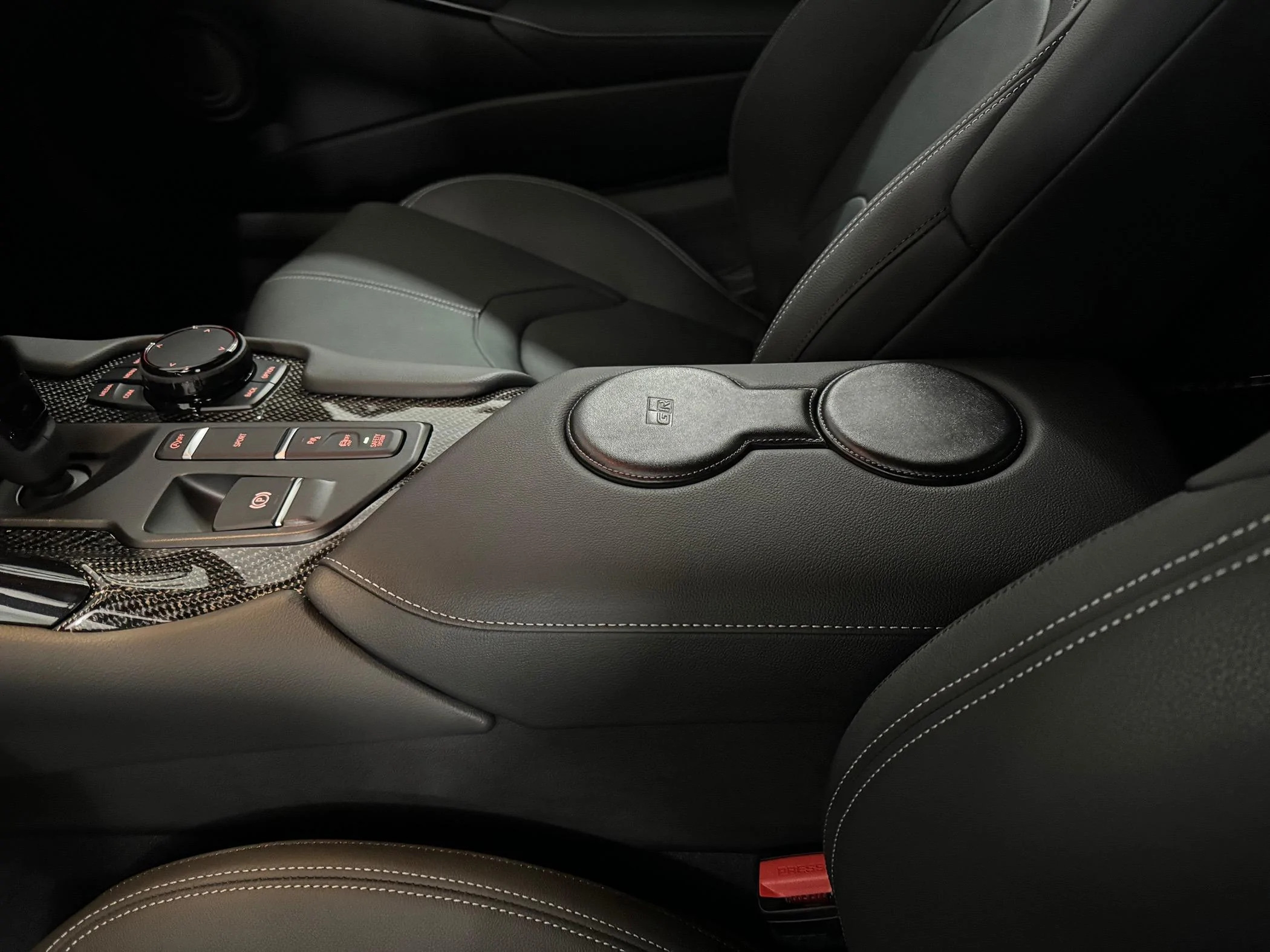

Did you order from the easycars.jp website?
No, a friend of mine picked it up in Japan for me. I think he just got it from his local dealer.

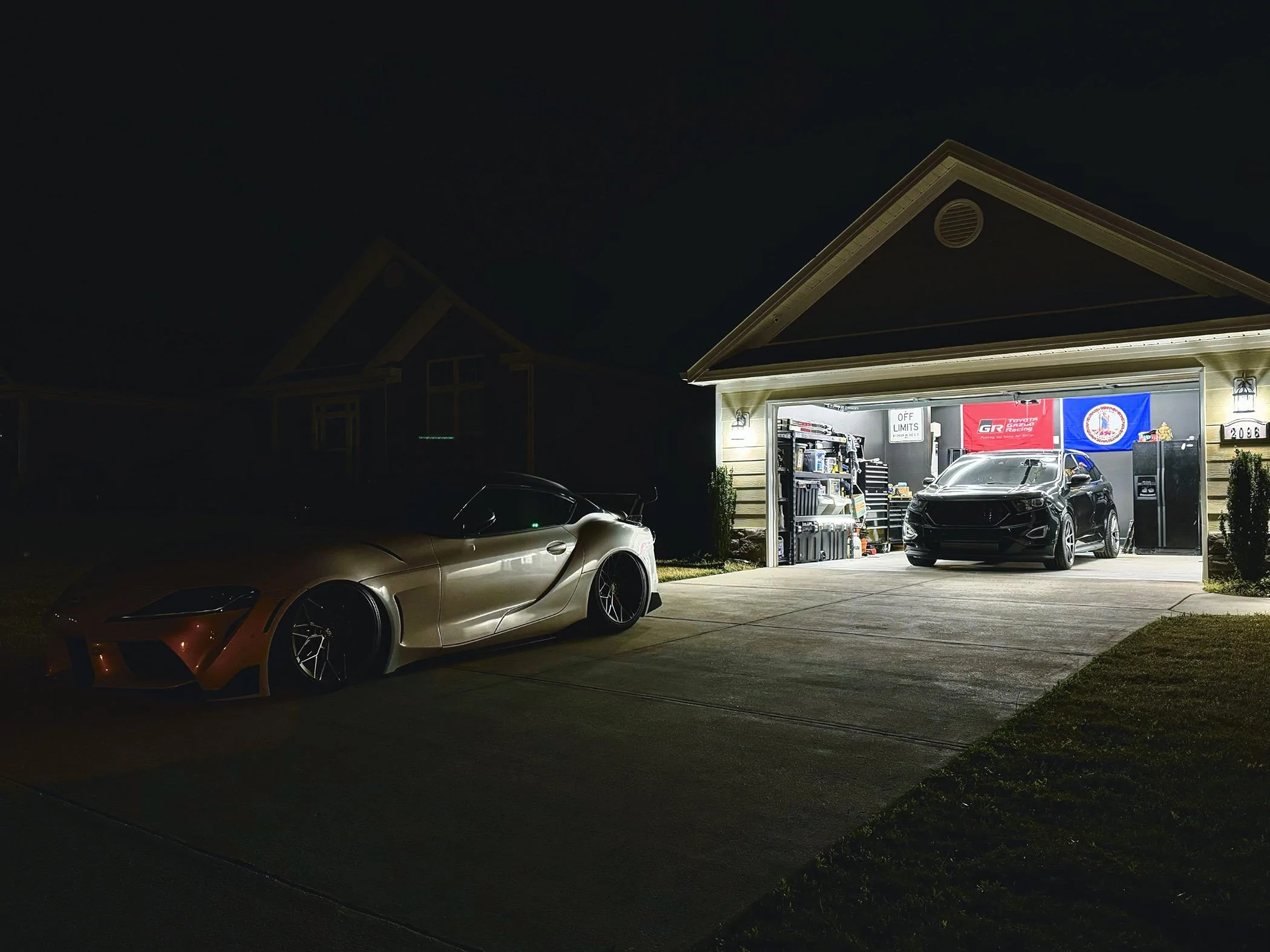

RK Track Exhaust so loud, I left the Supra outside instead of starting it at 1am after working on the daily

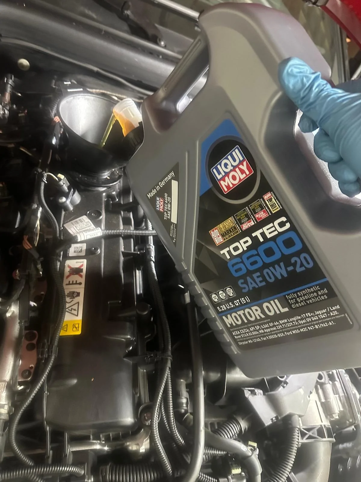

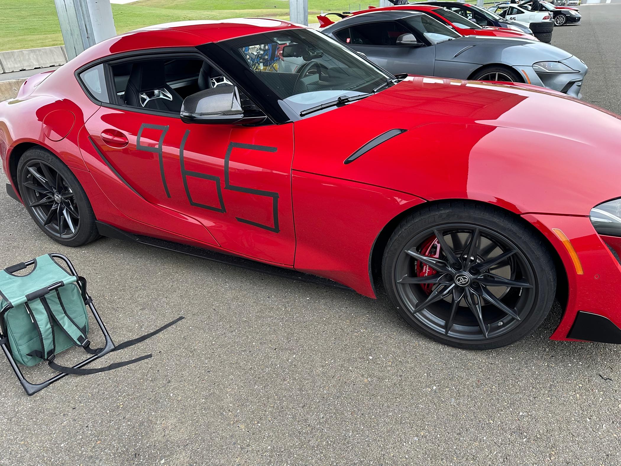

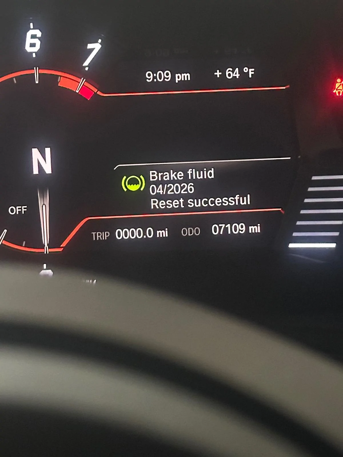

This past week:
Did a brake fluid flush with RBF600 and oil change in prep for my first track day at Thunderhill West. Was a blast to do so, and the car was great stock. I also finally installed the wind deflectors since I was gonna be driving with windows down at speed
I'm probably gonna swap the fluid for Castrol SRF or something because the brakes started feeling soft near the end of the track day.
Oh, and I have another track day scheduled Saturday already at Thunderhill East. Will see how much tire I have left after and I'll have to start tire shopping.

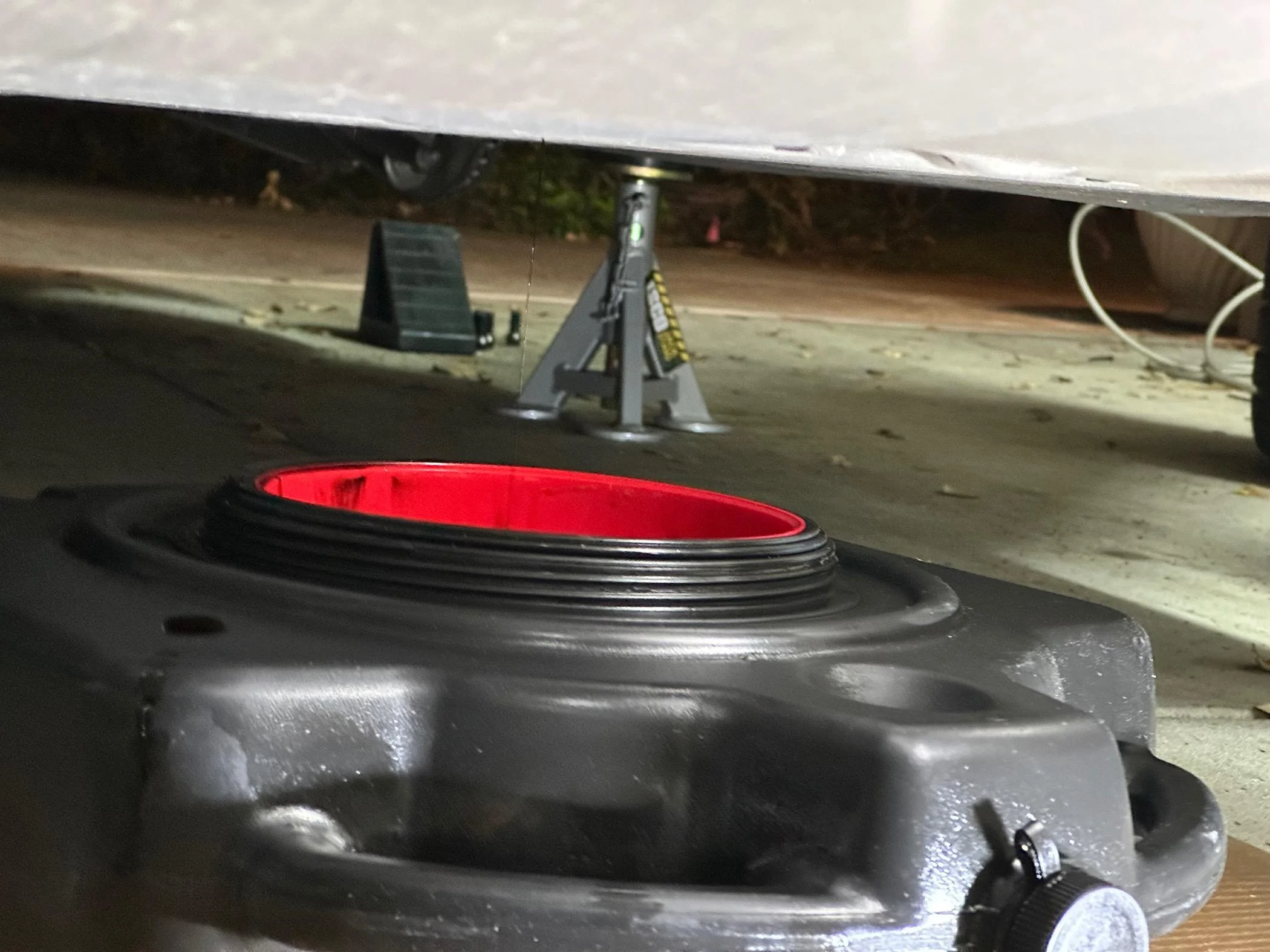

Last week I finished installing my remnant performance intake manifold and port injection with reflex. Went and filled up with e85 (only e75 after testing) and noticed my ethanol gauge was jumping 10-12% randomly after a 20 minute drive. Troubleshoot it as a bad reflex module.
Yesterday I flashed software into the new controller and issue is gone. Now time to do some pulls and logs for my tuner.

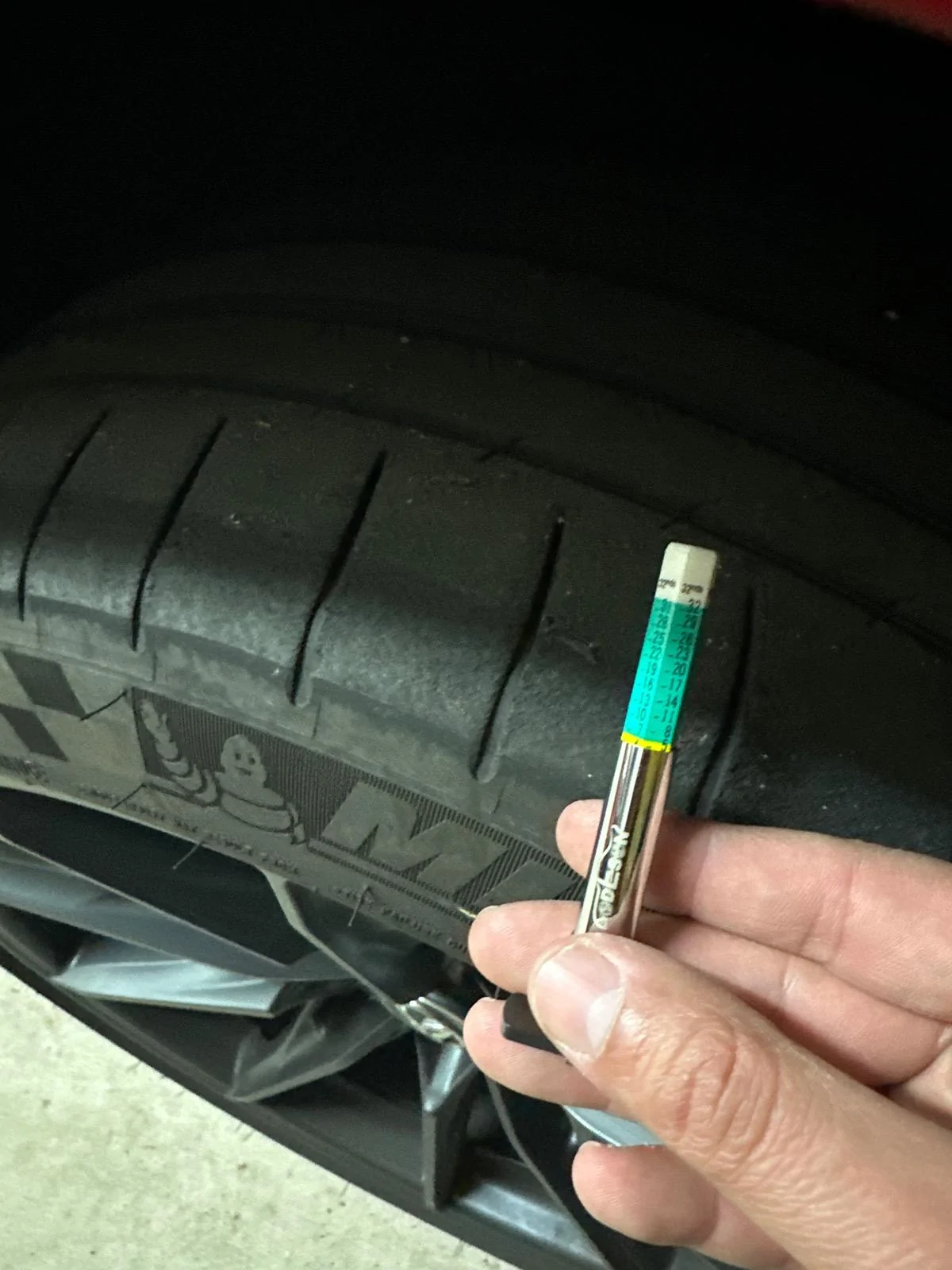

Prepping for my track day in Vegas this weekend. Rotated tires, pulled wheel studs and re-loctited them, nut and bolt check, updated trans tune to version 1.3 and made sure it still had oil in the engine. Brake pads are still looking good after 6 big track events and a few auto-x events. Going to wash it tonight and I should be ready to go!
