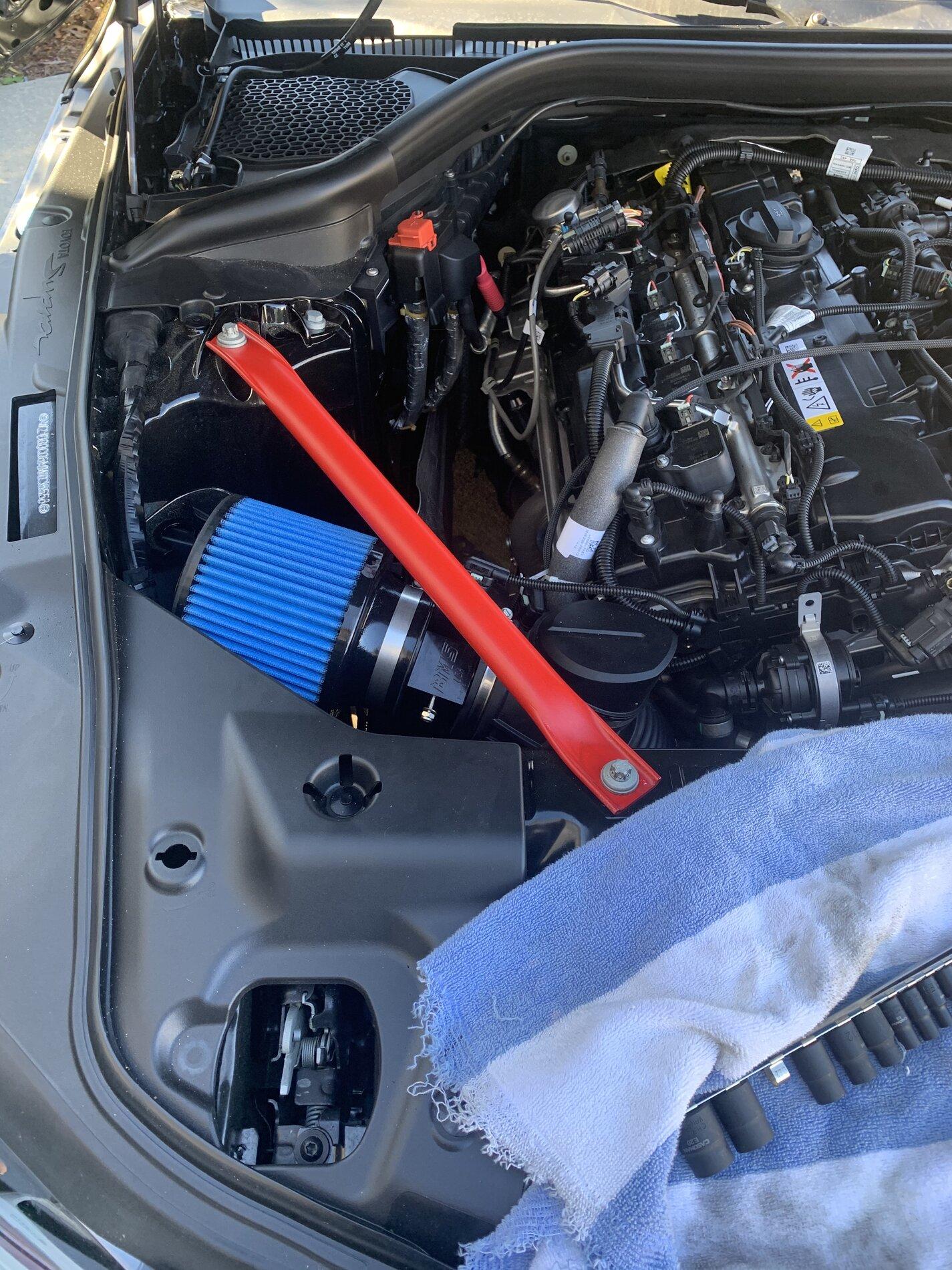

Painted effective but ugly stock braces
going to fab my own insulated piece to protect cone filter from engine heat. Will be alright this winter w cold temps and won’t drive it much.
Love the red! Much better than stock.

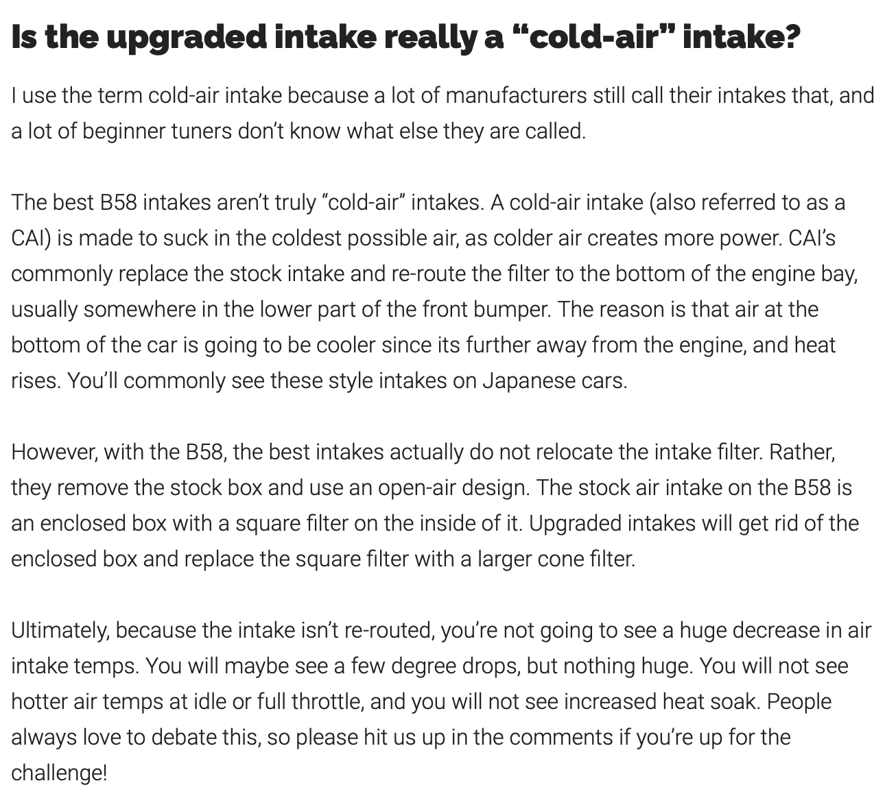

I'm also eyeing the BMS intake and was wondering why add a heat shield as it's meant to be an "open air" intake?
I was considering this myself, so now I'm confused.
From BMWTuning:
https://bmwtuning.co/bmw-b58-upgraded-performance-intake-guide/

Rocksandblues
Bob
Sep 21, 2020
2,164
3,664
Virginia
Welp.... the stock air box has a very efficient cold air design. There is a duct right below the headlight that funnels cold air directly into the air box
the air box is a very efficient design and will provide more than enough air for almost any application.
The fancy CAI claim to boost hp by only 10 and if you look at the dynos that is only at 5k and above rpm
I did it for the noise honestly. With my budget design I run the risk of engine and exhaust manifold heat getting sucked in and that will actually rob me of power. I am going to cut and fab a piece to separate the cone from the heat and have it meet the hood to create a little chamber just fed by the factory duct below the headlight
