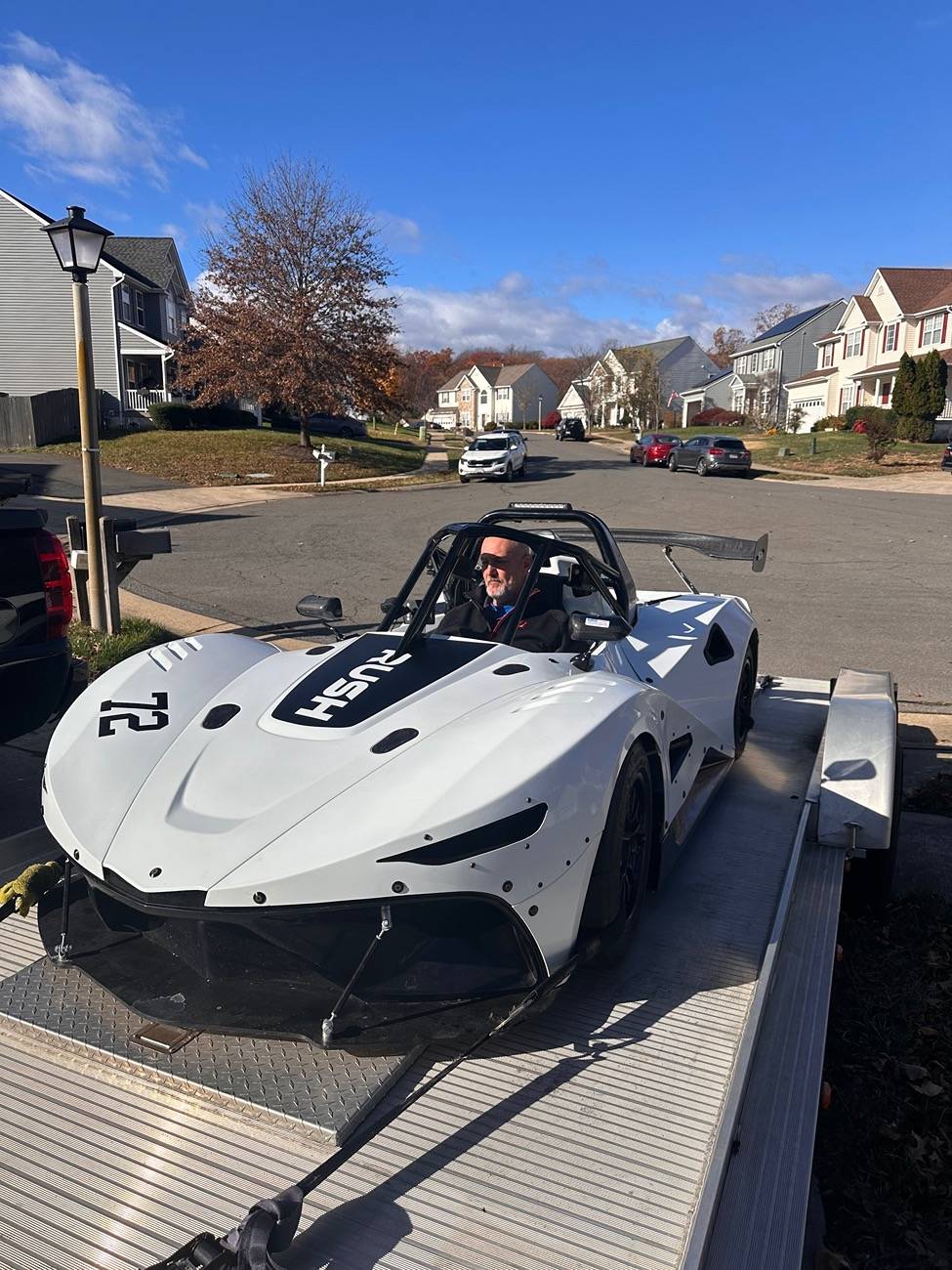

What is that?
Yes, Rush SR
1100 lbs
150hp
1000cc Suzuki engine. 400lbs of down force. Pulls 2 g’s + !
Shake down is tomo on track. No abs no power steering or brakes No reverse
Never driven one. lol. Don’t even know how to turn on AIM stuff.

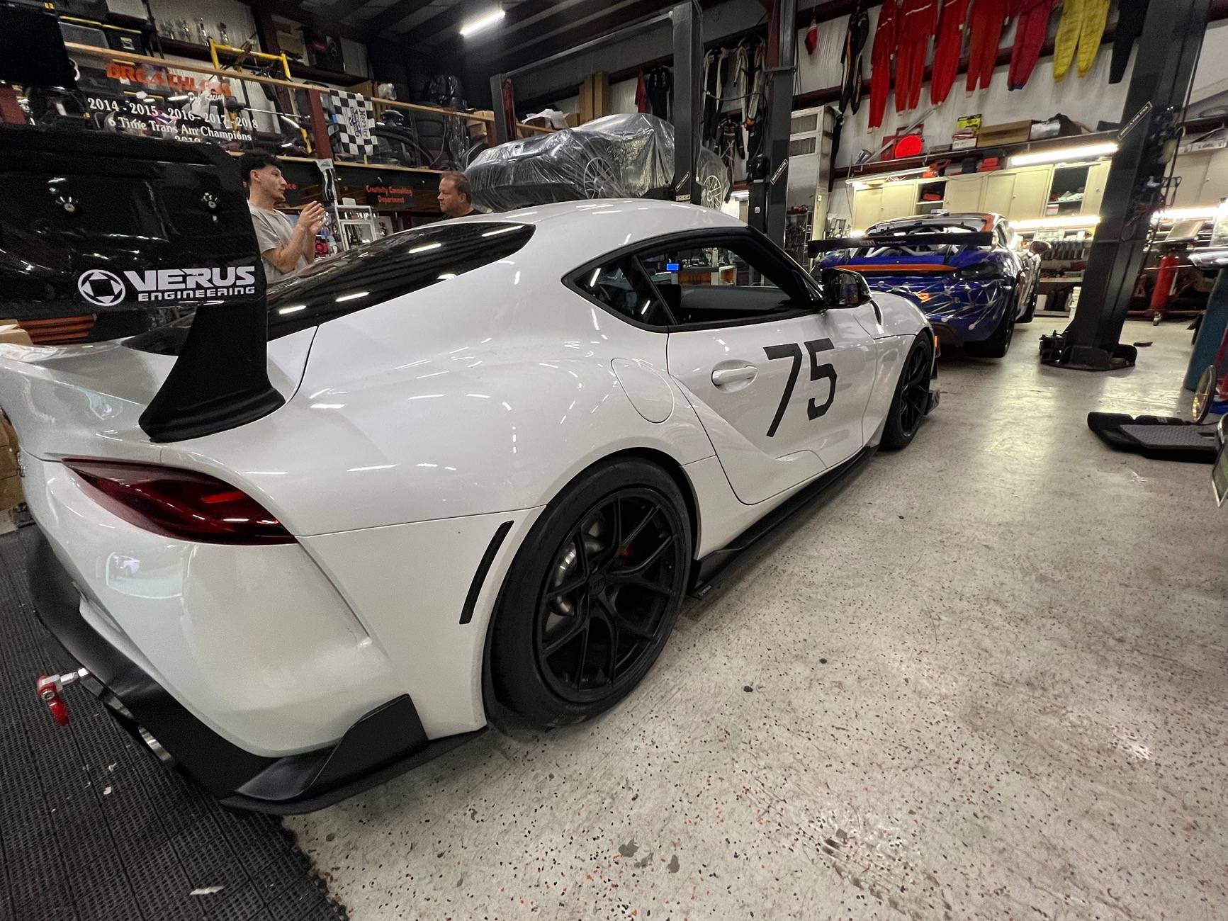

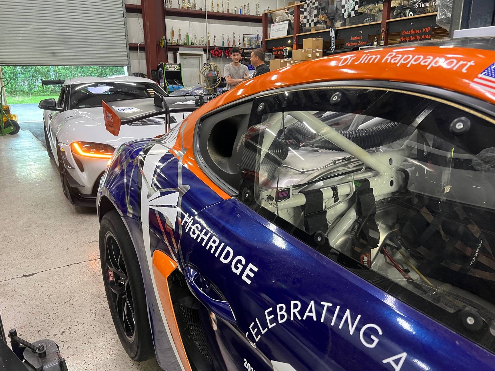

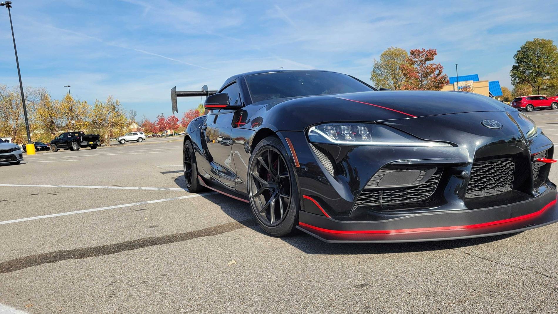

After installing the RSR and one bucket seat, I took the car to my friends at Breathless Racing (he won the Lamborghini Super Trofeo Champions in Spain 2 weeks ago) for a well deserved safety check.
They inspected the car and the cage.
As it ha been said earlier:
“the RSR cage is well built and weld, but the securing to the chasis is not adequate for any sort of racing, not even the weekend track day”
He proposed to place bolts through and through with backing plates and weld it to the chasis.
He will also anchor the harness to the chasis floor with backing plates and wants me to 4 corner balance the car since I’m done adding / removing weight from it - for now ?
I am looking for a good adjustable links for the sway bar. If you guys know, LMK.

Well known it is just a car show bar. Always been suspect for track duty

Hate to say it, but..... I told you so. ;)
Yep you did. But it was too late for me as I had already purchased it.
Now I have to invest a little more making it as safe as possible. ??‍♂
Learning on the go. I’ve made a LOT of mistakes.

now tell me about some decent adjustable sway bar links before I go for the wrong thing ?. verkline is too expensive and maybe an upgrade in the future. I need something entry to mid level. They suggested I need to balance the car out.

Anything but SPL. Verkline is only $50 more.

Beautiful car and build ?
Now spend the extra $50 Bryan mentioned and get Verkline ?
