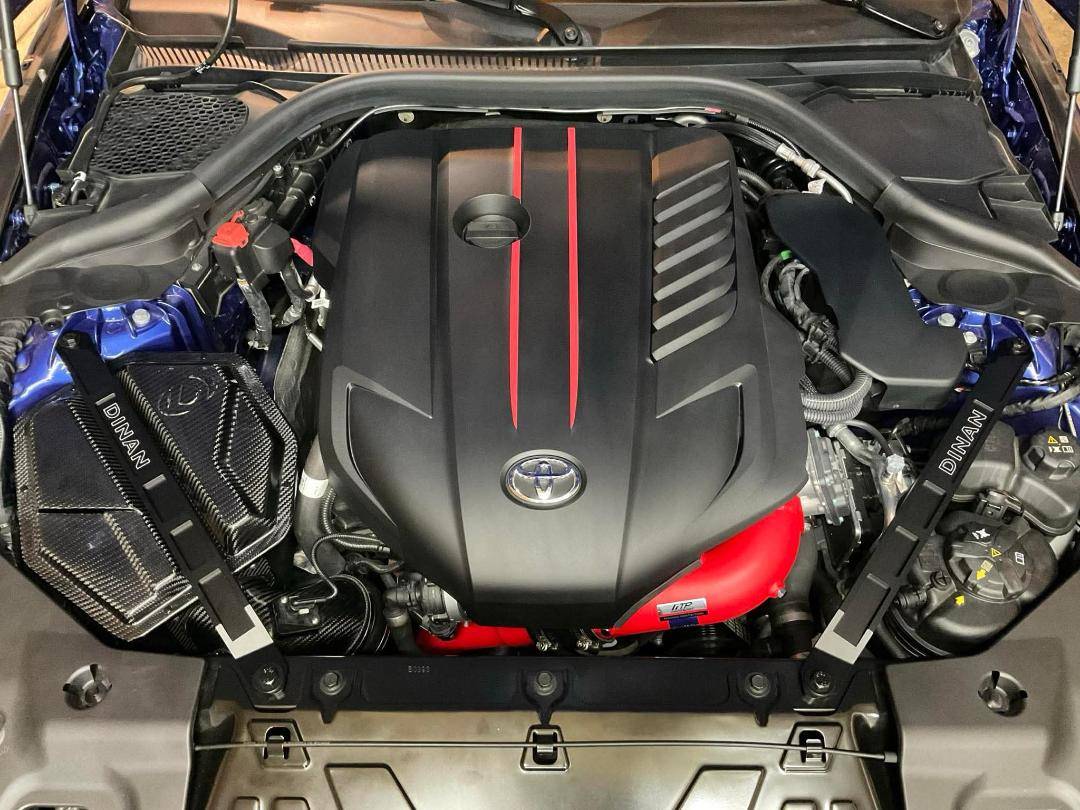

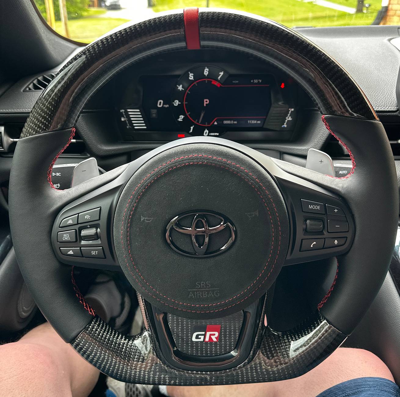

Finally, installed a few pieces. Dinan CAI, turbo inlet, strut braces, AA catted down-pipe, FTP motorsports charge-pipe and new steering wheel.
Beautiful!! Now convince me the install isn't too bad....I really want one and am dreading the install.

Takes 15 mins if you know what youre doing. Really not that scary.

New wheel but kept OEM paddles? ?

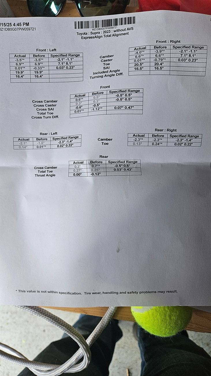

Factory toe is all over the place wtf. Only mod is camber plates. Ran out of rear camber adjustment. Probably tick the rf camber down to 3.5-3-6 to match the driver side. All in all pretty happy for no aftermarket arms.

Find a different alignment shop.... Also, what is your spring/coilover setup? You may have other issues going over 3.5° camber in the front.

This got to be the worse alignment spec before and after lol

3.5 isn't even scratching the surface on a bmw multi link. The pyrometer determines camber.

why is front camber different and rear camber + toe not exactly matching. i want that spot on spec ?
Because I told the gentleman not to touch my camber plates because I can adjust that myself. I can't adjust cross toe, however.
Camber also changes 0.3* with me in the car to 3.8 on the driver side and -2.3 in the rear driver side
If you're chasing a # on an alignment rack you're wasting your time because you're going to adjust the alignment on a track car almost every track day based on conditions and tire temps

The front of our cars isnt a multi link.... And I get that a pyrometer is how you dial in camber but again, depending on what your setup is, your springs may be binding on the shock towers. I also get my alignment done with me sitting in the car or equal weight.
And lastly, do you not think adjusting camber is going to mess with toe?
