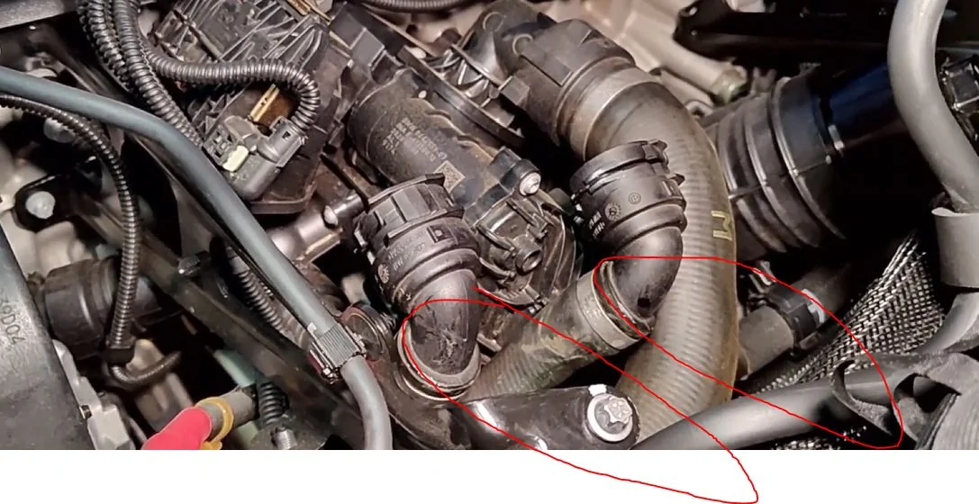

Nice! I finished my install a couple hours ago. A couple tips, people complained about the difficulty of popping the coolant hoses off the bottom of the OEM manifold. After popping the clips on them, what I did was put a very heavy duty zip tie around them and then pulled the zip tie loop I created. You can also use this trick on the hose you disconnect underneath to drain the coolant. It makes it so you're not in a cramped area trying to pull on a tiny hose that's stuck on tight.
Connect the hoses to the manifold first and then route the hoses down to the connection point. Make sure you don't get the lines pinched. A 5mm ball end hex makes tightening the manifold bolts easier. Also don't tighten anything down until you have everything in place and threads slightly started. You absolutely need a magnetic pick up tool to set them in place. The grumpy vet garage video is pretty solid.
Edit: Adding picture of zip tie loop

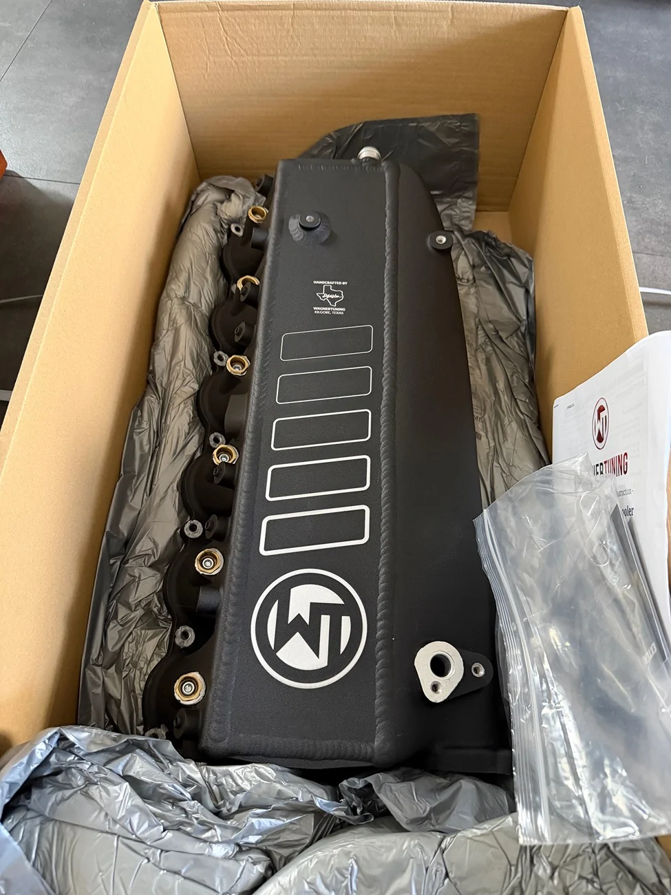

Great pointers! I followed your advice and they actually came without MUCH difficulty.
OEM manifold is out now and I just taped the valve openings to be safe.
I will buy Grumpy Vet a beer. This job would’ve been really hard without this video.

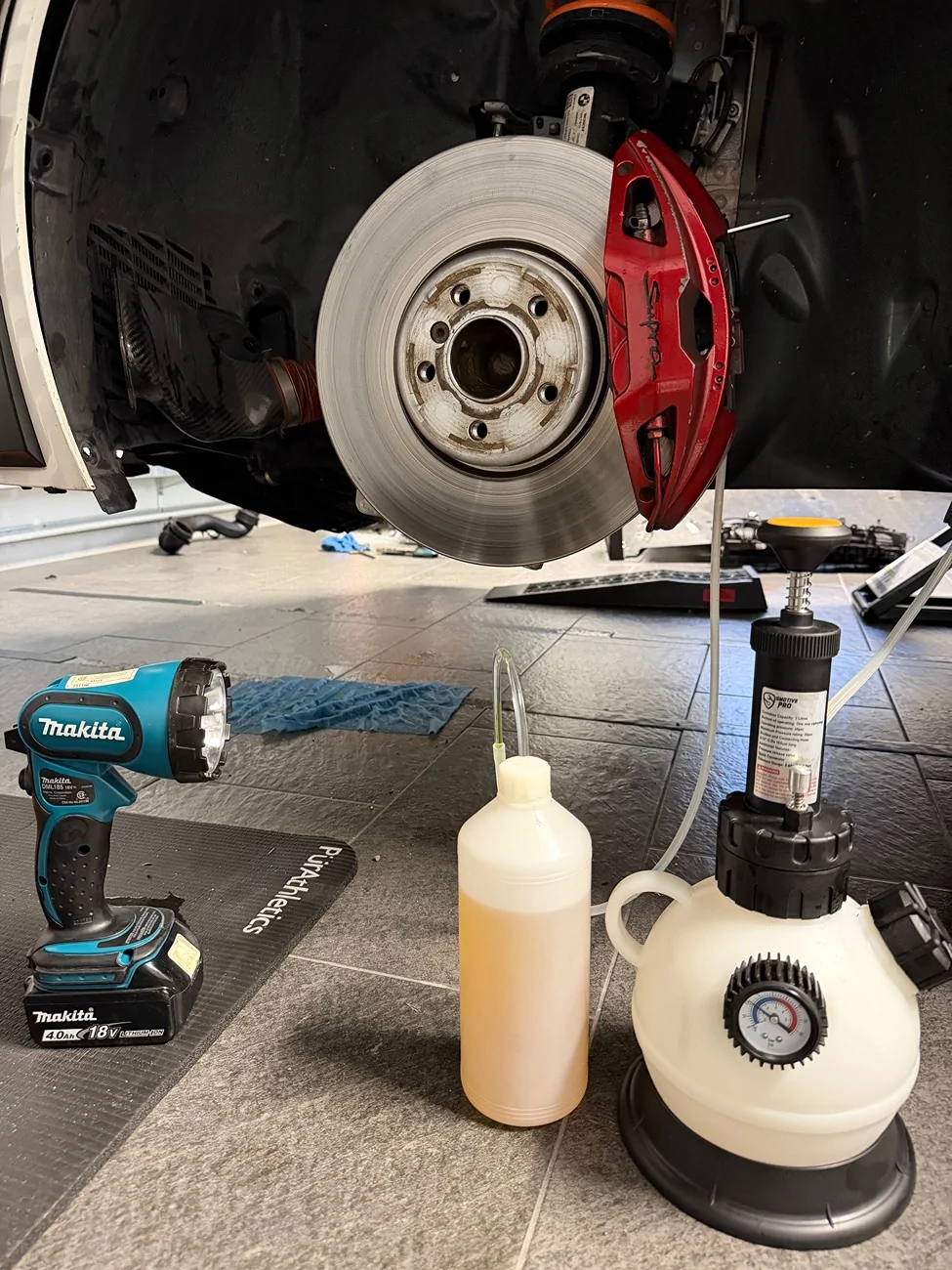

I put a pause on the process because I FINALLY got the adaptor cap for the Master Cylinder and will flush the brakes so I can put the car down on the wheels and work better to install the Manifold.
I hope Vacuum filling the coolant is not going to be hard. I will do it based on the videos.
