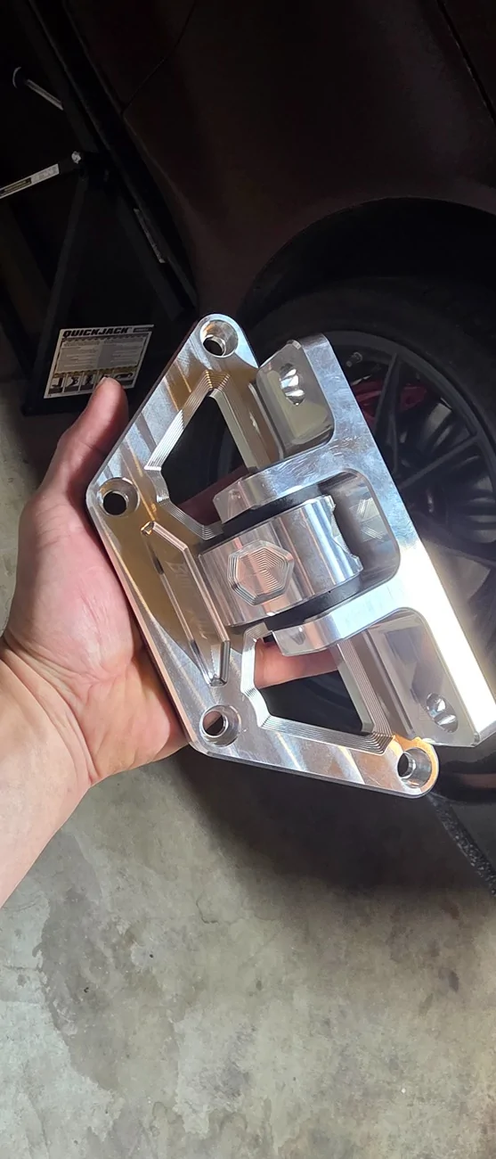

After a little bit of back and forth I decided I didn't like the color of my current and started exploring different options with this idea in mind. This one should be a little more along the lines of what I want .

Why lateral bushings? I thought the point of a diff brace was to resist rotation about the drive shaft axis, and those bushings seem to defeat that.
The bushing is hard as f***. So it's not going to have a ton of play. It's there too prevent vibrations, it's still prevents the huge jump that would normally happen during a hard launch.
Kind of the same idea between a solid engine mount and solid hybrid polymount. It's just a little nicer on and everything connected to it.
Unless I'm missing something obvious then this design will resist the differential rotation generated by the torque reaction of the pinion and ring gear as expected. It's just a more sophisticated design than the other one.

4 points of contact on the diff rather then 2 also. This design is quite a bit more robust as well. I'm happy I went with this overall. The look is much more pleasing. Now to schedule a powder coating
Bushings work best when loaded radially wrt the bolt/shaft. This would react to diff twist with a moment.
Yes, you can spec a different material to account for stiffness. No, the non uniform stress will be inherent to the geometry.

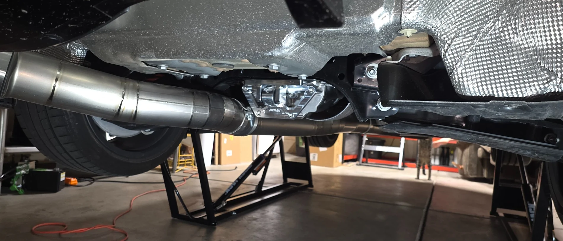

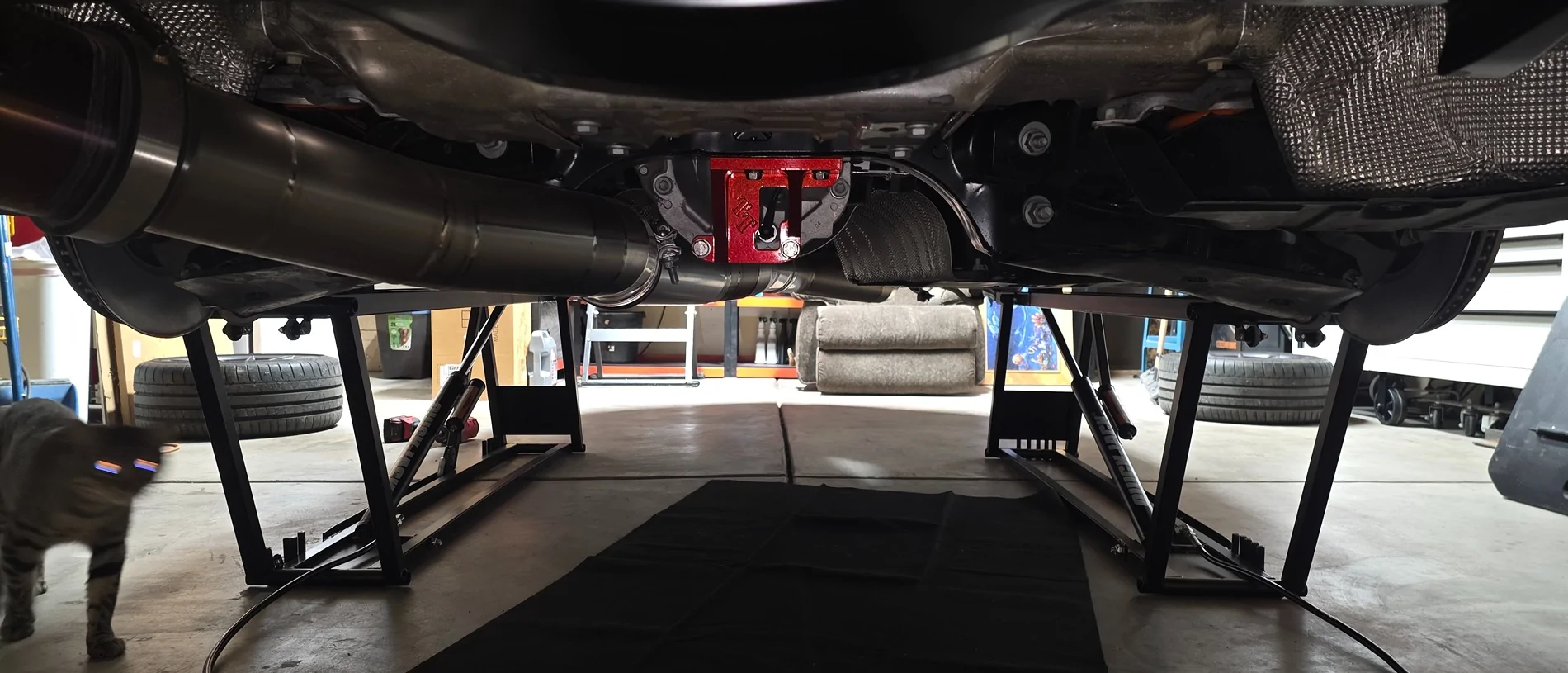

Like 1,457 people before me, I have installed my diff. brace.
Much like the CDV discussions before, I am now starting the "I think this made my shifter feel more notchy or something" discussion - fuck knows if it did, but if my brain thinks that it did, I suppose that's all that matters.... :crazy:

I had it fabricated - I wanted that angled melon cannon look.
The side pipe at the end is a helmholtz resonator that I specced out and had fabricated to try to combat drone - so it just dead ends.
I think the whole thing has shifted tho because that looks mighty close to the car 😅

Oh thats sick! I always forget the process for speccing out a helmhotz resonator really isnt all that complicated. I should look into that again, 8th gear is practically unusable cause of how bad it drones unless im doing like 80+
