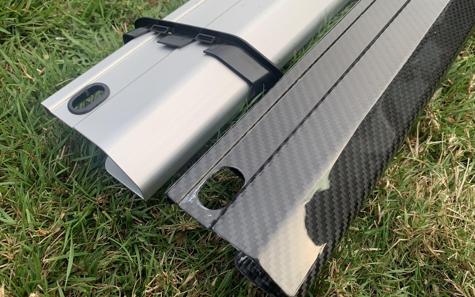

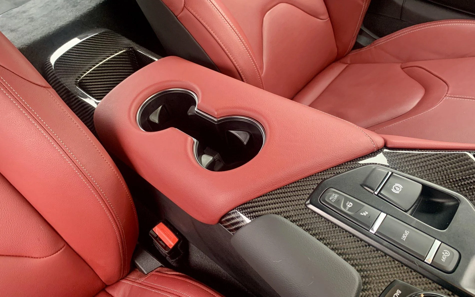

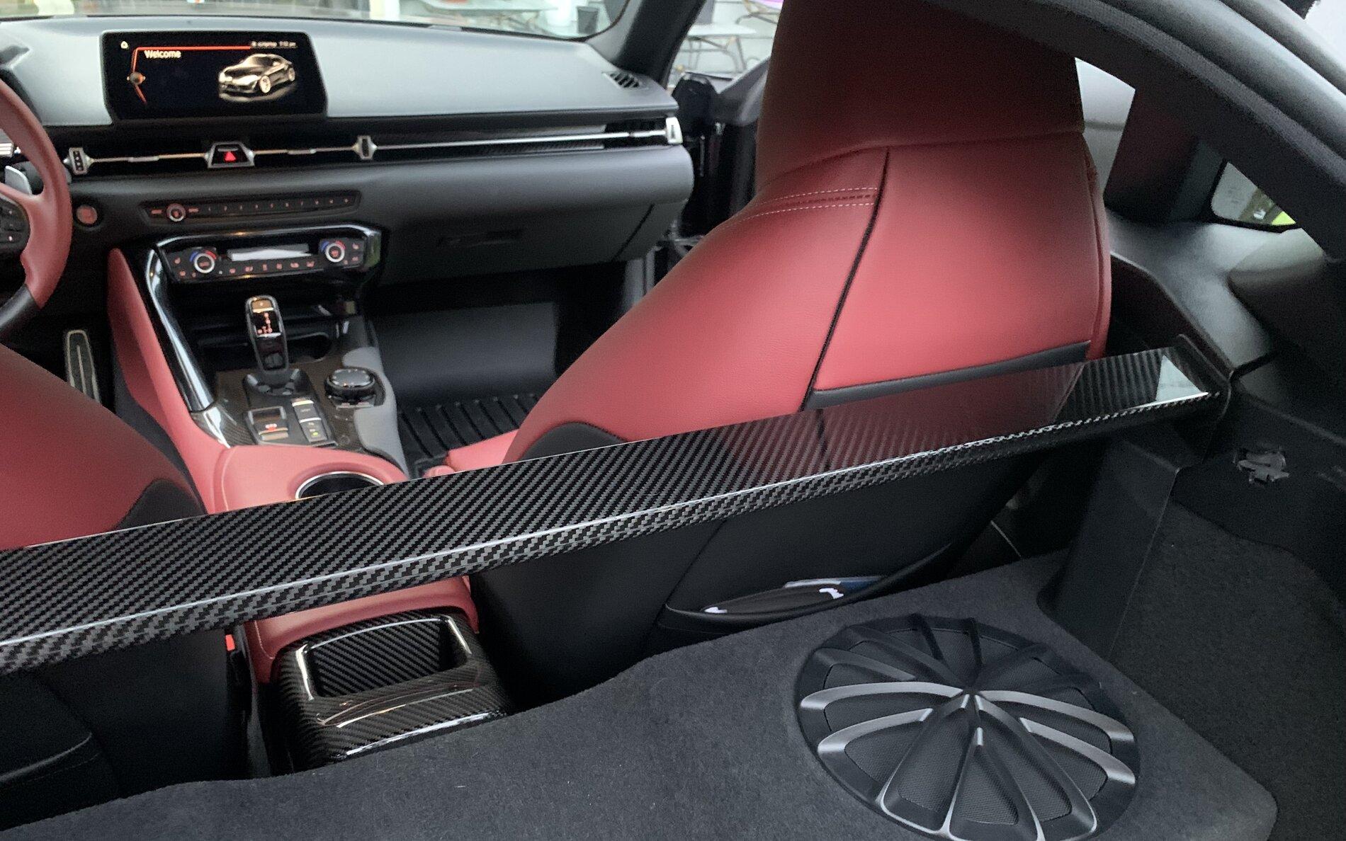

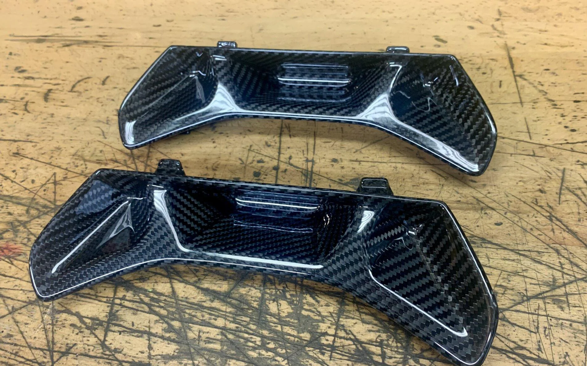

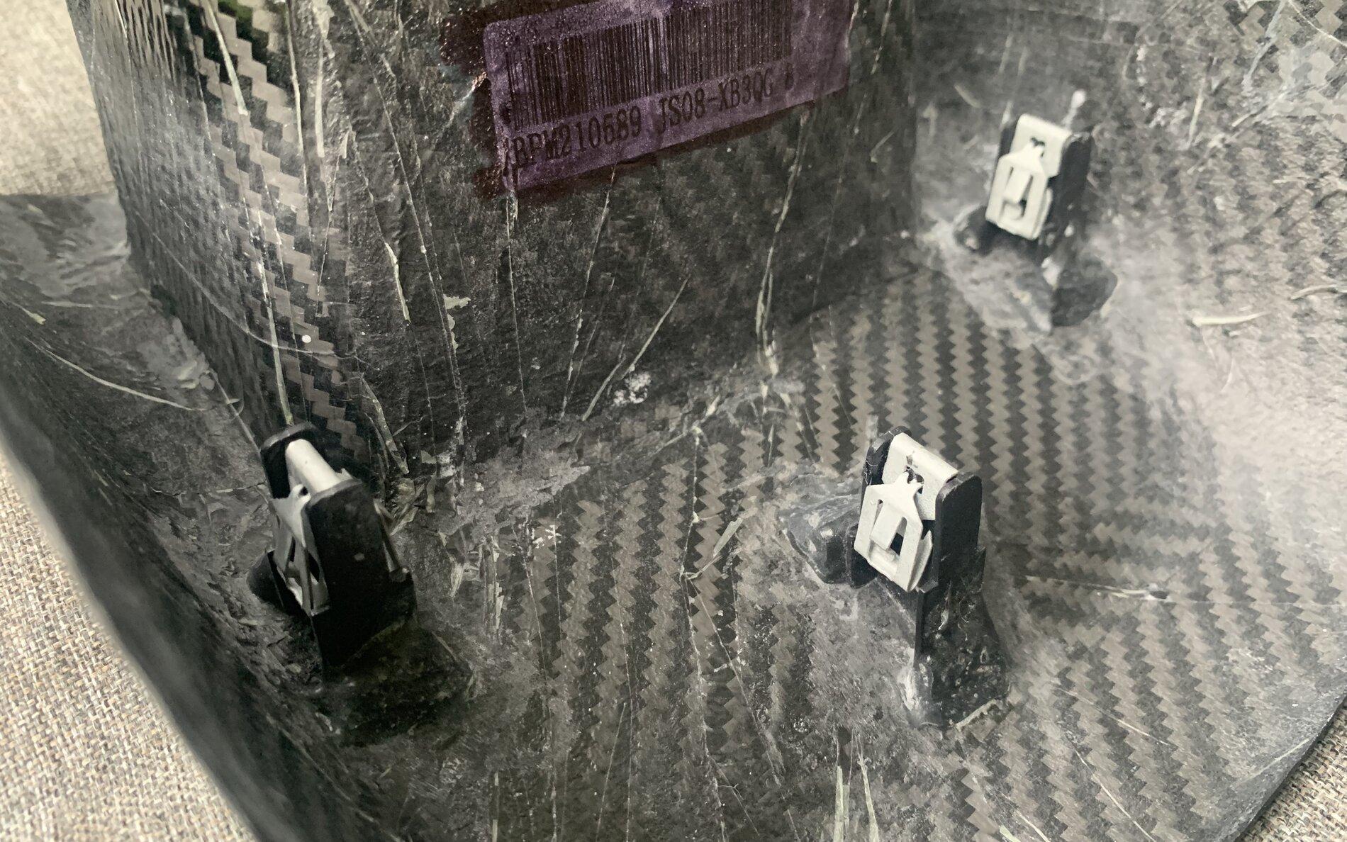

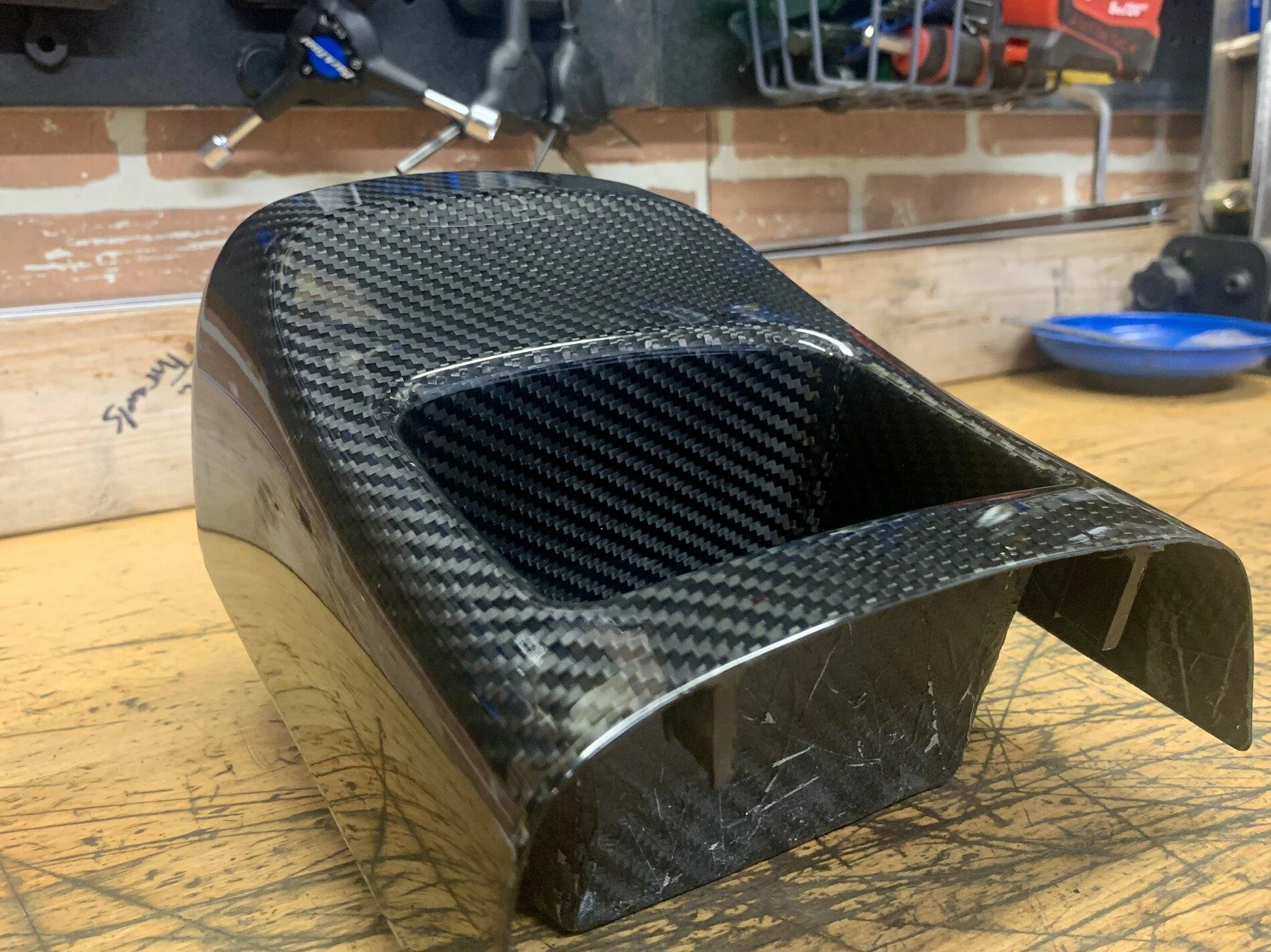

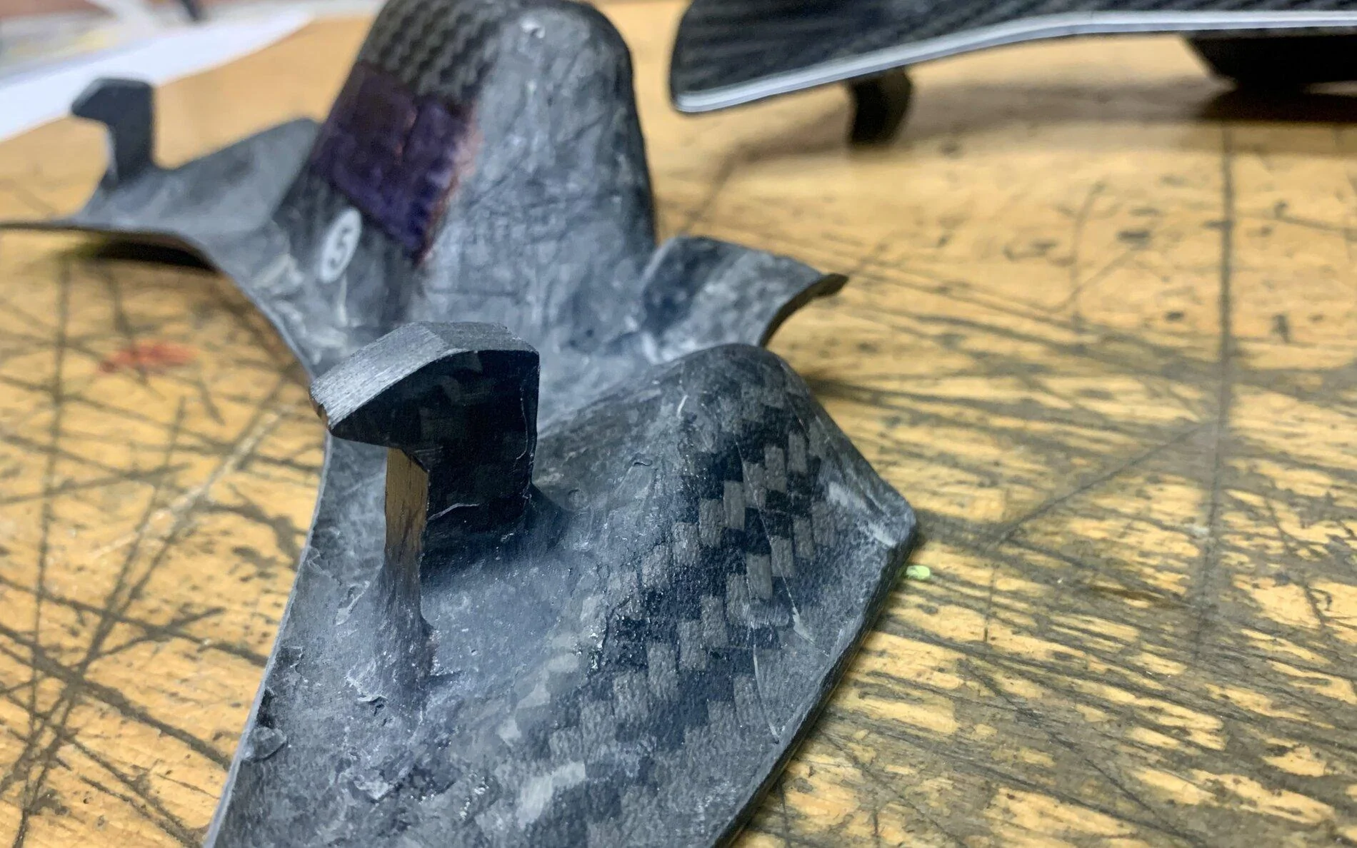

I installed three parts from NV Specialties yesterday, including the carbon seat inserts, carbon change cubby, and carbon transverse bar. All three are replacements, not add-on covers that go over the top of the original. The outward faces of the parts are finished extremely well; glossy with no imperfections and pretty much matches the stock carbon as well. If you flip the parts over you can see the telltale vacuum bagging lines and where they've bonded the hooks to the backside.
I've seen a ton of carbon over the years and while none of these parts are of structural importance, it's nice to see that they're still manufactured with a ton of care. Installation for all three was super easy and while the parts aren't exactly inexpensive, they really change the interior look of the Supra.

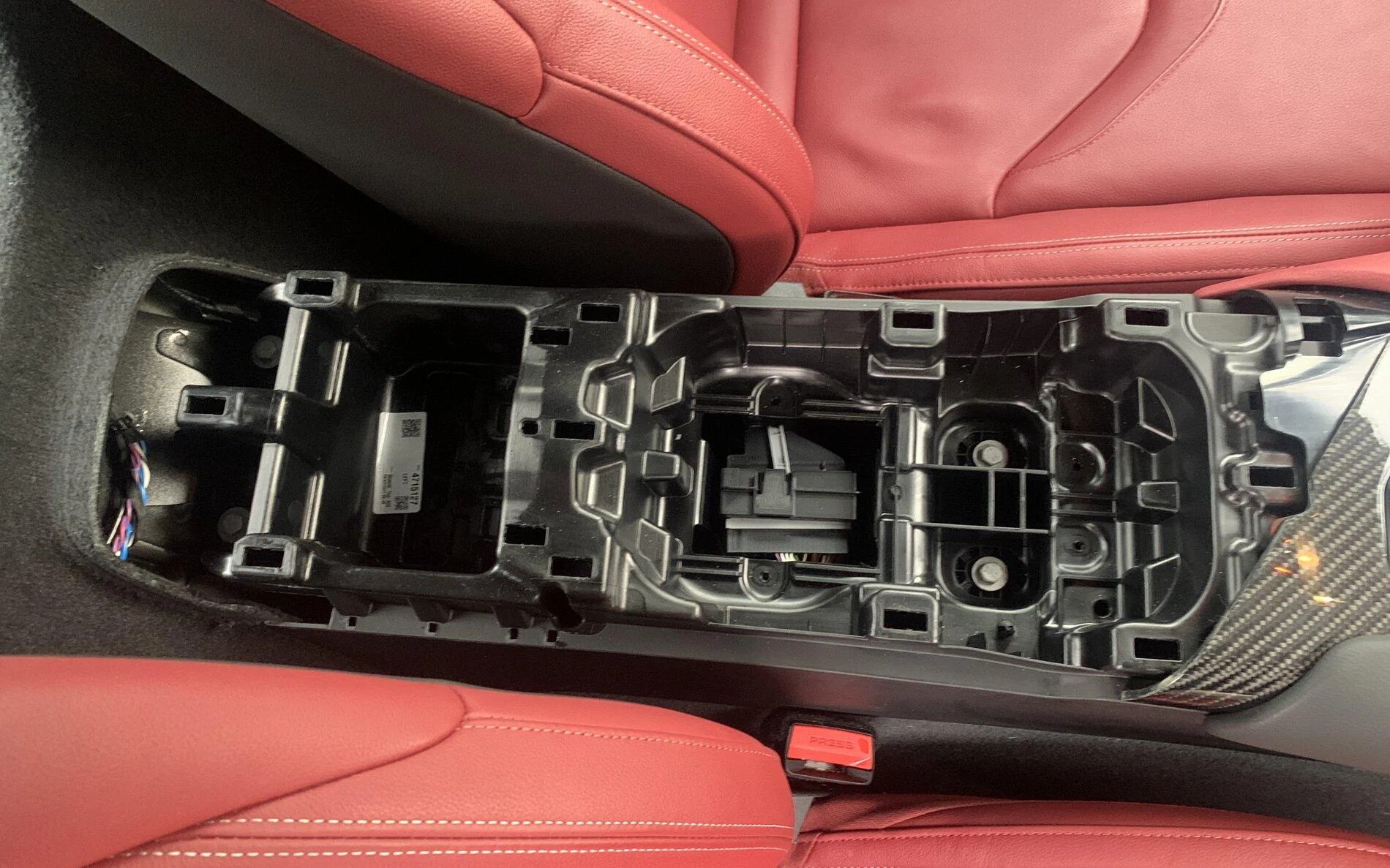

For the cubby, all you need to do is remove the center console cover (two T20 torx screws under the cup holders and some clips) to pull off the original part. You don't need to swap the gator clips to the new cubby, but it fits a bit loose if you don't take the time to swap the clips over to the new cubby's posts. Make sure to also swap over the rubber bottom to the new cubby so stuff doesn't rattle in it. This job takes fifteen ten minutes or so.

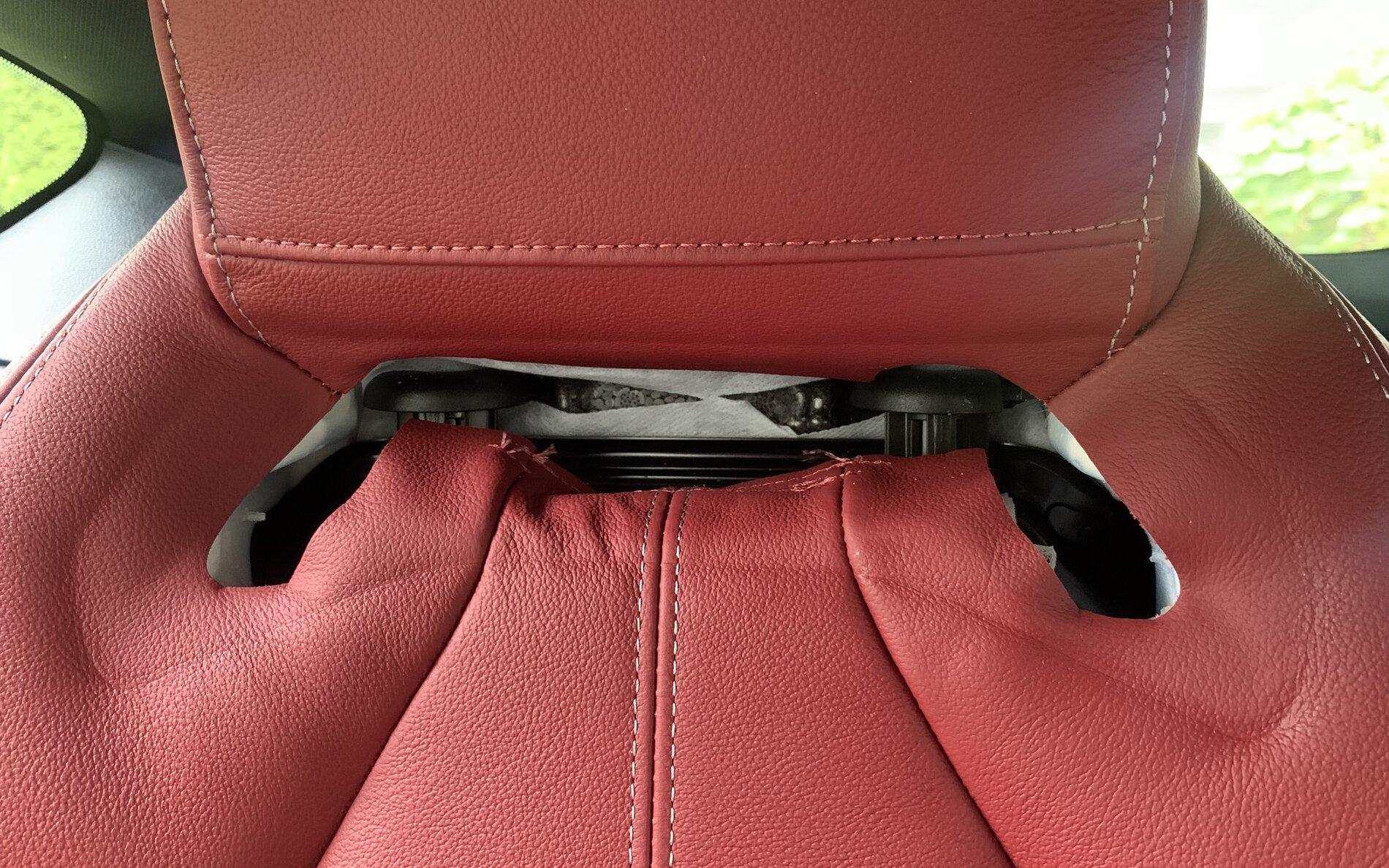

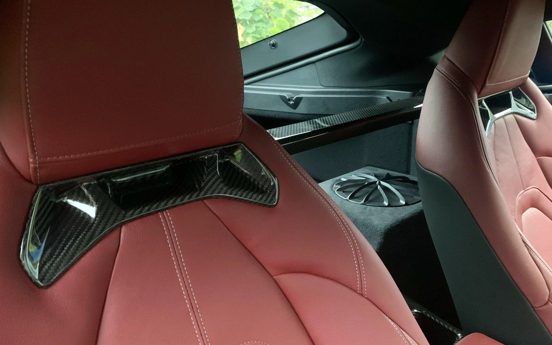

For the seat inserts, it's just a matter of using your thumbs to push the seat in enough to pop off the original inserts. NV Specialties has bonded hooks onto the new inserts and you only need to reverse the technique to install the new pieces. This job takes ten minutes. It also reveals some poor stitching where you normally wouldn't be able to spot it.

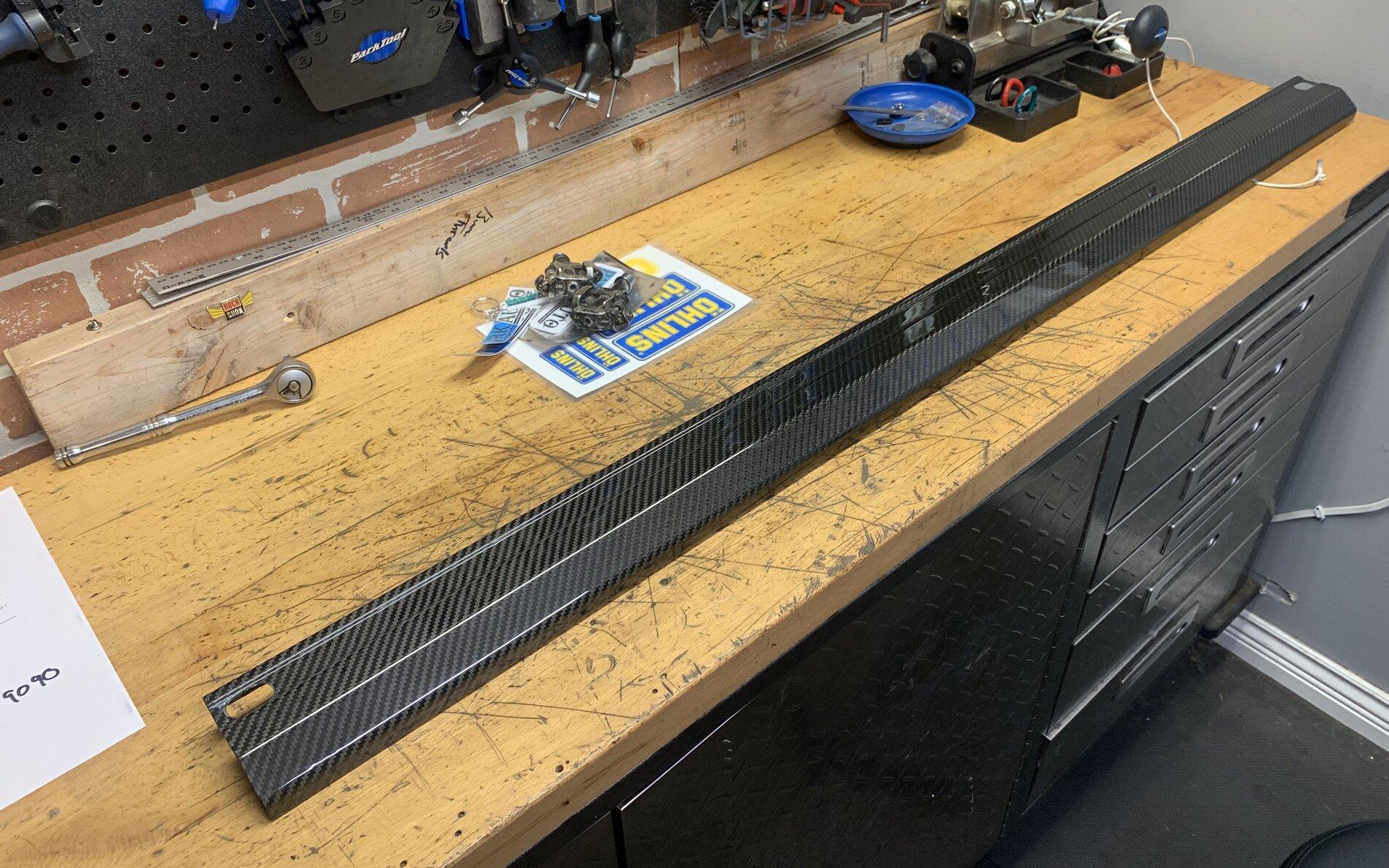

For the transverse bar, you only need to remove two trim pieces near the seatbelt anchor (detailed in other posts on this forum) on each side and then use that big ol' t50 torx bit to remove the fixing bolts. These were barely hand tight on my car - I could have removed them by hand if I could have grabbed the bolt. The NV Specialties transverse bar weighs about 1/4 of the stock aluminum one, but I'm positive that neither has any effect on the car's performance. It sure does look good, though. If you pick one up, make sure to also swap over the angled rubbered gasket on each side, as well as the plastic bushing for each bolt hole.
Obviously, none of this stuff changes how the car performs, but my goal was to make the cabin feel more like a supercar than a sports car. The carbon cubby makes it look like the entire tunnel is carbon fiber, and when you look through the car's side or front windows you see that, the carbon inserts, and the carbon transverse bar - I love it!

@Blindspot I got that cubby too. While subtle on mine since my interior is black, on your car the piece brings out a very nice contrast with the red. I think it's well done including your other pieces.
