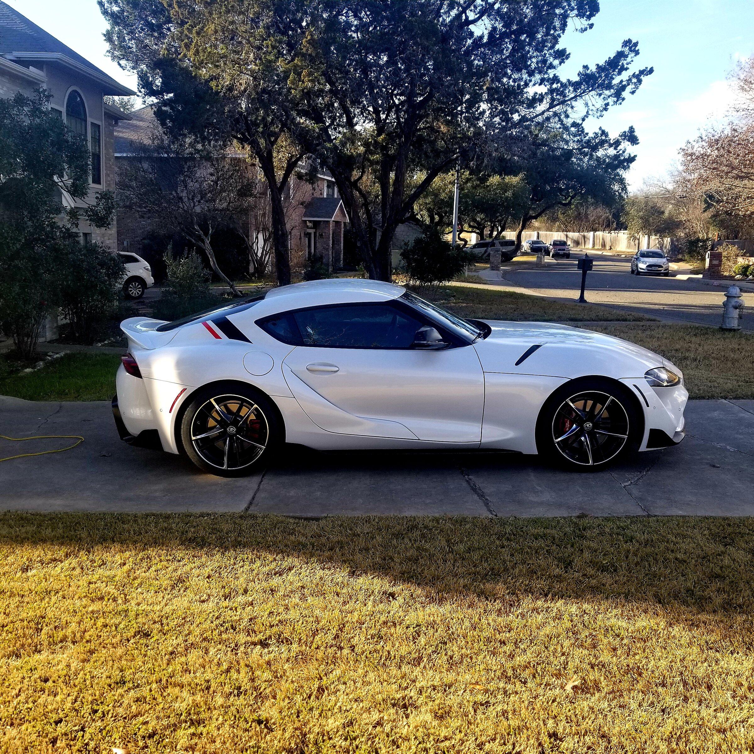

Had PhD Racing install my new bucket seat, harness bar, and harness along with SPL caster bushing and SPL rear toe links with lockouts.
WOW what a big difference. This car feels CONNECTED to the road now. Can’t wait to track it in a couple months.
