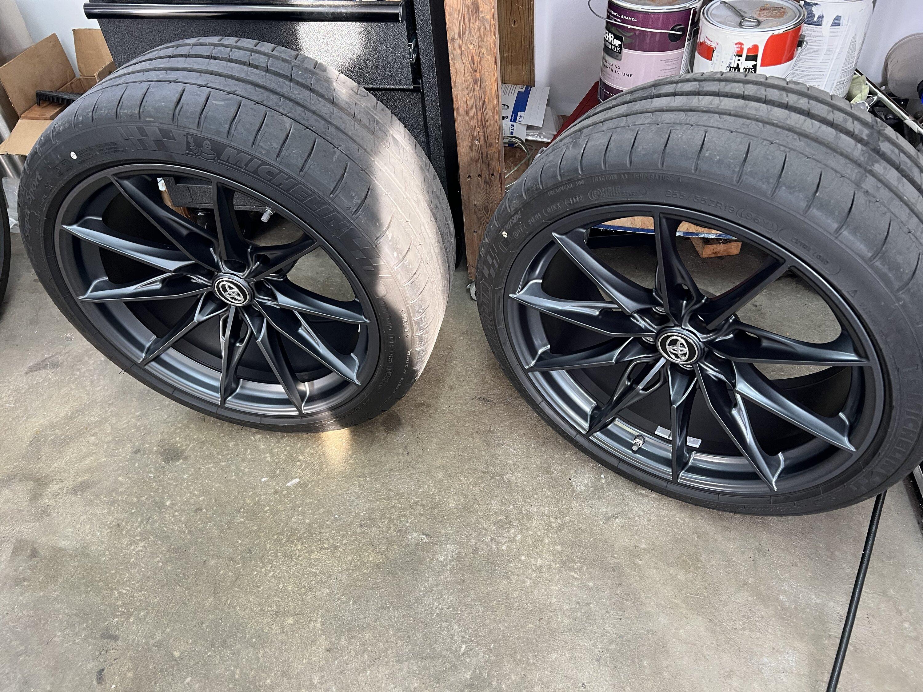

Beautiful wheels ? What size tires are you going to run and are you going to track her?

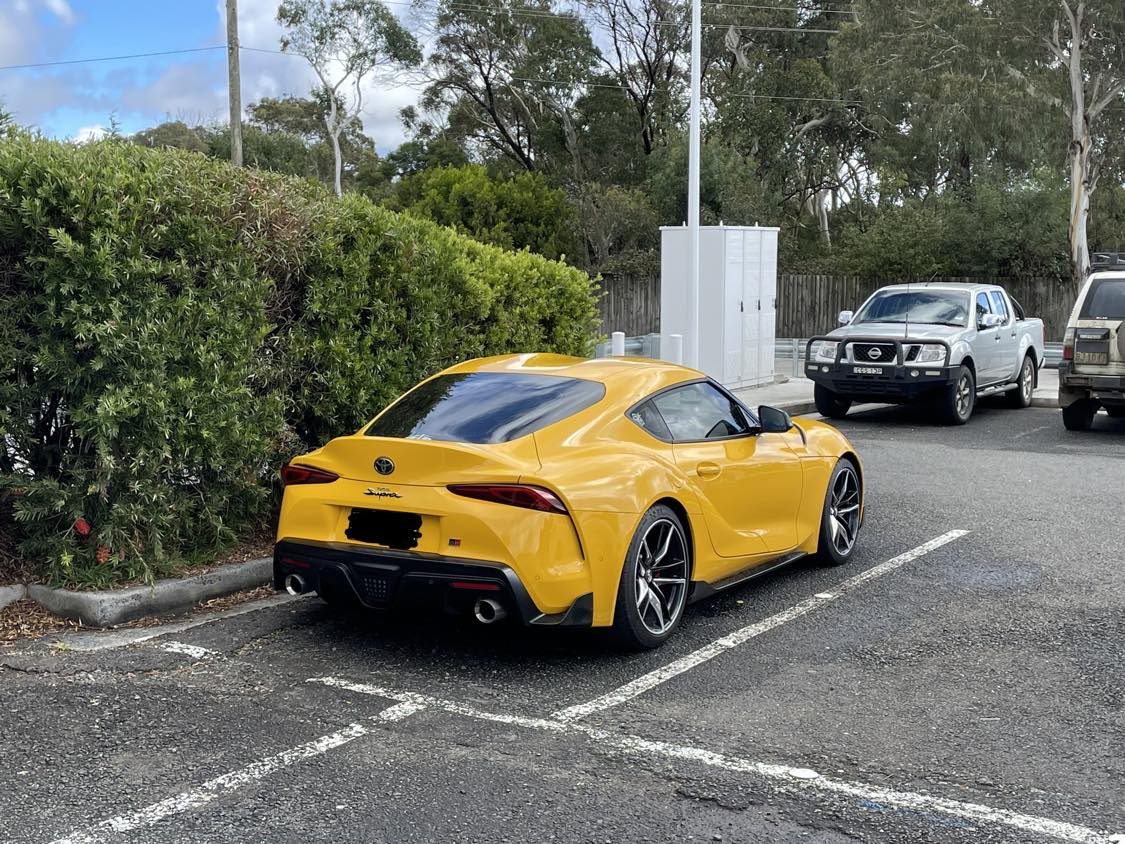

Picked up a (new-to-me) 2019 in yellow the other week, upgrading from my ND1 miata because I wanted more power :p First order of business was cleanup: Removing stickers and the rear Toyota text, bimmercode, dashcam install, wind deflector and hacking in Apple Carplay. It's still got 1.5 years of warranty so I don't want to touch power mods juuuuuuust yet although I'm very tempted to go tune it.
I'm noticing a bit of wheel hop sometimes when flooring it in 1st/2nd in a straight line as the turbo kicks in and the rear tires break traction, depending on the road conditions (significantly more likely to happen in the wet). Would people recommend the SPL rear traction arms to mitigate this? Does it get better or worse with more power? I'm also seeing rear subframe anti-vibration inserts + twisted tuning's diff brace kit (out of stock :() which could help stiffen the rear end up and help it slide smoothly instead of hopping.
Obligatory pic of my car attached, from the drive home after picking it up
SPL parts yes ?? But talk to your dealer 1st. They made mine very uncomfortable. So just some care if you expect/want to do all your service with them.
