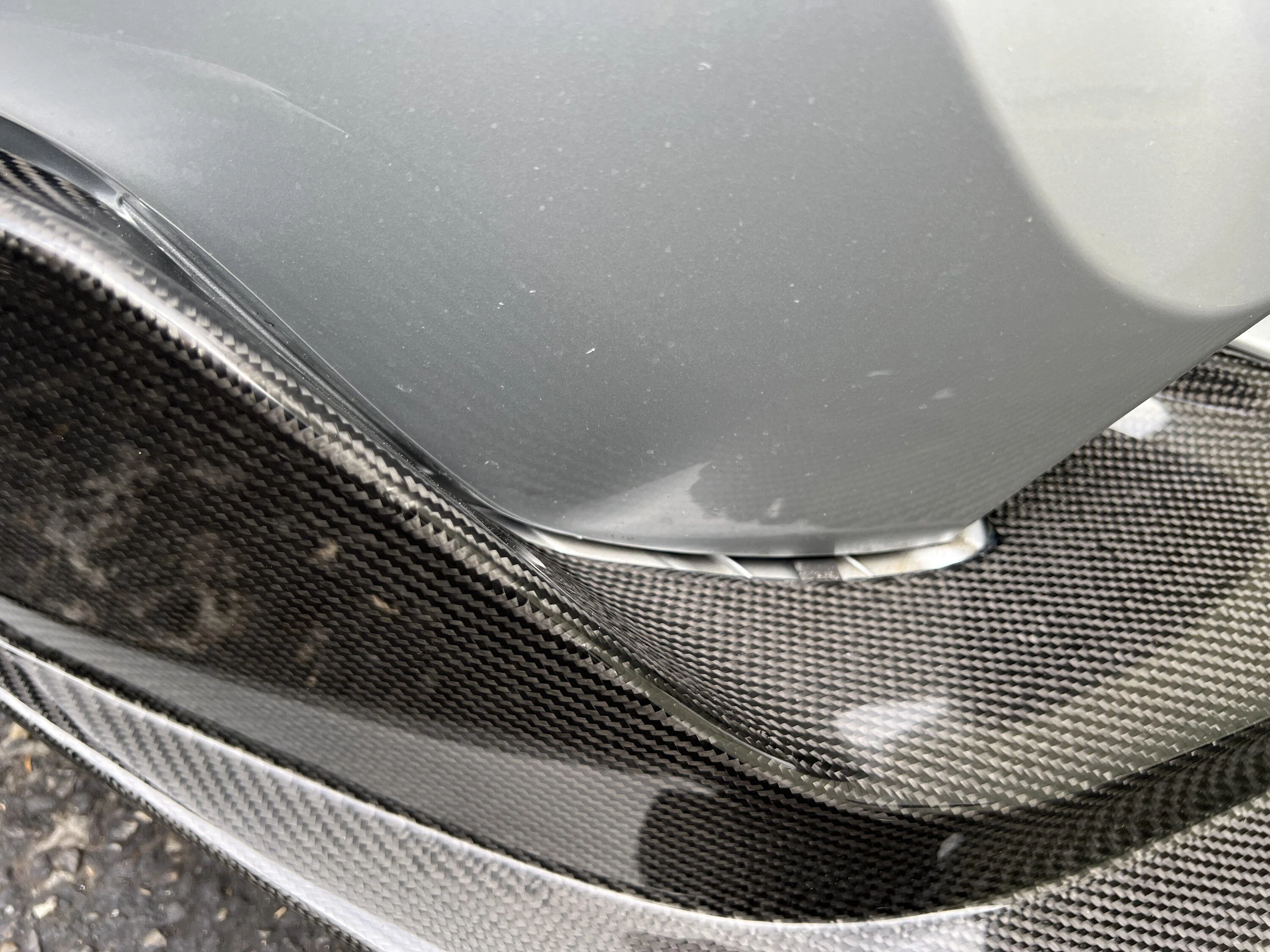

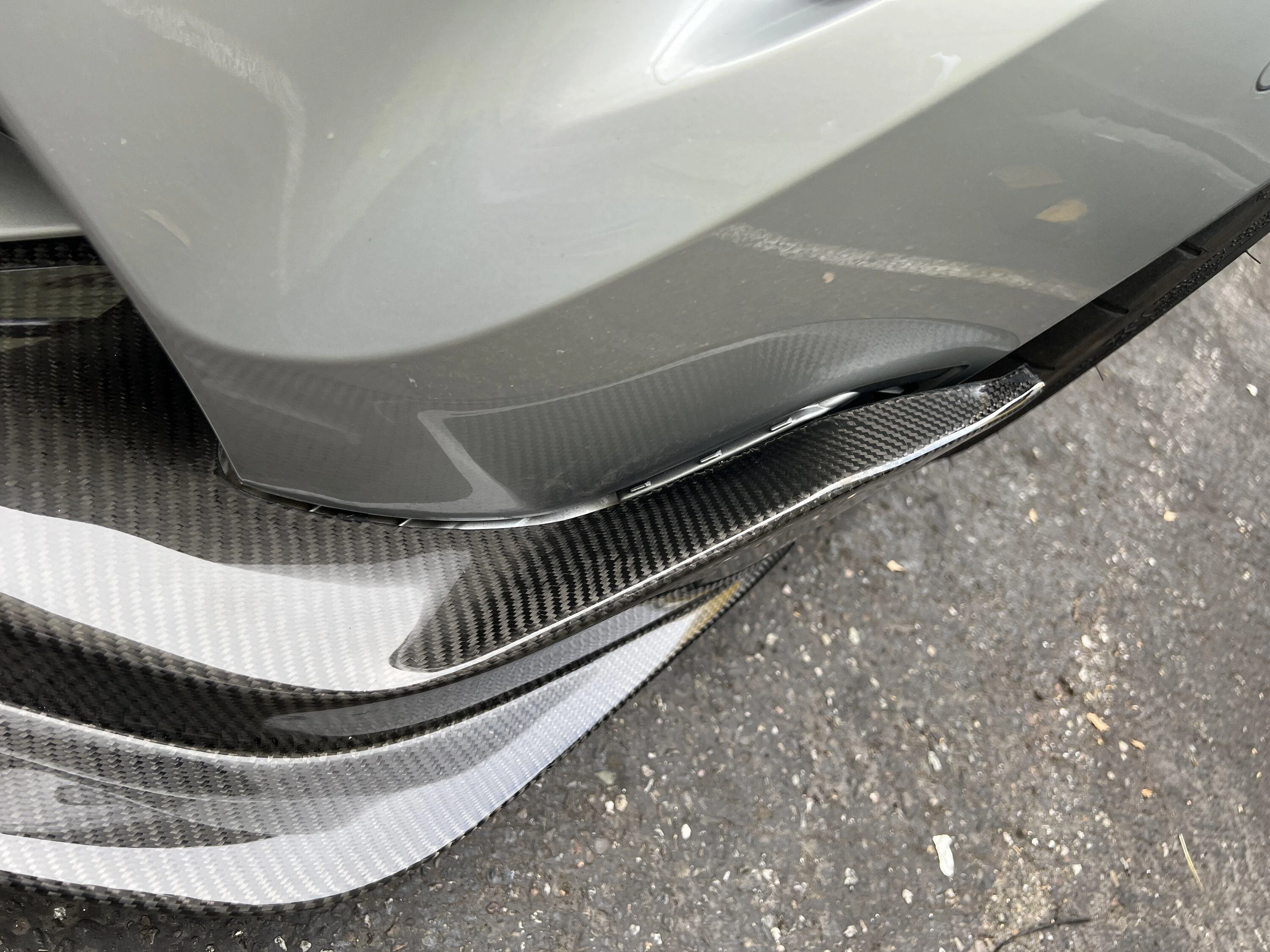

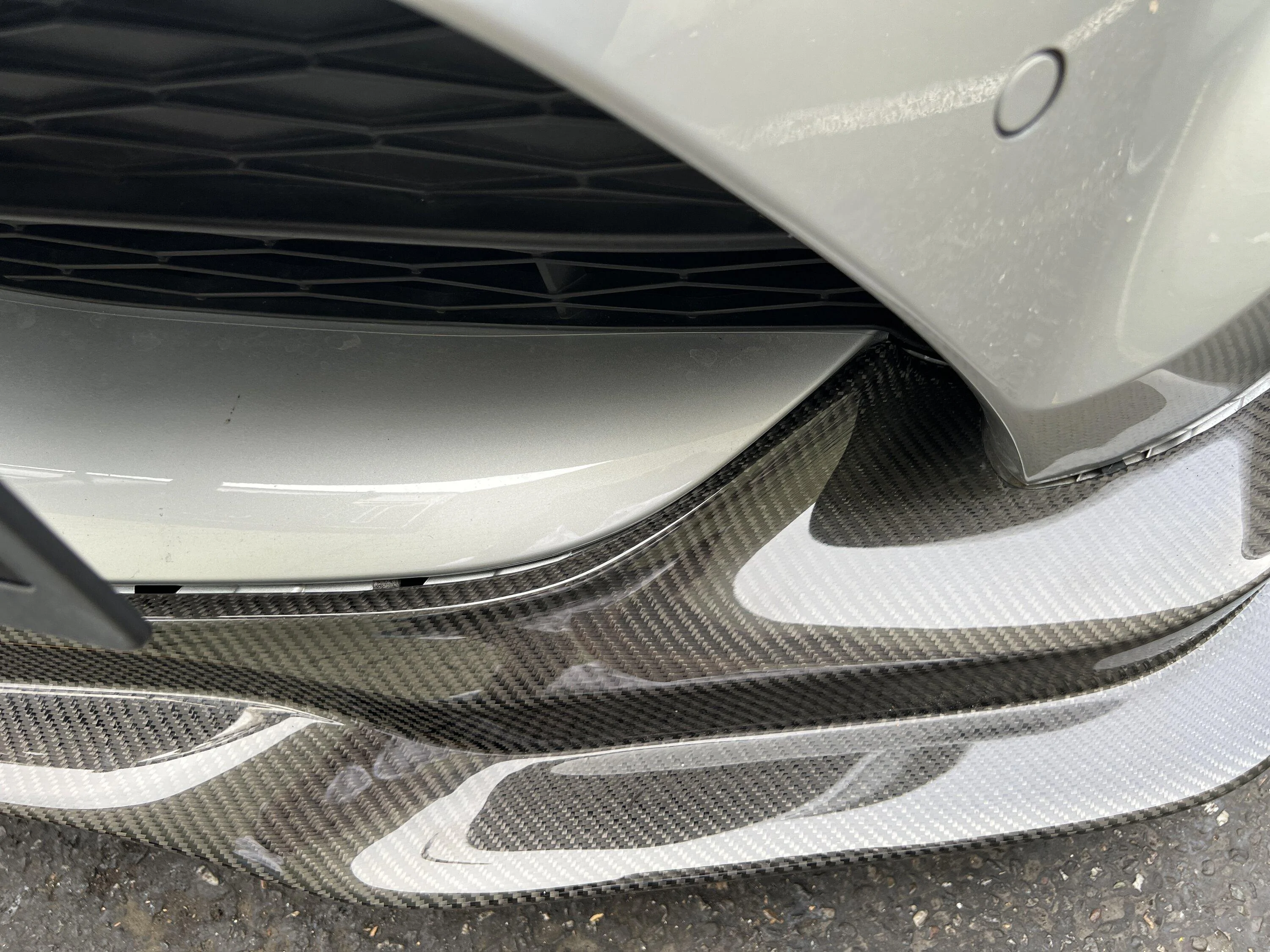

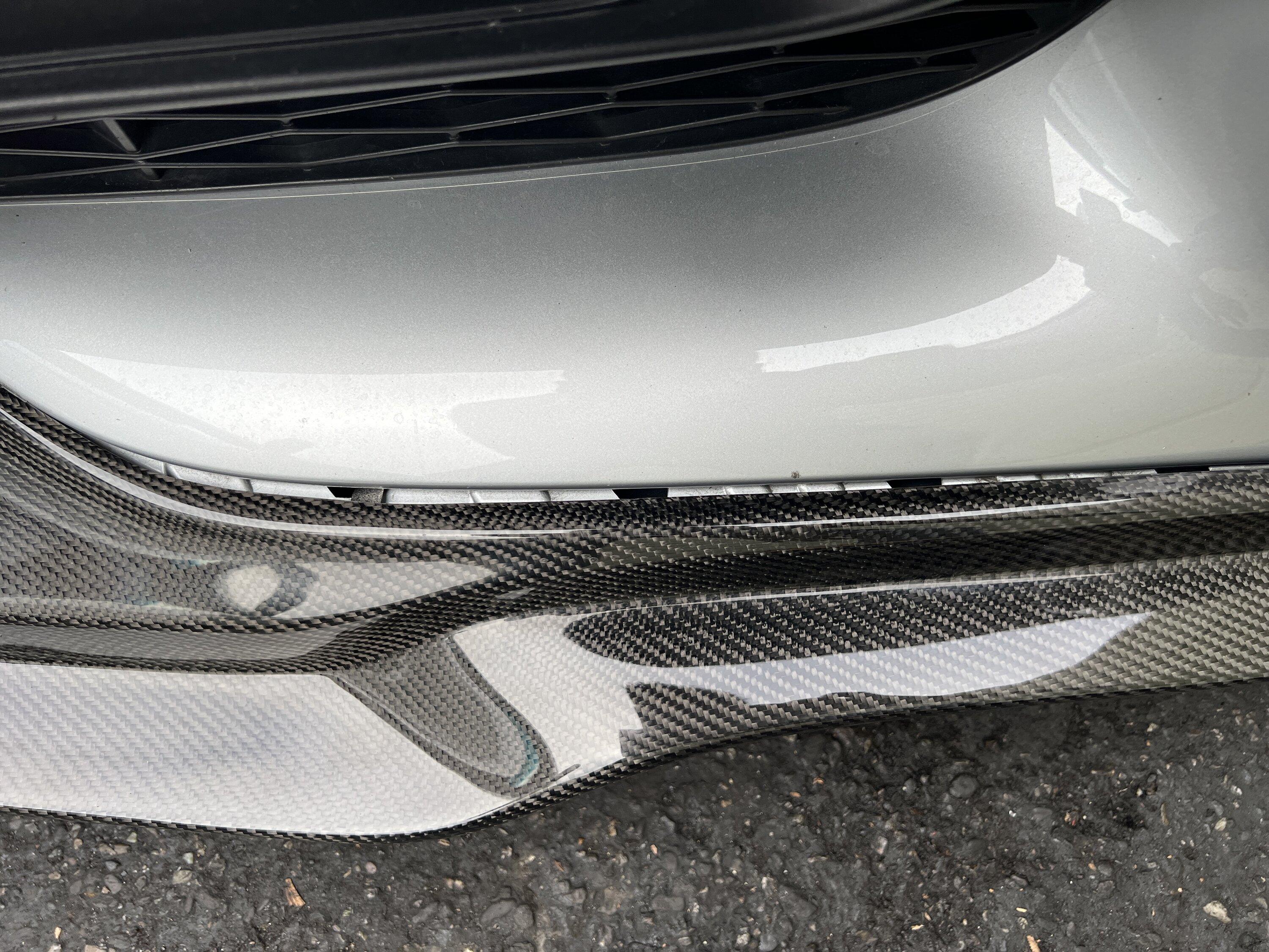

Installed the seibon mb style lip.
It fits not good at all.
Sigh!
To get the fitment correct there is some trimming that needs to be done on the inside of the bumper and those metal tables need to be bent to secure it. Reach out to seibon and they'll send you installation guide.

Man once you get that fitment right, that’s the best looking splitter I’ve seen. Do you track? Is this solely for looks or will it provide some extra downforce?

I had this happen with my lip. Pulled it back off, cleaned off the tape, and applied new tape about 1/2in to 3/4in further back. Fit like a glove.
edit: I also used a thinner 3M tape. Maybe the thinner tape was the actual fix...

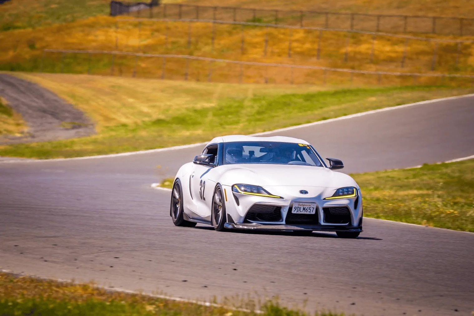

I Was gonna get those but got the Ms+ ones instead, I was afraid of quality but I guess they’re the same ones..
Let me know how they hold up please
Track duty they held up fine!
