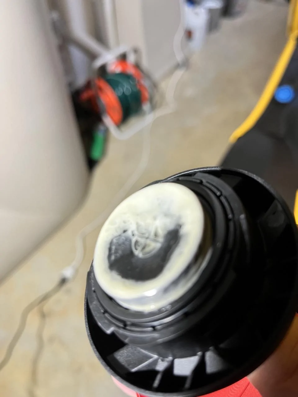

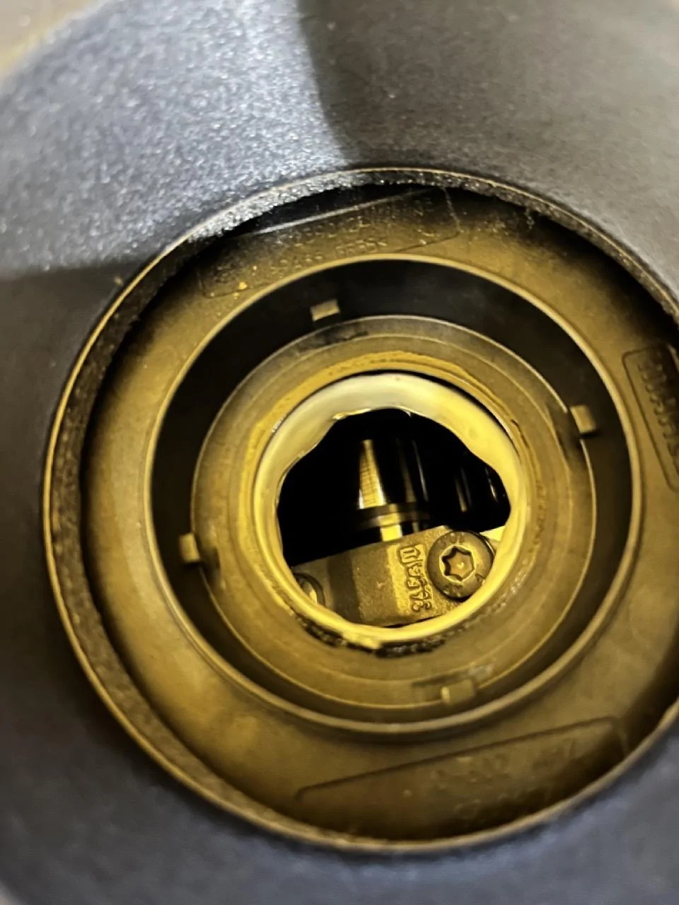

Umm.. I took my oil cap off and this is what I saw. ?

This car is new.. as in 33km on the odometer new.
Just make sure your cap has a good seal. It should be a natural buildup of moisture, especially being so new, not driven much or for a longer period.
https://mechanicbase.com/engine/milky-oil-cap/
https://autooilandfluid.com/milky-oil-cap/
Just a sample of what‘s out there ☝. I got my 1st oil change extra early, since I track a lot, live in an extremely hot climate and wanted a wee bit thicker oil. Check it again after a much longer drive. Yours sat for quite some time. But glad you finally got her!
Yeah.. I'm fairly confdent its moisture buildup. The seal seems ok too and the coolant level is slightly over max so it should be ok. My plan is to wipe it down and clean the muck off and then go for a Sunday drive and see how she responds.
Yep, was about to mention check the coolant level. Probably already on your to-do list but I’d change the oil as soon as you can just from being a used car. This would just add a reason to do the change.
Yeah. I might hit up the dealer and see what they say too. Appreciate all the advice and input. :)

Hopefully not. I think its just build up of condensation as she's literally come straight off the boat! Also, it looks clean past the cap. But yeah.. not sure. FML. Hopefully get some advice here and/or hit up the dealer. ?
Dude, it's totally just condensation buildup. Wipe it off, and put some kilometers on the damn car. Don't worry about it at all.
