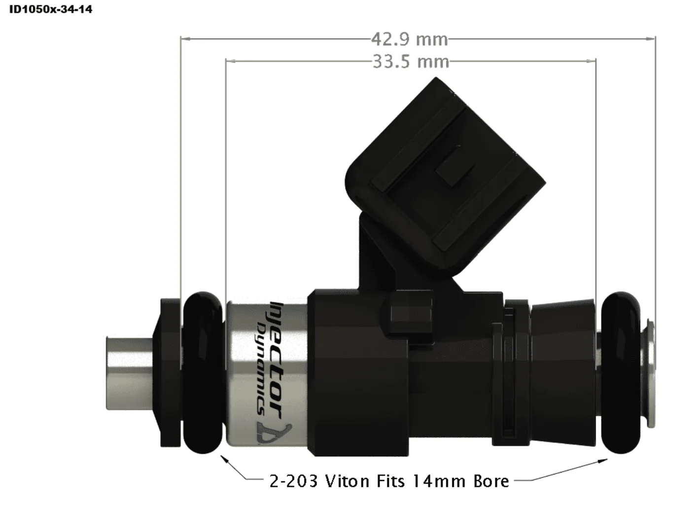

I’ve got a set of 48mm ID1050s. Will they work with the EOS plate or is the 34mm body the max size?

Have a 6 port oem turbo unlocked bm3, e50+dp. I plan on going port injection to run full e85. What size injectors are recommended? 550? 750? 950? 1000? 1050?
It all depends on your power goals for the car. Start with a goal and then you can do some calculations to determine what is the best size injectors. Do you plan to upgrade turbo, all those factors adds up.
As for injector sizes, here are some calculations/estimates:
550cc ~ 774whp
750cc ~ 885whp
950cc ~ 995whp
1000cc ~ 1022whp
1050cc ~ 1050whp
1300cc ~ 1188whp
1700cc ~ 1409whp
For reliability, you do not want to run greater than 90% duty cycle (85% is a good max DC).
With LPFP kit upgrades, you can adjust the aftermarket fuel pressure regulator to bump the fuel pressure up and get some more headroom on the injectors.
The injector size that works on most PI plates and manifolds are IDX1050.34.14.14 (for example)
Hopefully this helps
