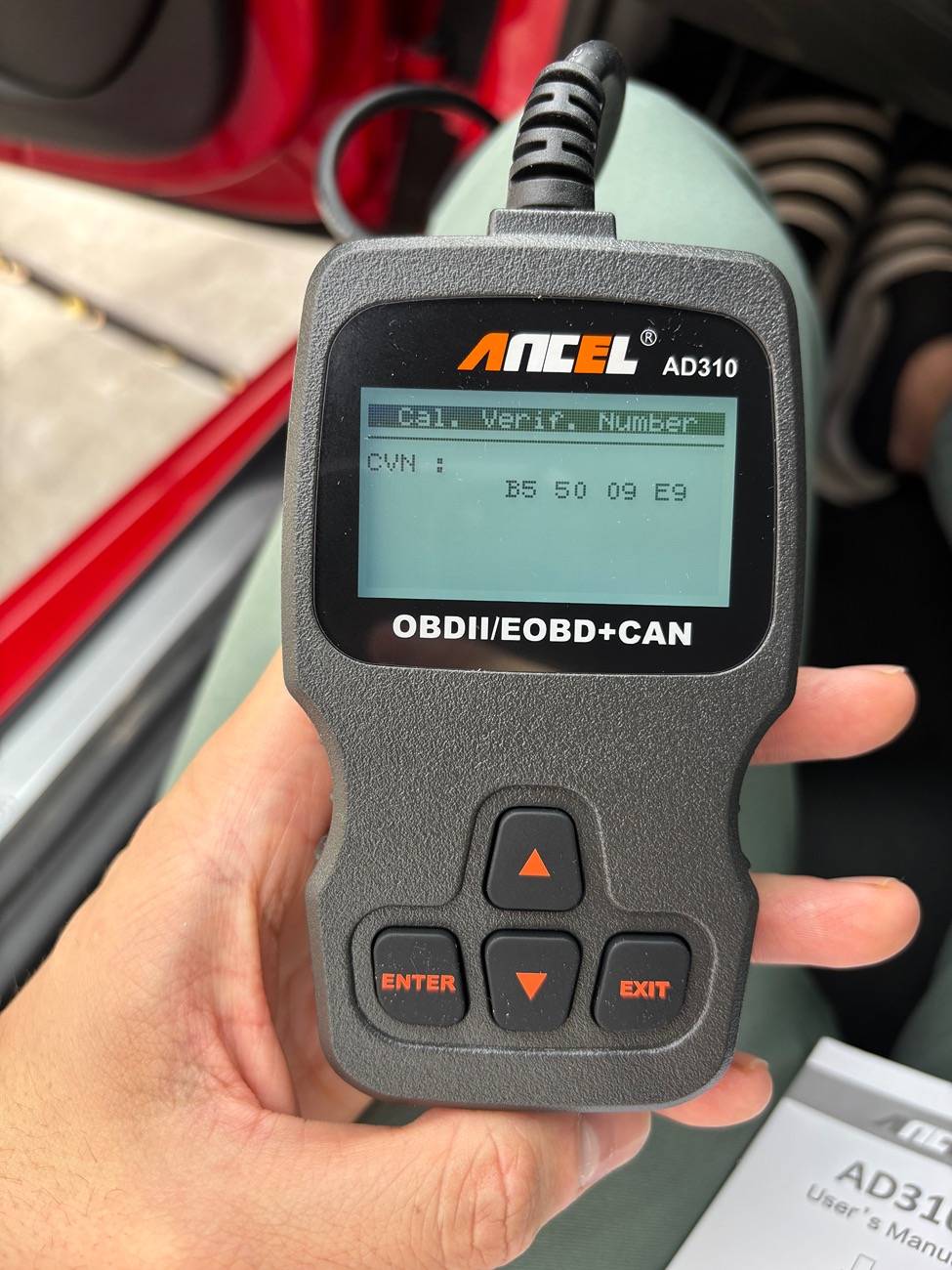

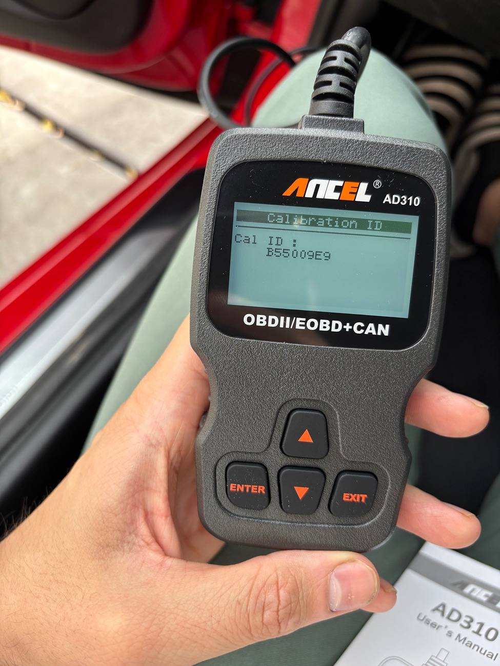

Would anyone know if the CAL and CVN I’m getting with the OBD reader is stock or is my ECU tuned? Been trying to google this info with no luck

A few years ago they implemented checking the ECUs for a tune
https://www.roadandtrack.com/news/a37022836/california-ecu-tune-during-smog-checks/

Evo and STI guys in years past have been passing smogs with tunes and a different CID/CVN but in the last few years, people with tunes that passed smog have been getting a notice to report to a state referee for inspection because the CID/CVN did not match. This comes after they've already passed their bi-annual inspection.
And no, the stock flash on an unlocked ECU will not match up with the registered CID/CVN with CARB.

It's not a lot of work...car manufacturers submitted OEM CID/CVN and what not. BAR adds it to their database. Car gets smog'd and if it doesn't match, then it doesn't match. Pretty simple.

My ecu is unlocked and fully tuned. (MHD interface with bootmod software if that helps)
Got it. Probably keeps CVN intact. If not, you might also get reffed in the mail. I've had friends that have had that happen to months after a "passing" smog test.

There’s another thread where someone had an unlocked DME and flashed back to stock but the numbers didn’t match up.
From what I’ve seen the non matching ECU CVNs doesn’t always get flagged for a state ref. I don’t know what the criteria they’re going off of but some people get away with it and some don’t.
When I found out this was happening a few years ago, I’ve been flashing my Evo back to stock for every STAR test and luckily my guy is chill so I haven’t had any issues with anything.
