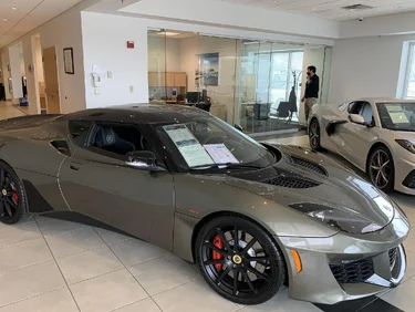

They really pick up sound and power with catless downpipe.
Why did you sell Evora? I was just looking at one this week

No way I should be looking at a third track toy. Lol. Was in a dealership with family member suv shopping and they had this sitting there. Really looked hot in person
