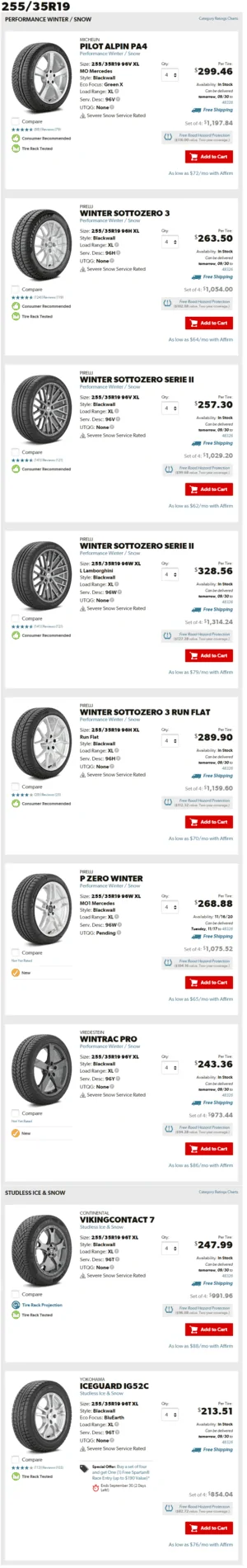

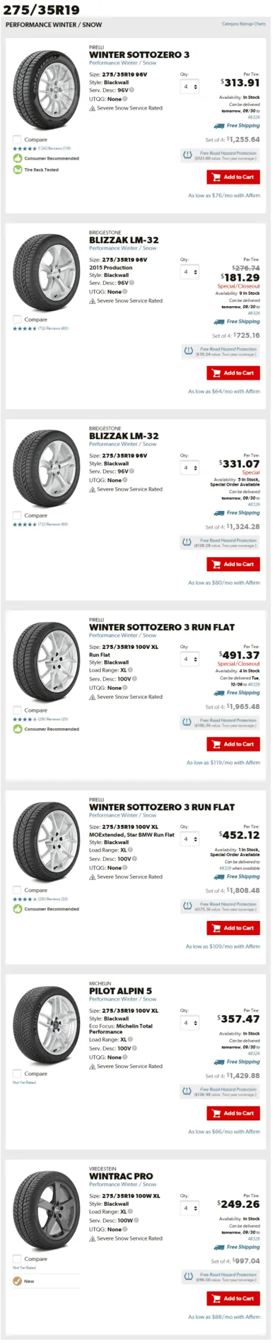

Question, I found these tires on Tirerack, but they are telling me that they won't fit / are not available for the Supra and yet you are using the oem wheels? Where were you able to get them? Currently Tirerack and my local tires shops only have all seasons (such as continental extreme contact sport) available to fit the oem 19" wheels (3.0 Premium). Thank you so much!
Because of dual fitment, Tire Rack isn't showing proper options. Search them individually and you do get bunch of options.
For Conti I see VikingContact 7 for the fronts, no Conti for the rear. But @Raffi is right, Conti does make 860S for front & rear. I'm also not 100% if they still do so.
Judging by below pictures, the only option if you want same brand/model from TireRack is Pirelli Winter SottoZero 3, which I have 0 experience with.
