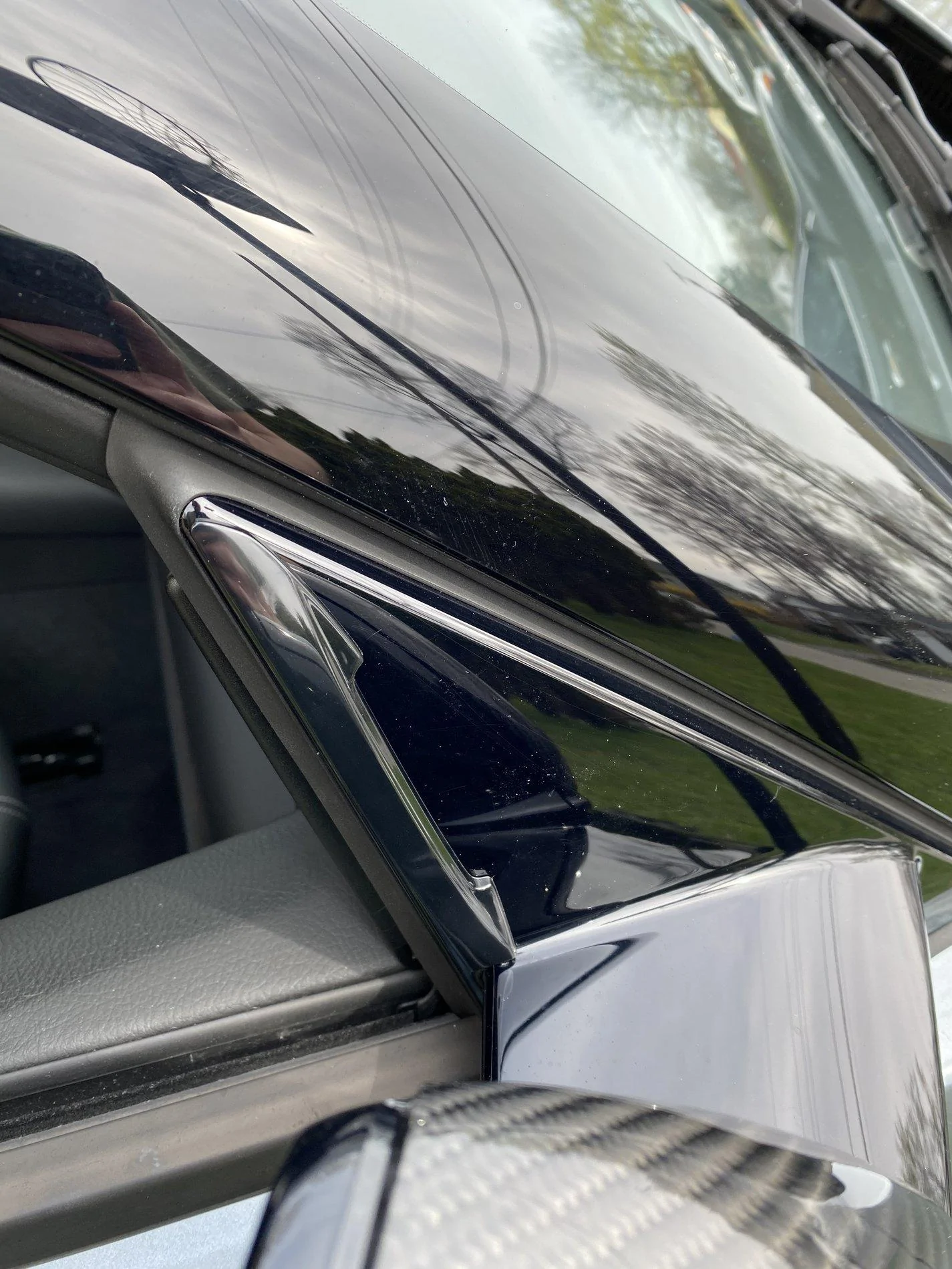

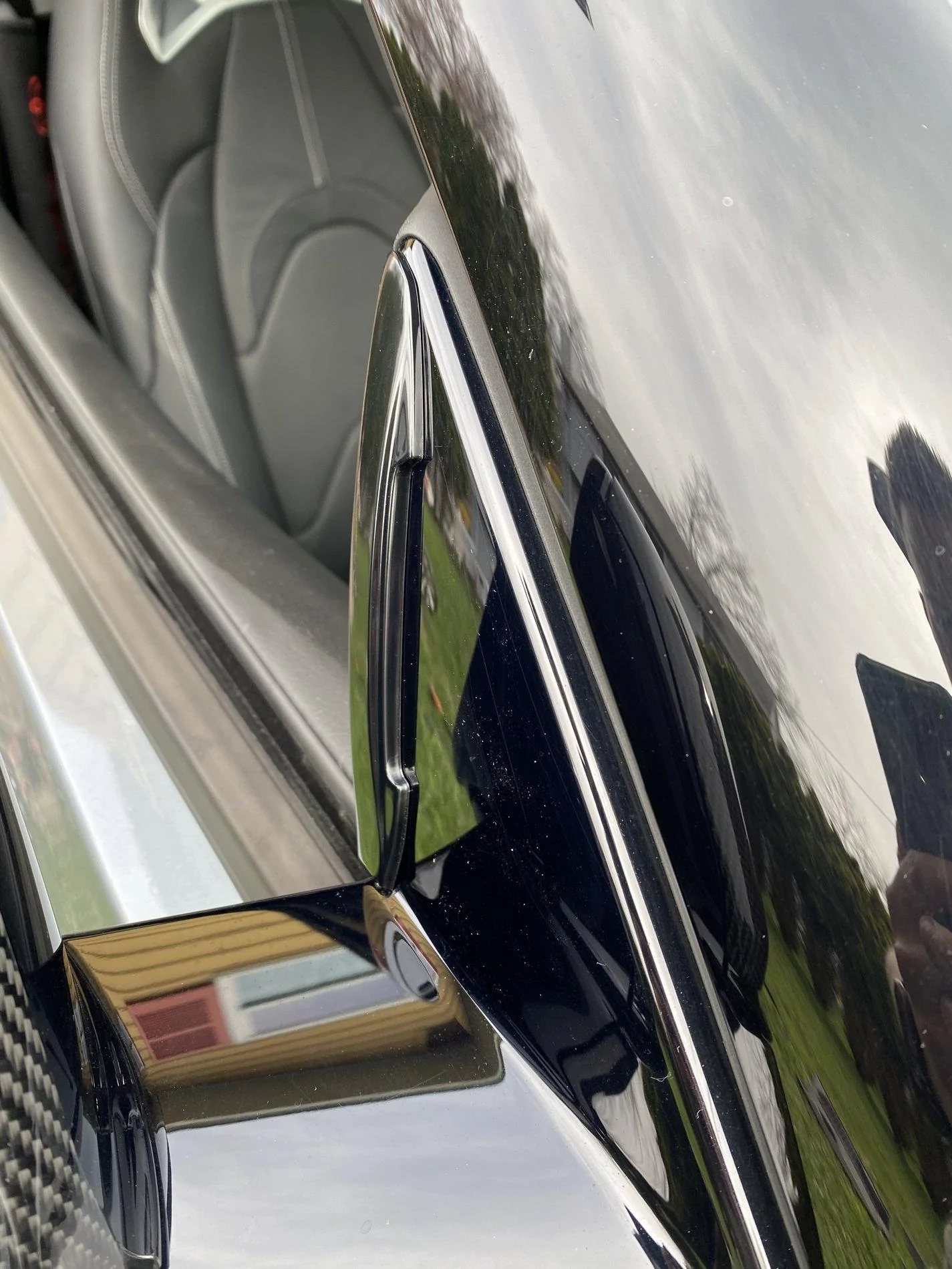

I know there is another topic for this elsewhere on the forums however I did not want this to get lost in the topic. This gained a ton of traction on the Facebook groups so I felt the need to post it here.
I found an extremely cheap fix (comparing to other products on the market) for the wind buffering issue. I used these door guards here on Amazon: Hypersonic Black Car Door Edge... https://www.amazon.com/dp/B01NCK6STT?ref=ppx_pop_mob_ap_share
The finish on these match the gloss black almost perfectly. Each set comes with 4 guards and 2 of them have no logo on them. All you have to do is slightly trim the bottom and stick them on (see photos). A few people also found carbon fiber door guards that worked.
I noticed that it does reduce the noise to nothing however at certain speeds and crosswinds you may hear it at times. But for less than $10... why not?
P.S. I am by no means affiliated with the product makers or any of the related products.

Thank You Anthony:headbang:

I did it on mine, (the Cheap Amazon way) I would say about 90%, the faster you go the more you notice, I am sure exact placement can become a factor.
For the money, It was well worth it. I have been wanting to cruise around on weekend mornings, and feel the cool air, now I can.

I just installed the $9 Hypersonic door edge guards. They transformed the car from having an intolerable amount of wind buffeting to having probably the most pleasant amount of air movement of any car I have ever owned. They are also completely unobtrusive and look like they belong there. There is one interesting caveat, however. With the driver window up and the passenger window down the buffeting, for whatever reason, is just as bad as before. Fortunately I never drive that way so it is of little consequence. Driver down, passenger up is my preferred style. This was possible before if you cracked the passenger window just the right amount which was an irritant. Now it's just driver down and go. Many thanks to CarGuy11.
