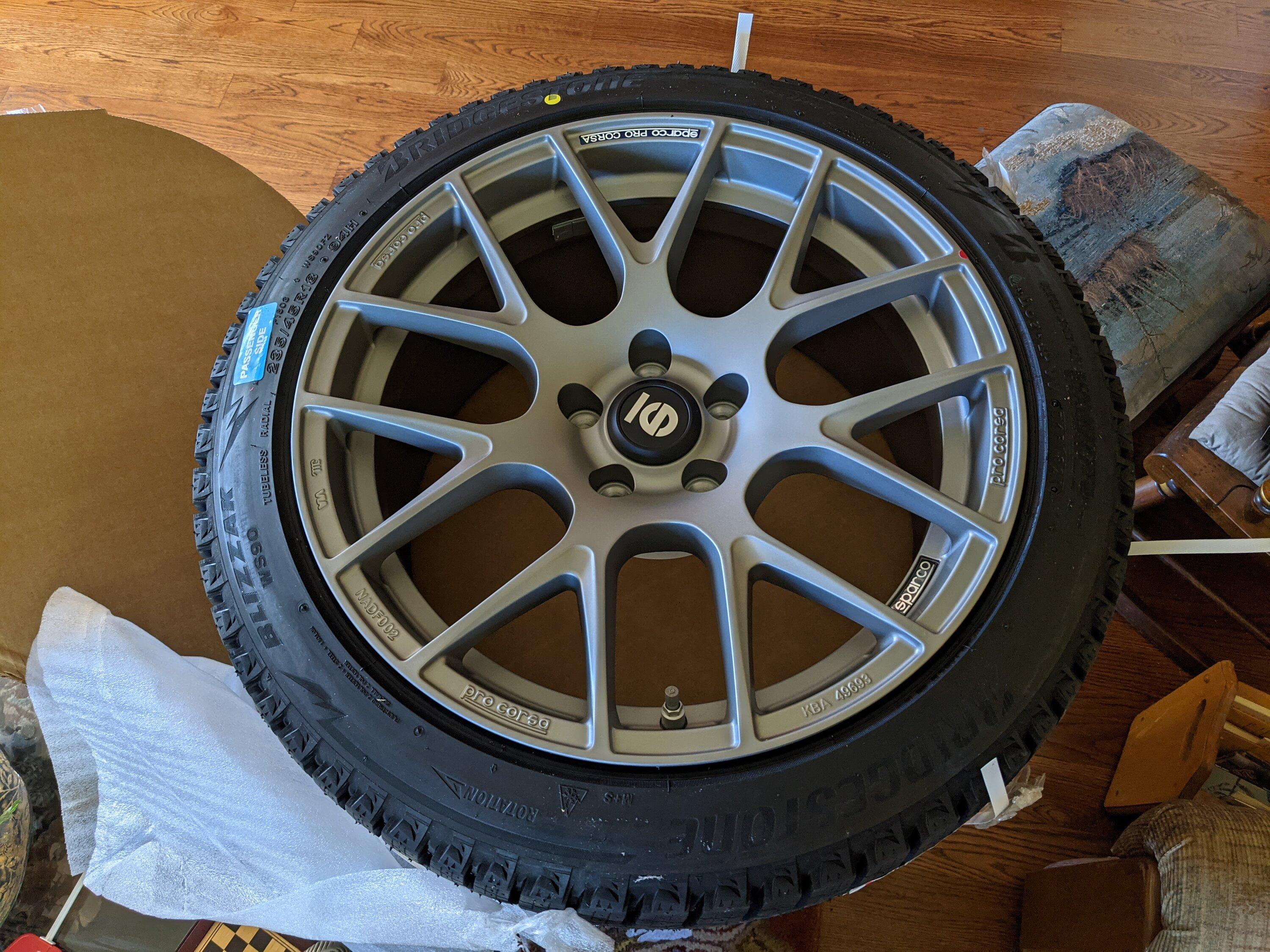

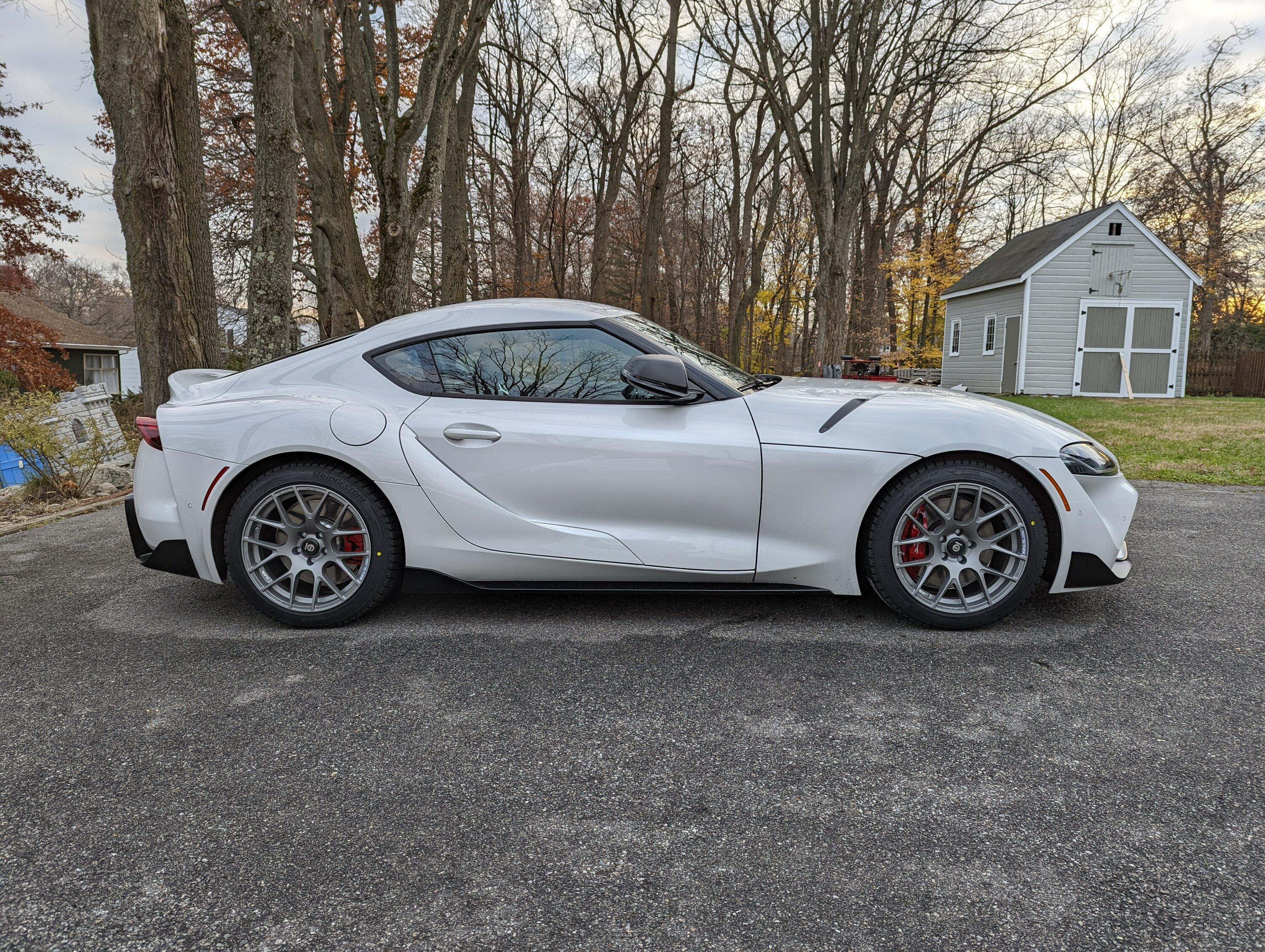

It seems like you're set on using the OEM wheels as winter wheels, but you may want to consider sizing down to get a little more sidewall on there. This is my set up.

And wow your winter setup looks awesome, do you have a link to those rims? what's the finish and specs on them? and are all 4 tires 235/45/18?
Yeah 235/45/18 all around
https://www.tirerack.com/wheels/sparco-pro-corsa-light-grey-painted
Hopefully the link brings you to the spec for our car.

hm it didn't, but when I entered the car information it recommended 18x9 ET29, is this he spec you ran for all 4? and fitment is good without any spacers?
Yeah thats exactly what I did. Just entered my car info and went with what they recommended. Yes that size all around and they fit perfectly with no spacers.
Also that tire size (235/45) was as close as I could get to the diameter of the stock tires so it wouldn't noticable throw off the speedo.

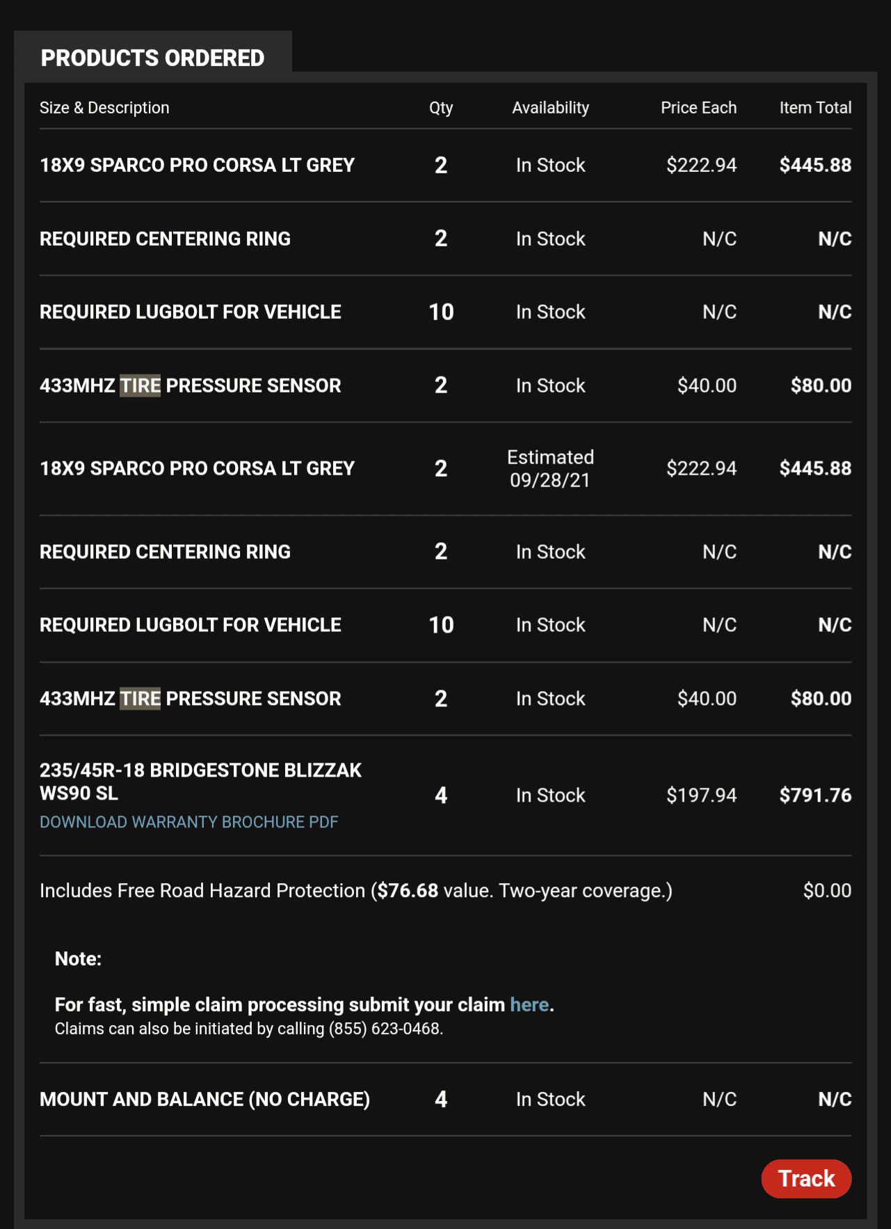

This was my actual order.
