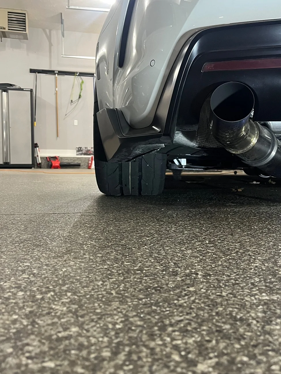

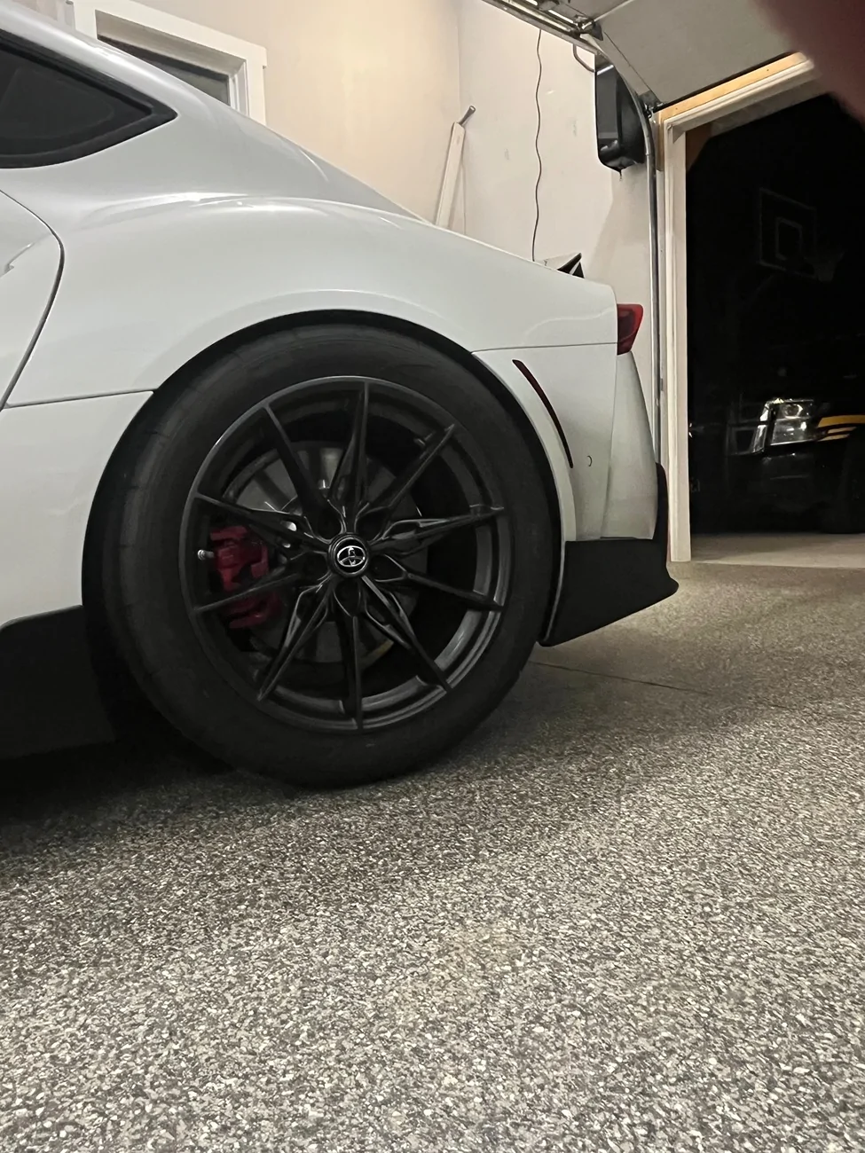

I run a stock wheel, Nitto 305, Swift springs and no spacers with ride on comfort with no rubbing. With 10mm spacers they rubbed when squatting on full throttle. If you’re going for handling stay away from a 305 on stock wheels
