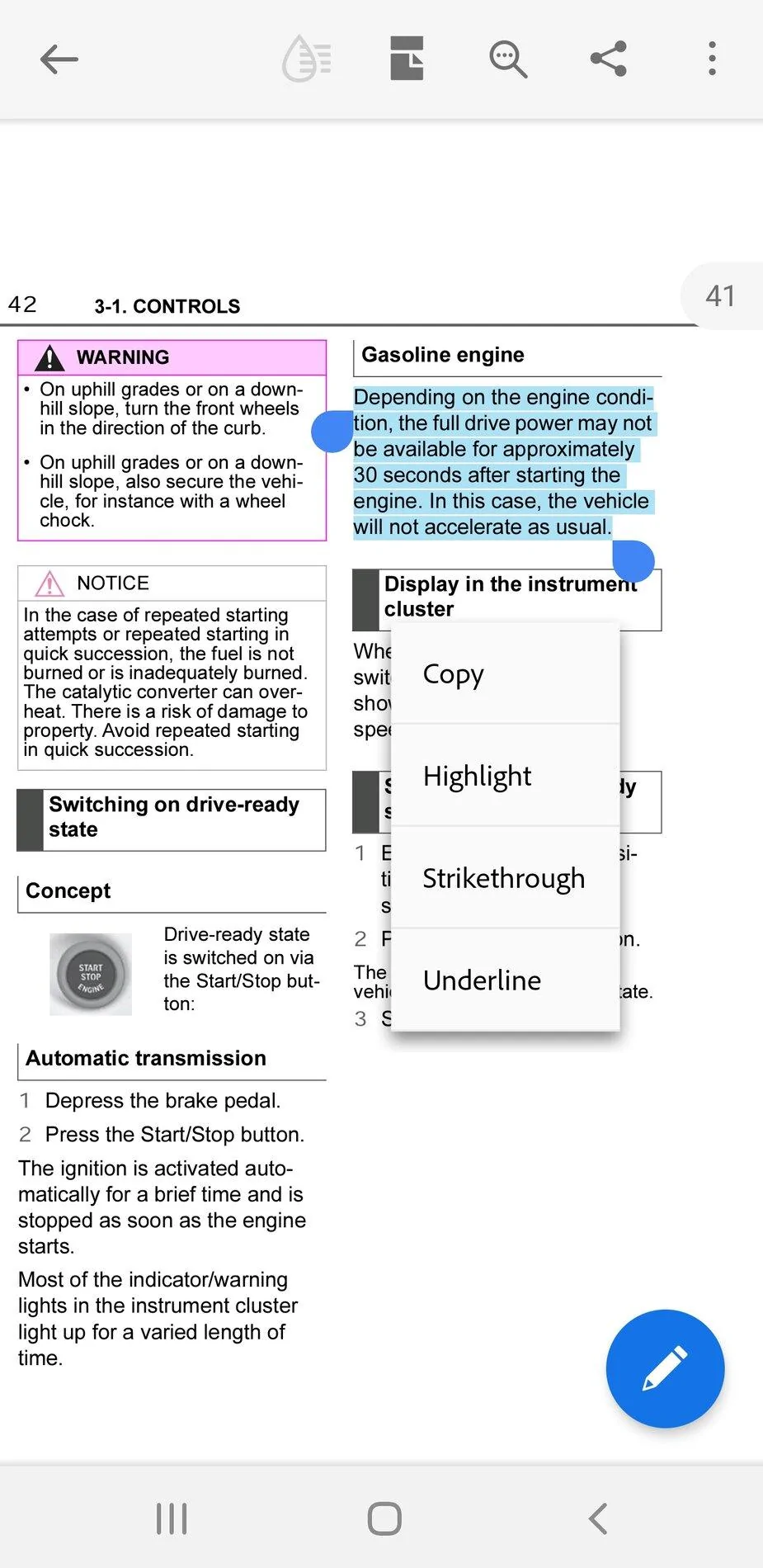

JDG520
Jeff
Dec 7, 2020
247
286
Tucson
2021 A91 Supra
How many times do people have to say, "it's NORMAL. It's a BMW feature"
Read the manual.
It’d be one thing if it was 30 secs, but if YOU read what people are saying it’s after the car was idling for several mins.
Look if it’s normal it’s normal. I’m fine w that. But the manual explanation doesn’t fit what’s happening. Nobody is starting the car and trying to redline it (at least im not lol) Starting the car letting it idle to temp and it still won’t rev? That’s not weird to you? It’s a bmw thing?
Sounds like a whole lot of assumption from everybody, I just wish we could figure out some clarification.
Read what it says, not what you want it to say. People are revving right after starting. Thread is full of it. Here's your explanation. How more clear do you need it to be?
And people shouldn't let a car idle to warm anyway, but that's a whole other topic.
Ok, read what I said where I let the car warm up much longer than 30 secs. Several mins in fact. Not able to rev. It was cold outside but the engine was not at that point.
I’m not trying to argue, trying to get clarification. Maybe draw it out in crayon for me since I’m obviously missing the point in the “may not have power for 30 secs” stipulation, when I waited much longer. Trust me I just want the car to be fine.
