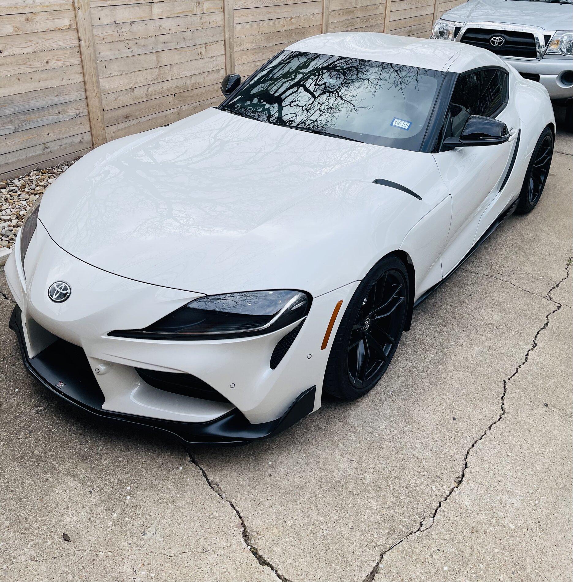

Greetings,
I am an owner of a 2.0 supra 2021 and I would like change my rims to the 3.0 ones.
Please help if I could swap and would fit great?
