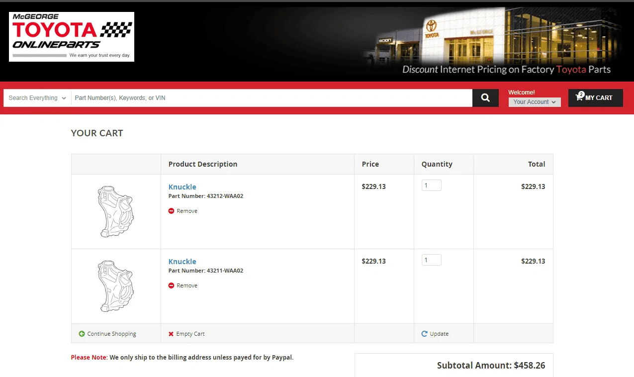

All I will say is this: If camber is what you're looking for, don't bother with new knuckles. Just buy some camber plates or coilovers. The geometry alterations will be negligible and the cost will be much more reasonable, not to mention labor to install them.
Thanks. I have other considerations for using these in particular.
30MilesOffshore
Jan 27, 2020
51
457
399
Charlotte, NC
Generally speaking they're for small adjustments in the factory range, not for actually changing the camber. I haven't seen the M2 knuckle information, but I assume they're probably similar.
For the Supra:
LH Side
Standard - 43212-WAA01 (BMW 3121 6 878 613)
-30' (-0.50°) - 43212-WAA02 (BMW 3121 6 877 201)
+30' (+0.50°) - 43212-WAA03 (BMW 3121 6 877 203)
RH Side
Standard - 43211-WAA01 (BMW 3121 6 878 614)
-30' (-0.50°) - 43211-WAA02 (BMW 3121 6 877 202)
+30' (+0.50°) - 43211-WAA03 (BMW 3121 6 877 204)
Jeff
Excellent info! This is actually what I was searching for! Thanks for posting up!

McGeorge Toyota is great for ordering parts. So is Elmore Toyota and if you want OEM parts direct from Japan if the shipping works out, Amayama.
Although with the latter you there is currently no EMS shipping option so the only reliable carriers you can request with their orders (for the current time as of this posting) are Fedex or DHL. But... sometimes the total cost with shipping from them is still the cheapest.
Usually though I’ll order my parts from McGeorge Toyota.
