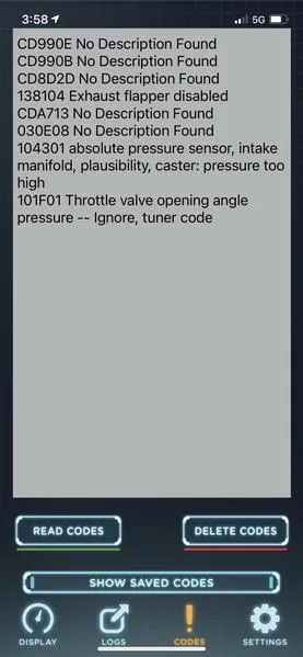

No I have a JB4. And to my knowledge, no, I don't notice any difference in power. CEL pops and I'm like "Great...", next time I stop the car, turn it off, diagnostic mode, clear CEL in JB4 app, start car, keep driving. It's a weird code too (104301).
