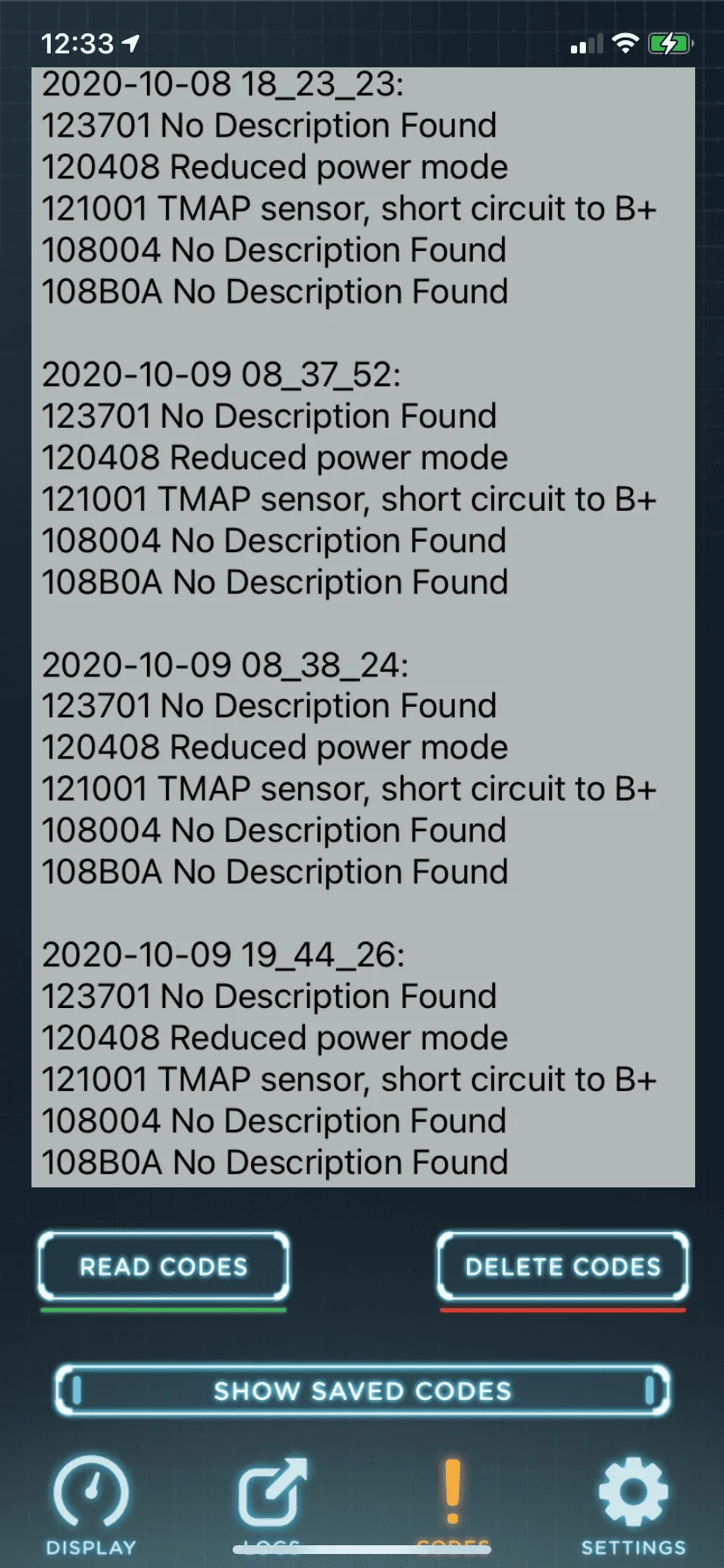

After the pull My car immediately went into semi limp mode, with pop-up message said
You can continue to drive, immediate assistance not necessary contact dealer to assist followed by wastegate line disconnected and reduced power mode In my JB4 code reader

I donā€™t think your limp mode is the same as this one, I realized that I got one of the pins mixed up when wiring my ewg cable in, once I fixed the wiring it still did not go away in which I disconnected my battery for about 10 min and I have not seen the code since then.
Yeah I don't think we have the same issue but at the end what I did was remove the wastegate and manually pressurize it to get it unstuck

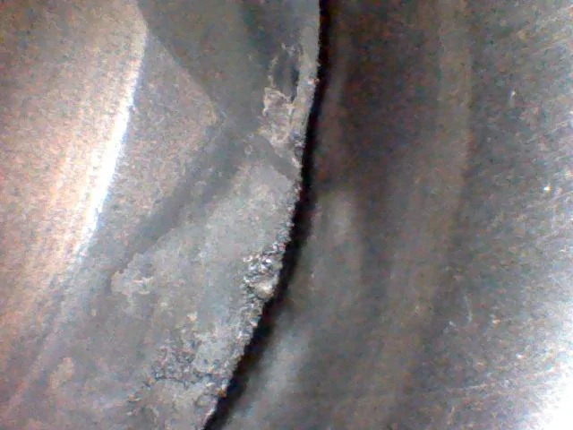

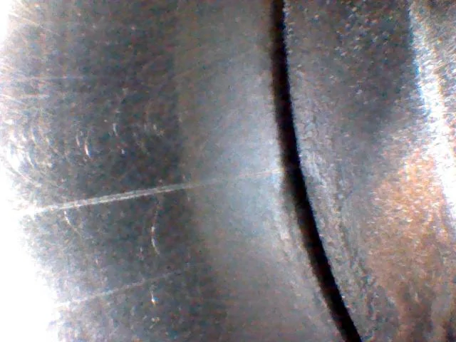

Any damage to turbo impellers from over boosting it? One guy on here fried his turbo from over boost.

2021 Toyota Supra primium 3.0
Yup my fried too
I have to get a new turbo.
Here's the things 21 is not tunable so I have to go with OEM, do you have any idea what other turbo can I use? or any member know what out there that I can used beside OEM?
