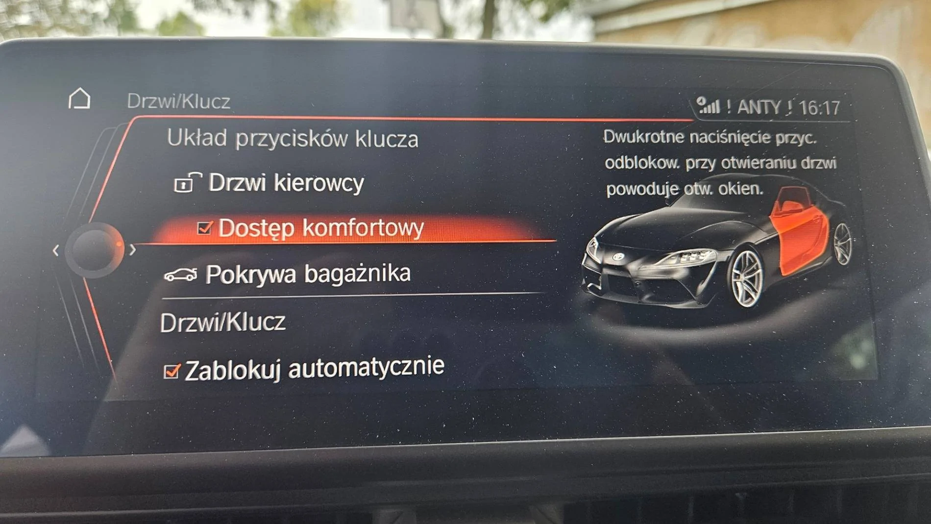

Hello, when I press unlock button 2x on the key fob, both doors get unlocked (this is OK, as desired and set in settings) but at the same time, both windows start rolling down, they stop more or less in the middle (rolling down is not desired when pressing 2x unlock button). Function "hold unlock to roll windows down" is working properly, they roll up & down when pressing & holding key fob unlock/lock buttons. Maybe something has happened during pressing the unlock/lock button that is causing this situation. Anybody has experienced it before and can help?

Are you holding down the unlock button on the second tap or just double tapping it on the fob?

I'm just double tapping it.

Isn't there a setting that a single tap will unlock both? I think that's the way mine is set up.

Yes there is, I just noticed that "comfort access" is not related to keyless access but to "rolling windows 3/4 down for more comfortable access" and this happens exactly when you press unlock button twice. Changing this in settings menu solved the problem, thank you.
