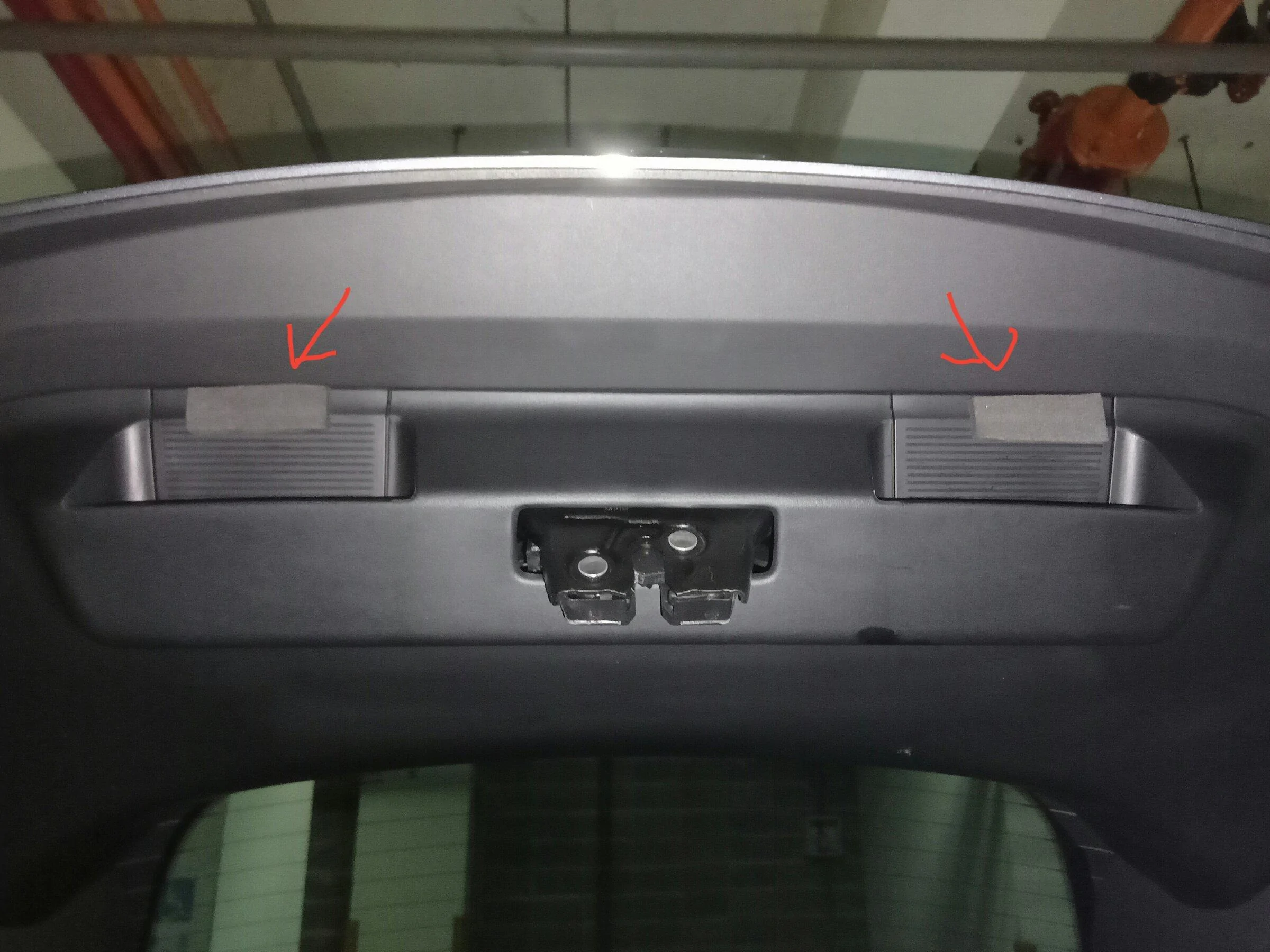

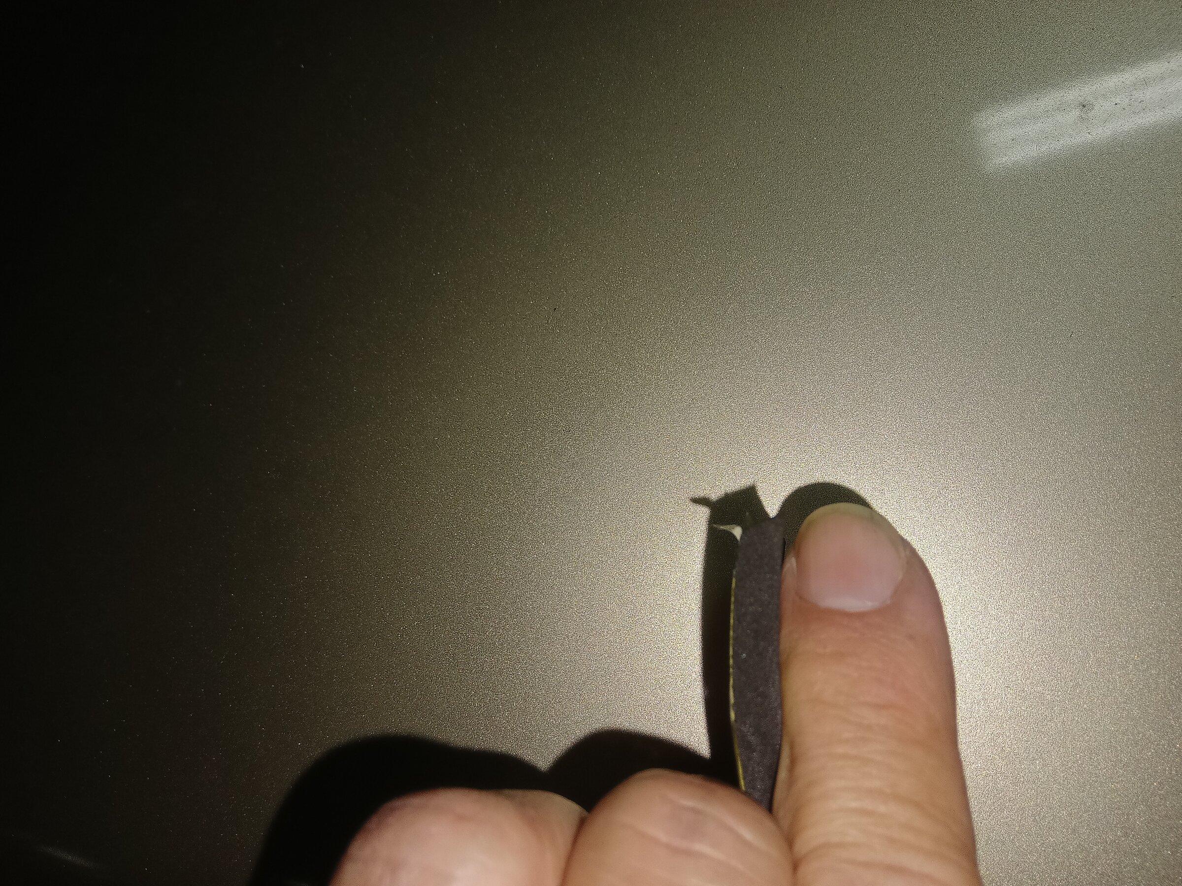

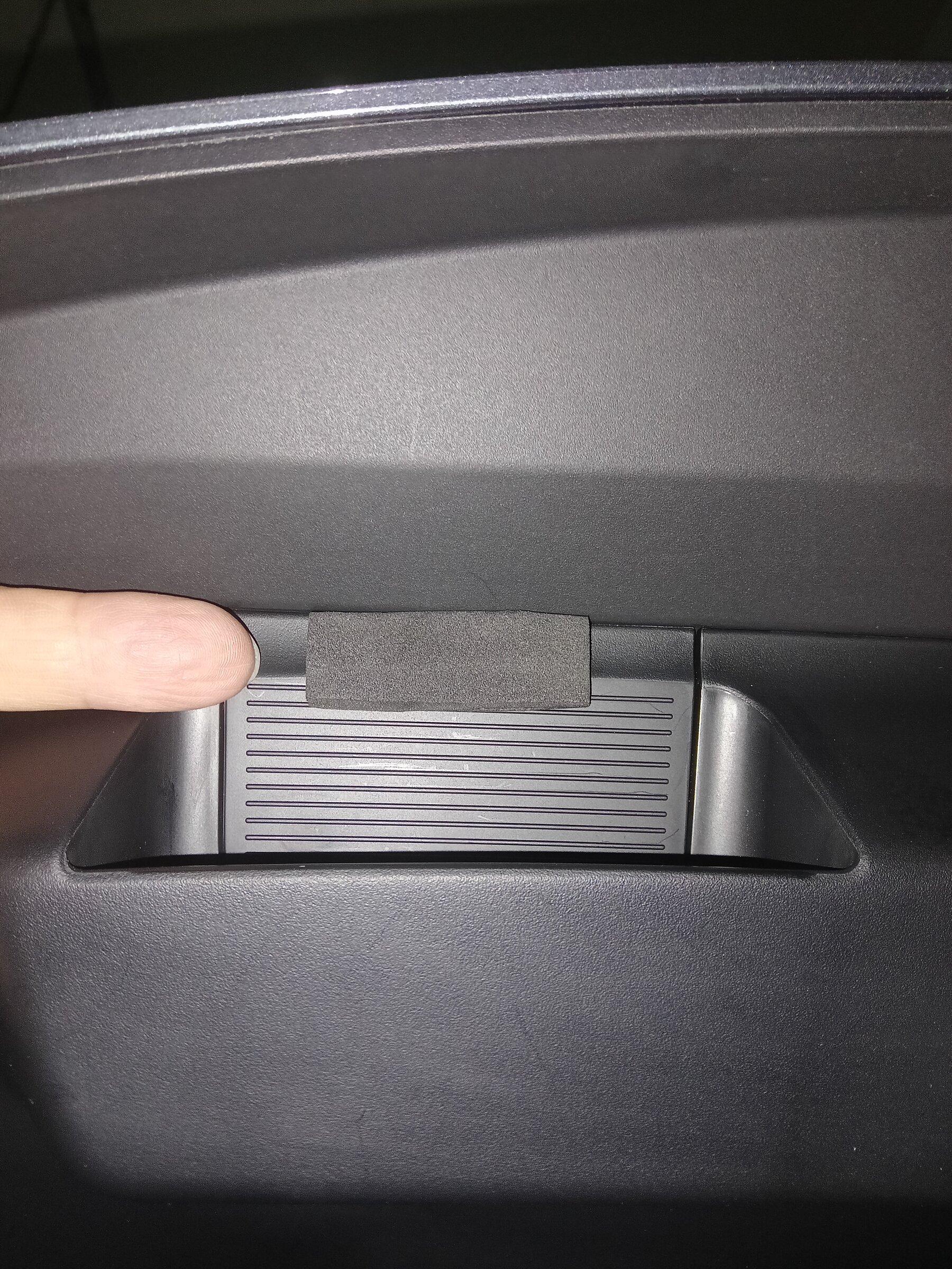

I use black spong (6~7mm)and past it here,my english is not good,sorry.

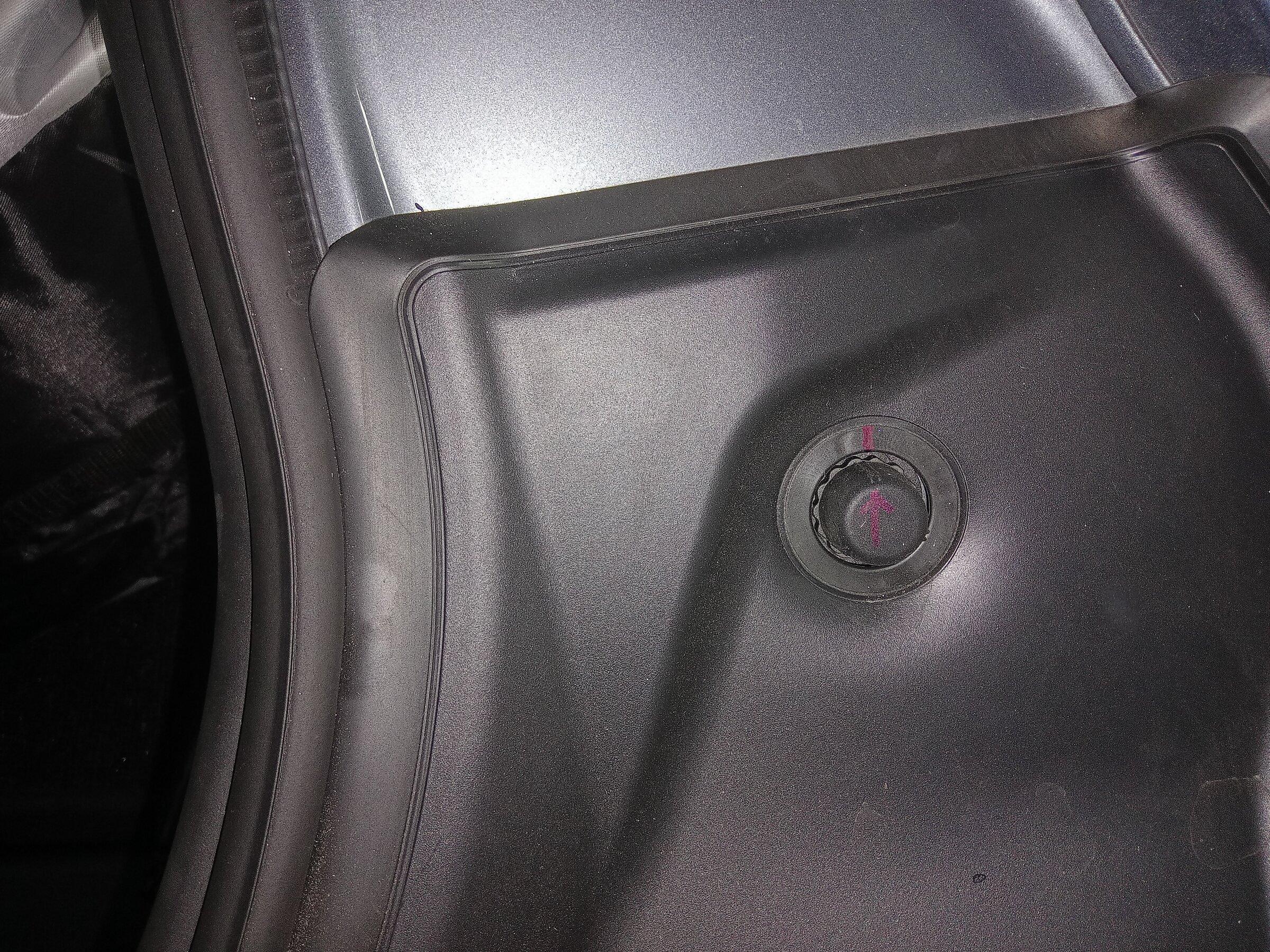

If the sponges can not solve the problem,adjusting left side & right side knobs a little more, counterclockwise.

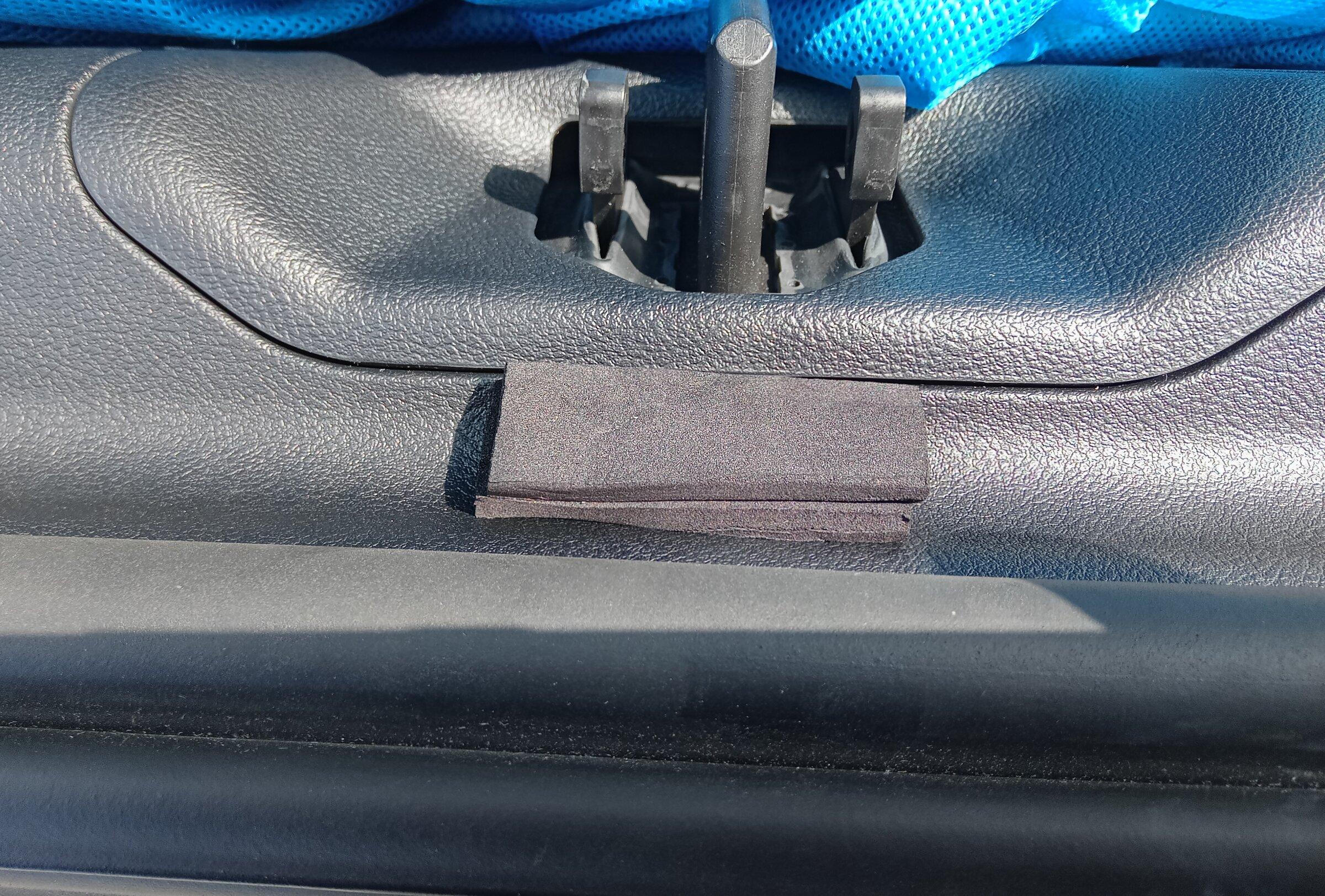

I think the 2 sponges touch here
Or try here
Anyone can share it or edit it in English. Thanks.
Sponges worked for one evening, then got compressed...
