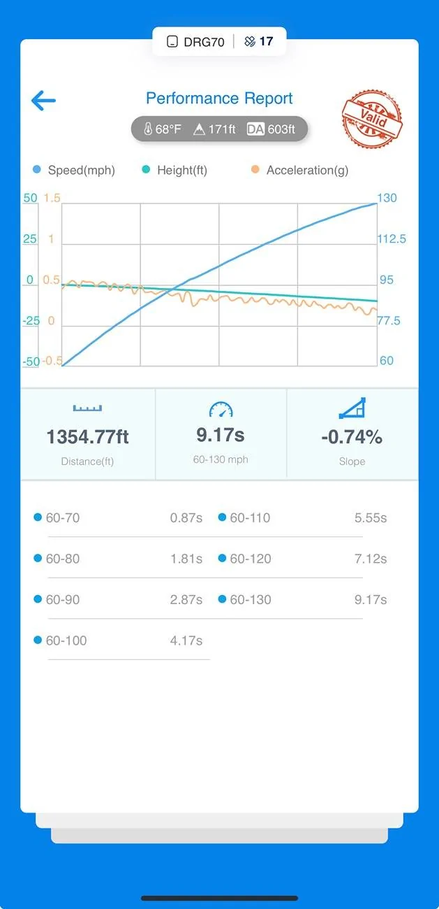

It feels great, there's some lag but it's nothing that brake boosting or anti lag can't fix. It's stock motor, only at about 29 psi for now as we're still getting this map dialed in. Next map will be 36psi. I haven't done any dragy yet because the maps aren't finished, and I'm at 7500 DA so the times are gonna be trash regardless lol

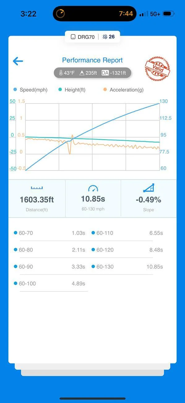

Slowly itching towards the 5’s in this insane Florida heat, felt like it pulled power on the shift, does anyone know why it does that? It builds immediately and then goes down then back up and continues the run, i seen another big turbo manual do that too. Tuner wants me to get a log tonight for him of me shifting see if there’s anything he can do. (this is a 5.4 100-200kmh)

Are you running PI or just upgraded DI? What e mix?

are you using NLS? post a shifting log

Yeah this is NLS,i don’t have a shifting log but i will soon. car must’ve popped the chargepipe yesterday it’s parked right now till i get time to fix it

If its losing too much boost mid shift you can have your tuner raise the "wgdc during blow off" table

Just sent an email to my tuner about this, see if i can improve boost recovery in the 2nd > 3rd shift as that is what's currently killing me at roll racing since the format is 50kmph / 30mph rolling start.
Experimented with NLS for 2nd > 3rd and because of the load, it just becomes so hard to muscle the shifter into 3rd so lift shifting for now and NLS for 3rd > 4th, but still seems like slight bog once i do the 2nd > 3rd shift.
