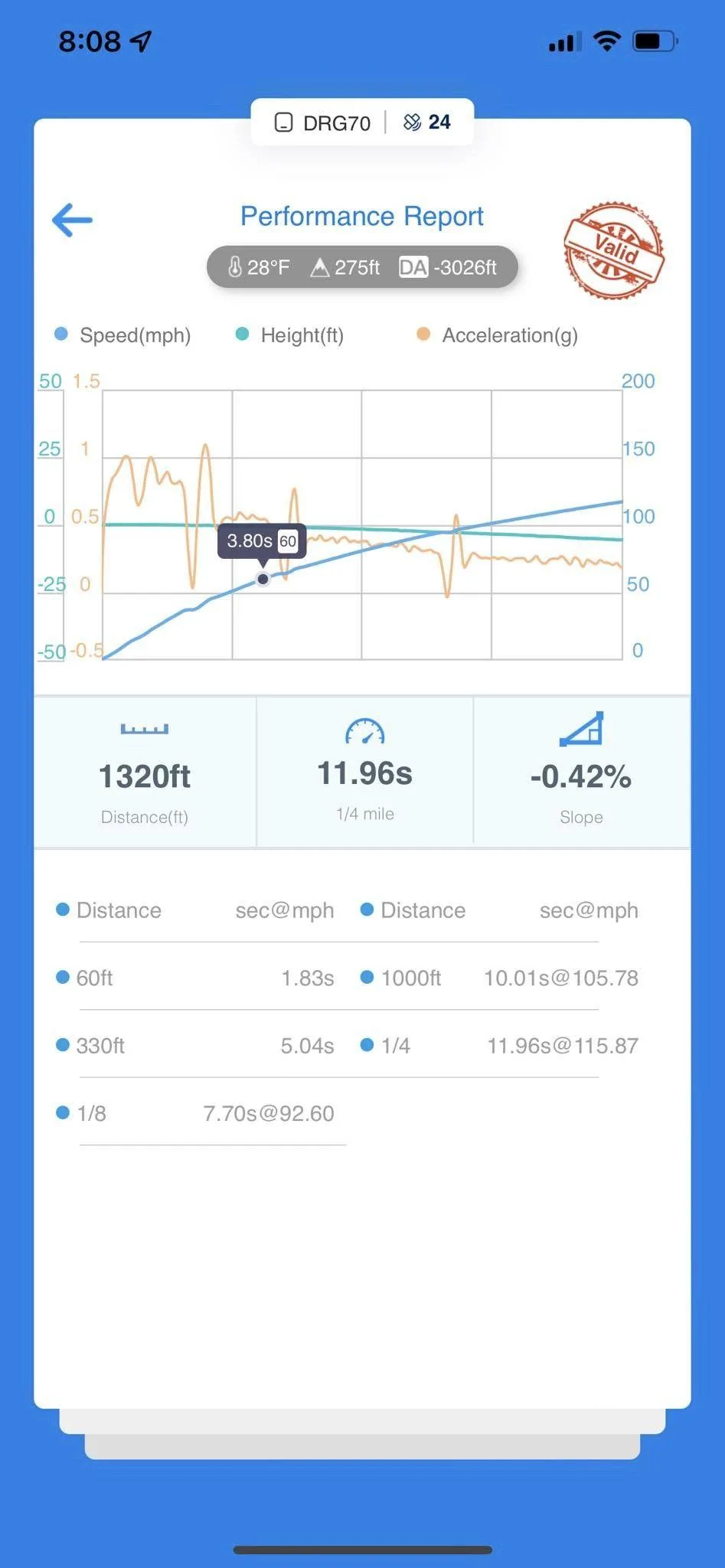

Nice job, what rpm are you shifting at? Looks like the car is loving the cold air.
Is there a way to overlay the rpm on the dragy graph?
Also what settings for traction control?
I'll get a dragy at some point and see what I can get out of the car.
Keep us posted on your build and results!
Looking to see if anyone on here with a Manual supra has drag raced it and if so what kind of times you have gotten? Here is my best so far. Tire only on the street

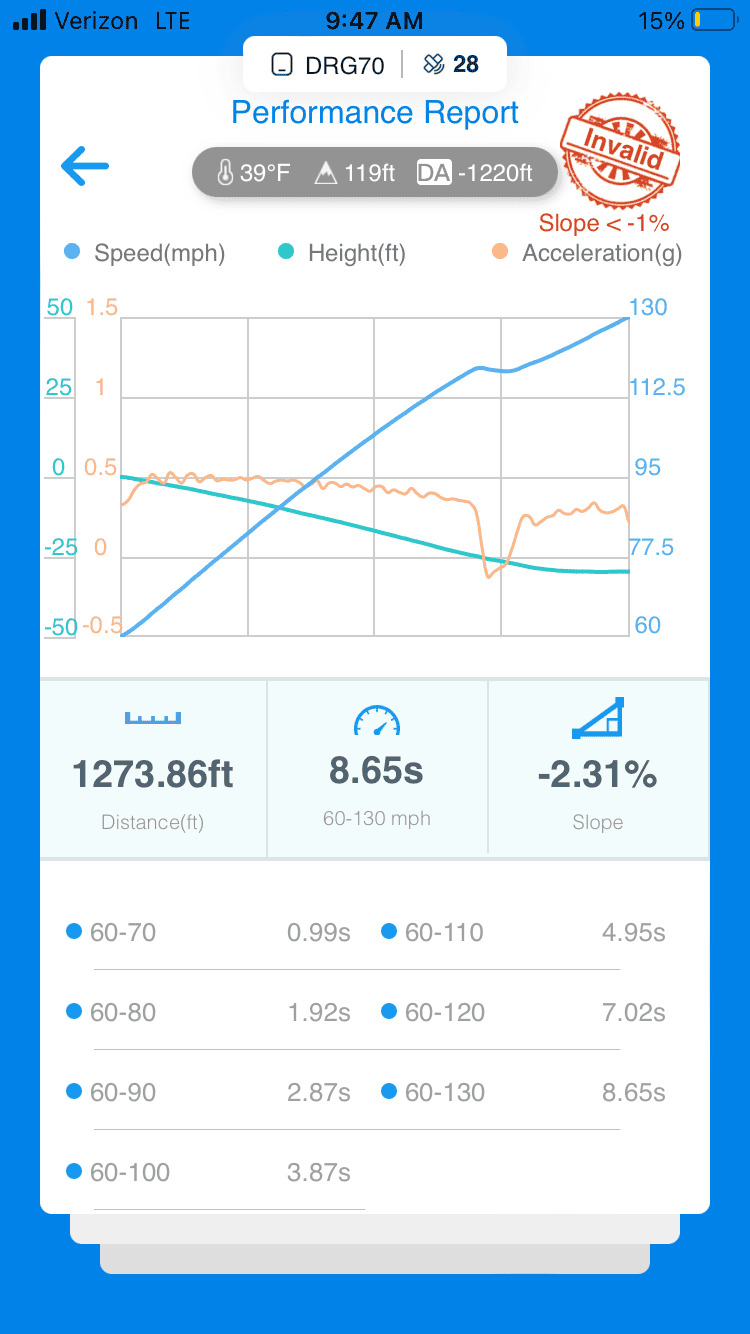

I'll find out in May, going to test the stock clutch running the Remnant turbo on 94 octane. will likely be making the numbers above.
I won't be launching the car or doing burnouts, do you think a 275/35/19 A052 would hook from a roll?
I ran a 295 NTO5 on my F80 M3 with around 600hp and it hooked a 60mph roll in 40 degree temps
my build https://www.supramkv.com/threads/cf...aper-and-many-many-many-picture-thread.18802/
Cold air didnt really help me much honestly i went 12.0 in 60 degree weather and in 20 degree weather all between 115 and 116mph. Cut a 1.85 60ft in 60 degrees and a 1.83 at 20 degrees ...
I have tried 5500, 6000, 6300, 7000 and my conclusion is the best mph passes were between 6000-6300.
No way to overlap but all of these shifts were in that 6-6300 range
Traction control completely off
