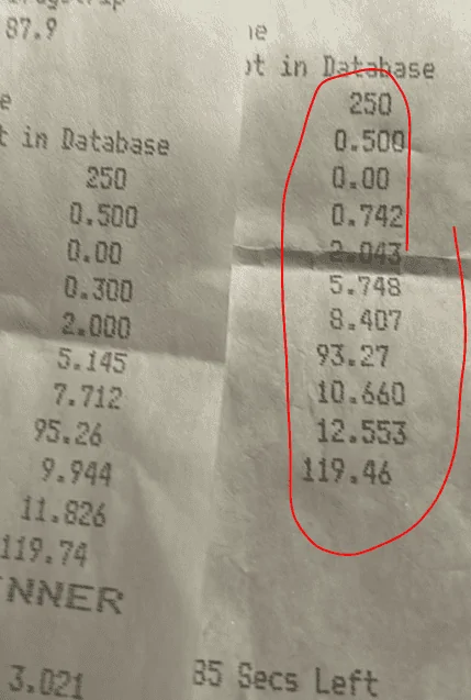

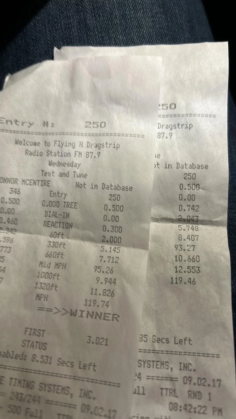

Dyno numbers are dyno numbers do you have an overlay to see gains besides peak numbers?
119 mph is pretty low and comparable to stock times (116-119 are pretty common for stock).
Did you see if your jb4 went into safety for some reason that would explain almost everything.

Car is a 3.0, stock dyno at ~350whp, +9psi additive JB4 (24-25psi with perfect timing) on meth dyno'd at 466whp. So easily >100whp gains over stock. Shitty dyno. Go figure.
No idea where time is being lost in the 1/4
Yeah. He did mention bad DA and 60ft iirc.
Should be low 11s for sure.

Considering it was my first and second pass ever 1/4 mile. Im told the 0-60 should be closer to 1.5-1.7 so there is three easy tenths. 11.5 ish

Something is definitely WAY offff. Did you run any logs from the track?

No power issue just new 1/4 mile driver.
I will get there. First pass was trash I spun and had too much pressure in tires.

Logs only tell one side of the story. Sometimes you have to put performance metrics to things to see if you are hurting or helping with more boost.
Did you guys do any 60-130 times?

Diver effects ET not MPH your MPH is oddly low. You have a draggy? IF so go run a 60-130 time that doesnt matter if your a great driver or a novice lol.

Just seen you edited with the log. If you look at safeties it shows a recent safety kick down fyi.
Was running too much E a few weeks back, so that likely triggered it. Trims have been under control since running <E20
@Got_M , I don't remember ever hitting a safety and going to Map 0, do you?

No its not a fuel issue it a "1" so that's a boost over safety issue.

If you just use Datazap to review logs you wont be able to see safety issues just an FYI.
Oh my bad, I definitely remember hitting that safety now ?
Boost safety was set at 26, woops. We kicked it up after that run.
I pull up the log in Excel to verify settings, safeties, etc

Ya if you didnt change anything at the track thats likely what still happened. Which would explain the stock times and mph lol.
