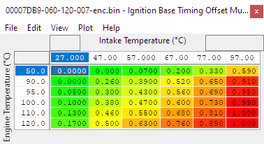

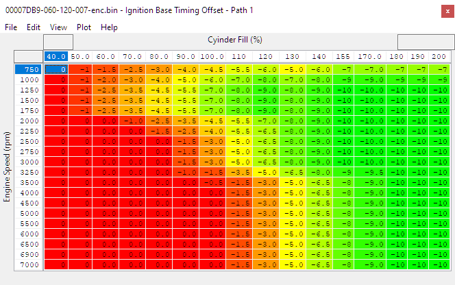

What else makes power besides boost and timing then? Provided timing (IAT and ecu_psi "cylinder fill") stays constant as the boost increases, i see no reason for a power drop.
Obviously at a certain boost level, IATs climb more quickly and drop base timing. I am pretty well read on how B58 logic works and have read several ecutek, bm3, mhd guides. I understand the common lookup tables.
i don't know how to use tunerpro or actually tune by any means, but know enough to know how the DME interacts with JB4.
I am just assuming your advice is to get IATs down.
