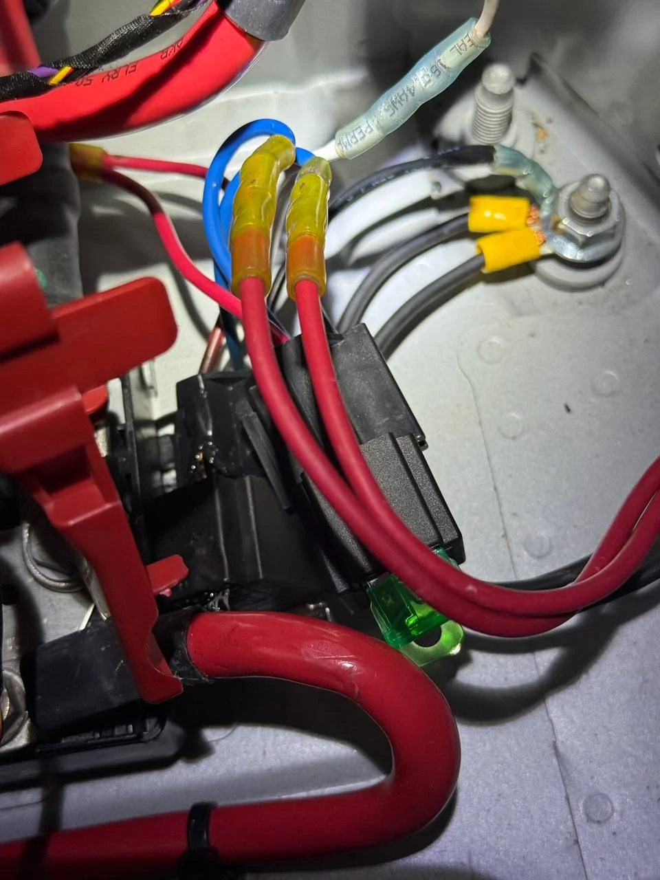

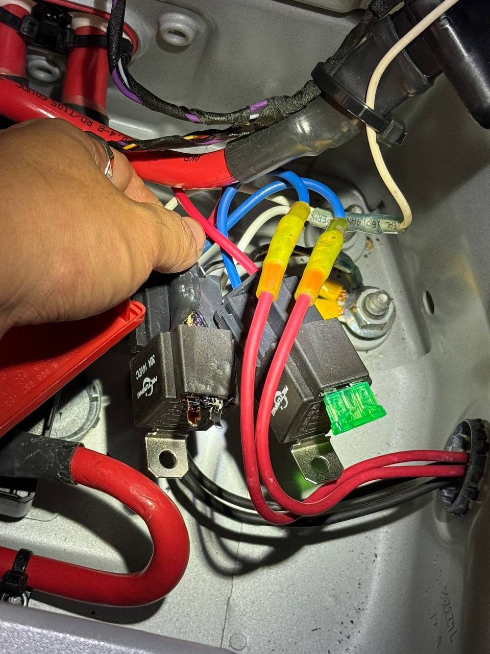

Hey, sorry for seeming vague, that wasn't my intention. I'm not well-versed in BMW wordin', so forgive me if this seems even more confusing lol. Included some photos from late September that I got from the dude who worked on my car.
I took it to a local shop, where I met the owner/lead mechanic who specializes in BMW repairs and aftermarket parts installation. He works a lot with s58s and g8x's I'm just one of his handful of supra owners who works with.
To explain everything, the reason my original fuel pumps failed was poor wiring by whoever had previously worked on the car. Simply put, whoever wired this car for the previous owner didn't do an excellent job. They wired two relays from the battery to both the fuel pumps and the Motiv Reflex harness. When it melted randomly (unsure what even caused it to melt), it took out my old fuel pump, my motiv Reflex harness, and, surprisingly, my CAN input sensor with its harness as well. I didn't find out about those other harnesses till a week down the line due to my being busy with my job.
The mechanic who worked on my fuel pumps, I personally asked him to do a wiring inspection and rewire anything that needed to fixed, which then later turned into doing a full wiring check (I called this a rewire when I shouldn't have) to make sure everything was operational and to make sure that the previous dude who worked on the car with the old owner in Hawaii didn't fuck up anything else. At the time, I learned that the original harness for the Motiv was dead (a PTCan kit from Visconti found in the passenger footwell), as was the can input sensor. Got the motiv harness replaced with one from TMS, and the other harness was swapped as well. My tuner also confirmed that he has a good signal from the can input sensor, so I have confirmation that it's working as well. Also found out a couple of days later, after I went to pick up the car, that the motiv reflex box might've been fried as well, but I got that taken care of and have a replacement for it now.
Hope that clarified. The guy who works on my car is a saint. who's offered me multiple good deals on the installs and repairs I've needed for the car.

So the main issue was my fuel pressure regulator: the diaphragm went bad, allowing fuel to enter the intake manifold, and it repeatedly flooded the engine. But that's not the only issue. My meth kit was set to a constant on by whoever modded the car with the old owner through the shabby wiring, just removed it entirely, but it is still operational, I think.
